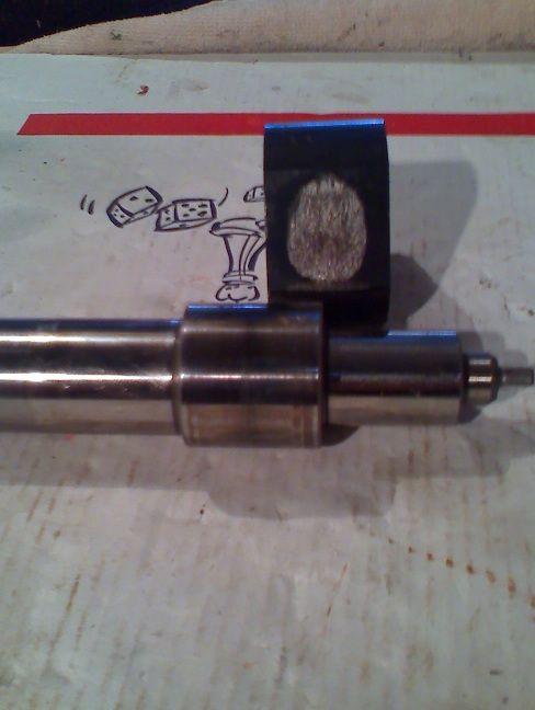

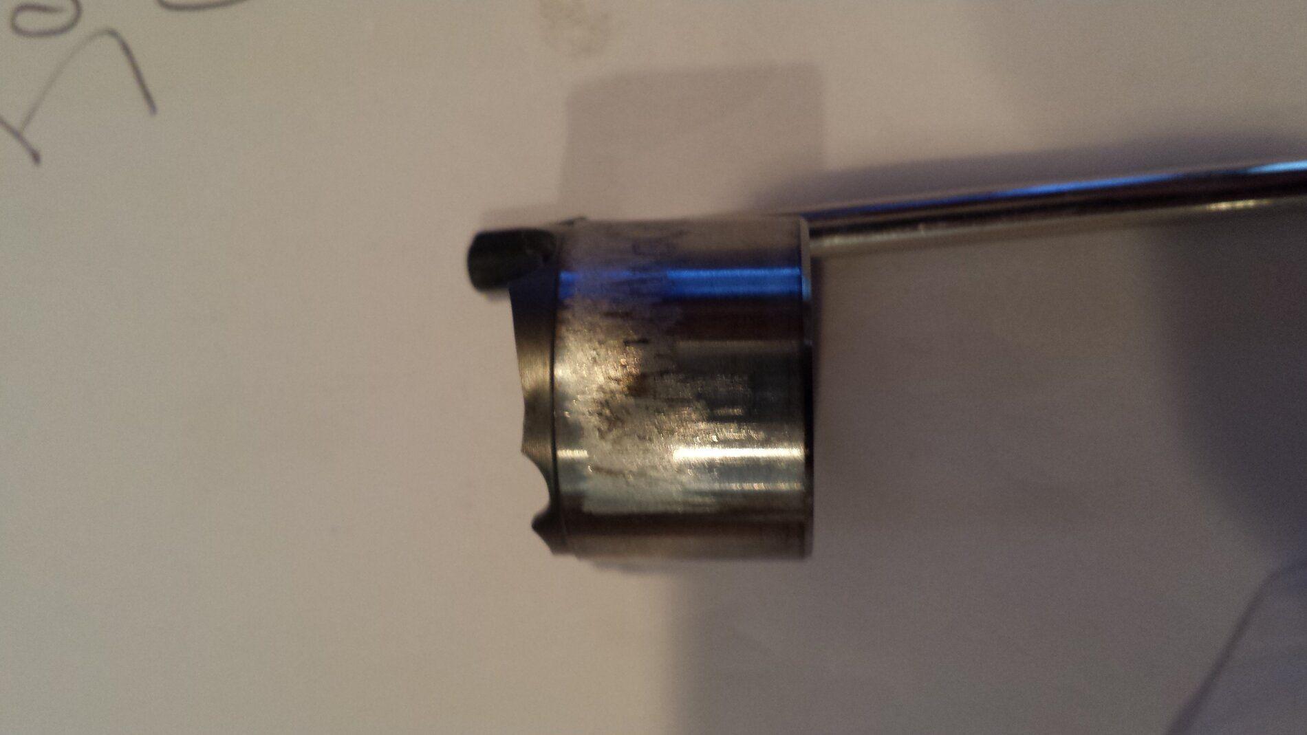

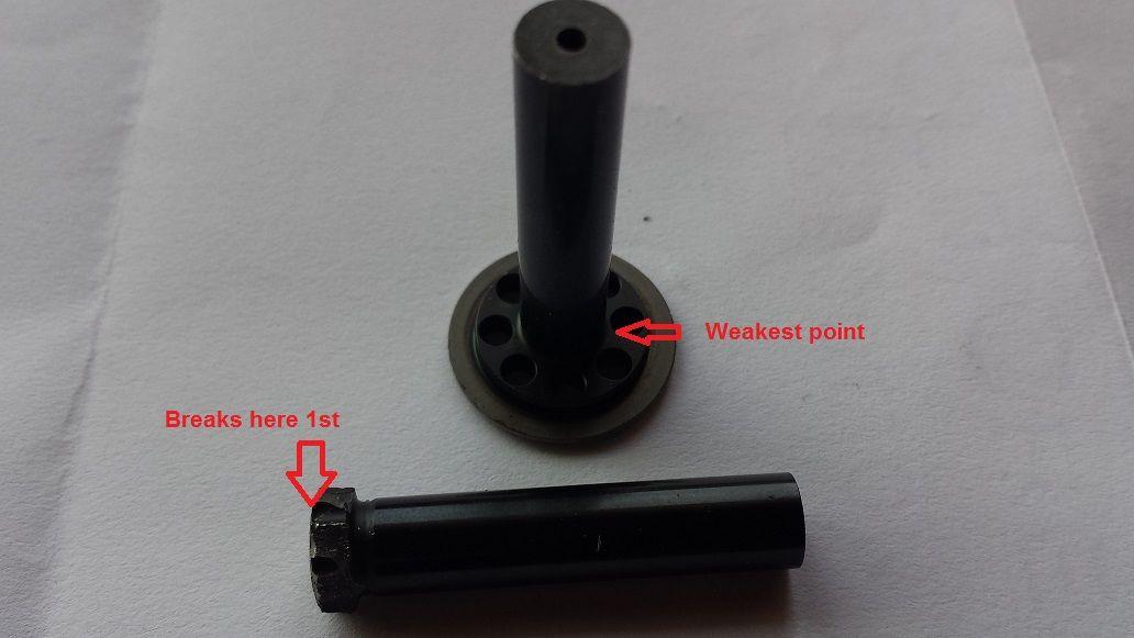

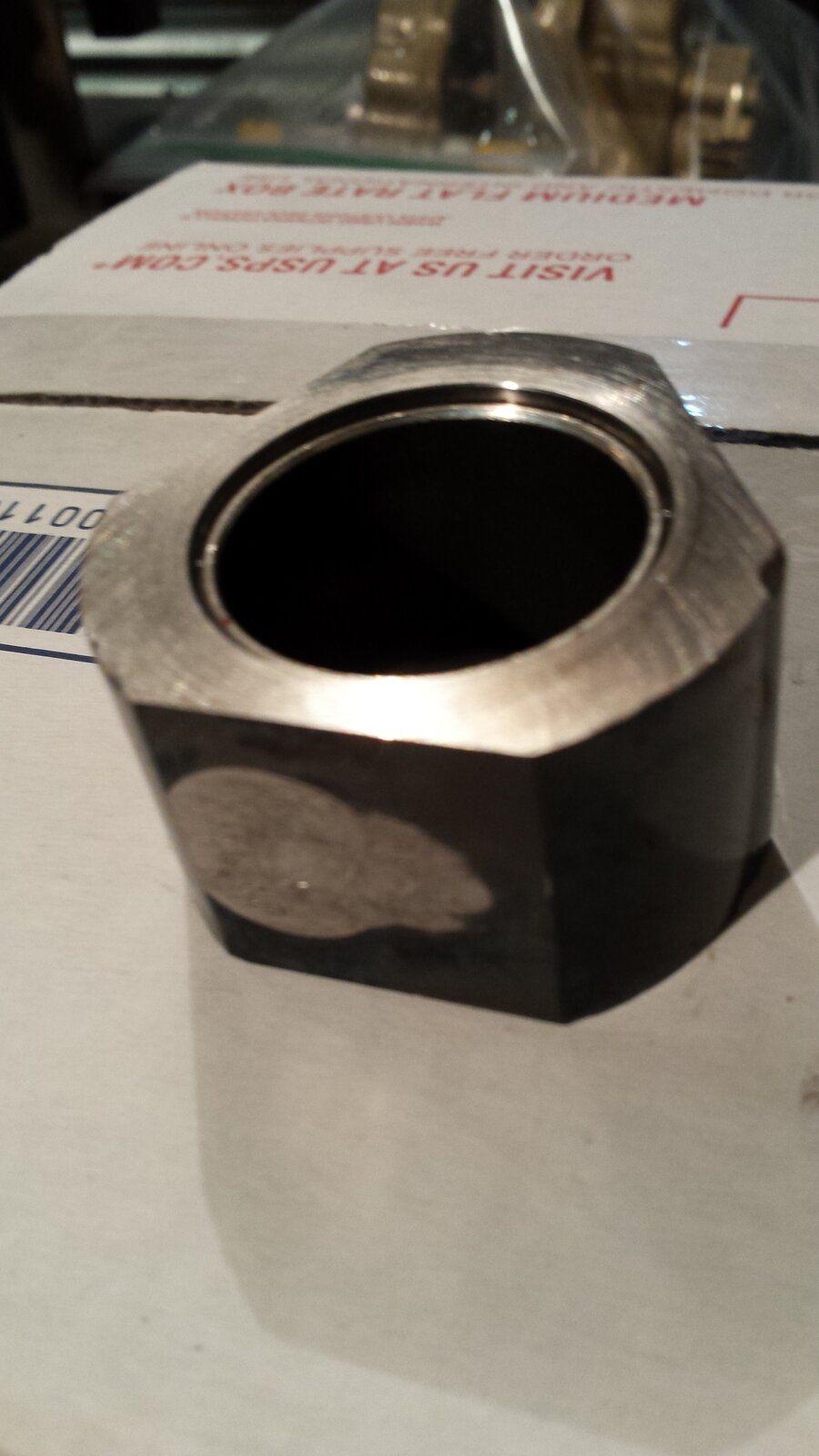

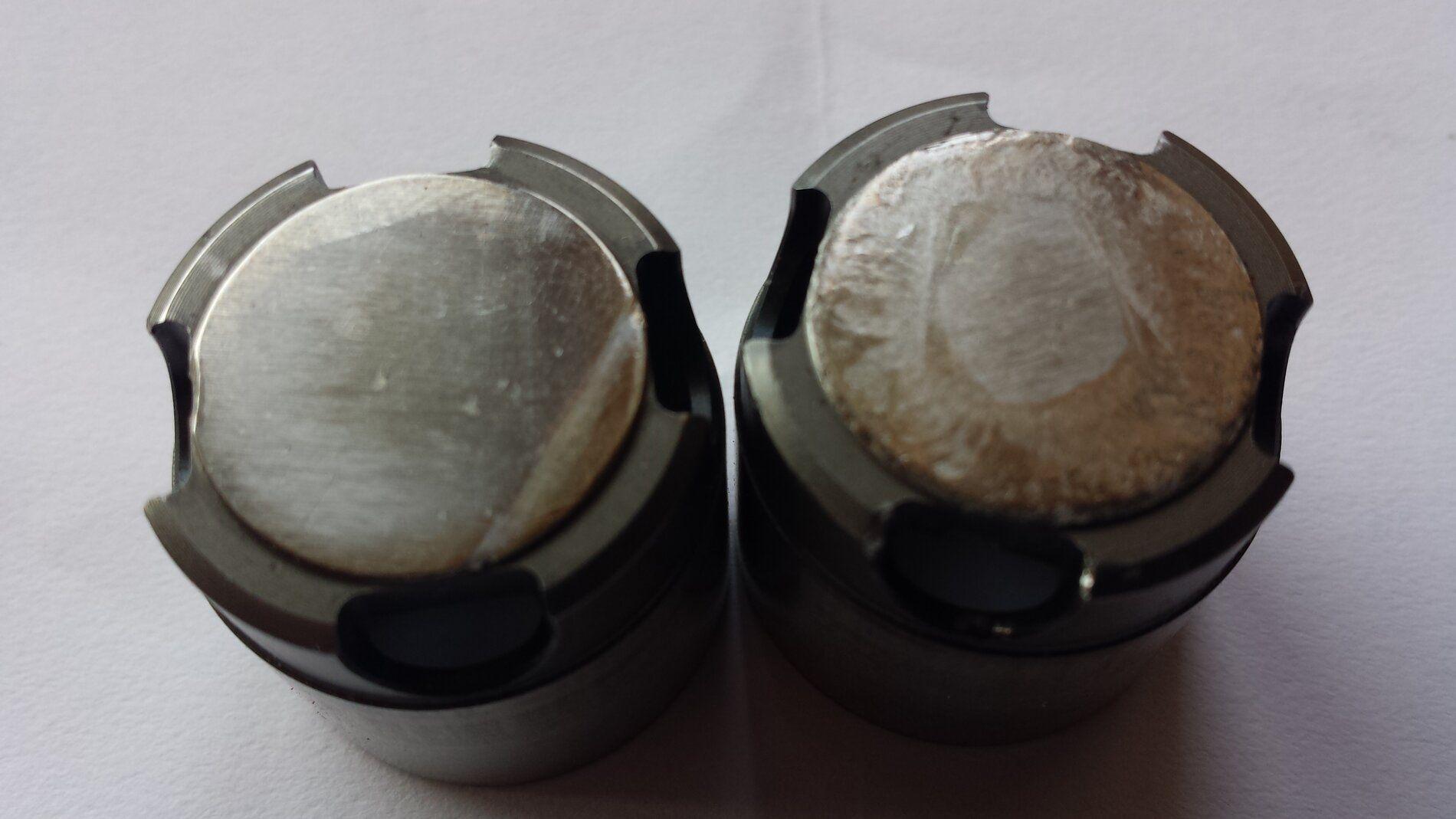

The only way any Ram CP3 is goona send debris to injectors is if the suction valve self Destructs. and even at that its Kills the Hole (No fuel to deliver for combustion) The Fuel simply enters the Inlet it travels to the GP, the GP than Raises the Fuel pressure to whatever the COV is set at, the majority goes to the Internals then returns to the tank. CP3s do not last long when the Internal miss-behave, The Cam beets the Lifters and then the outer diameter of the pistons fails and the lifter shatter and the self destruct begins and ends the WHOLE matter last 3-5 Seconds..
The Likelihood of Debris traveling its way to Injectors from the Pump Destruction extremely Rare, More like the Ram just covering it, or the Debris is from other source(s)
