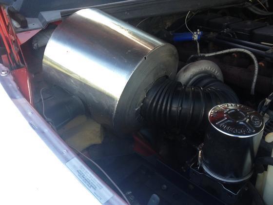

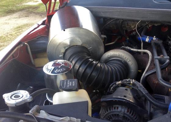

Vaughn, here's a link to my housing post from 2002 after finding the BHAF in July 2001, https://www.turbodieselregister.com...ainless-steel-housingprototype&highlight=BHAF

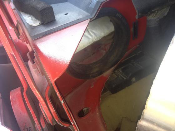

A couple current pictures below. I ran the housing for a long time tied in the a fresh air hole in the firewall ala Scotty, but eventually did away with all that. I did keep the fresh air hole open (shown in the attachment) I suspect a nice shot of cool air still has to make it too the turbo.
