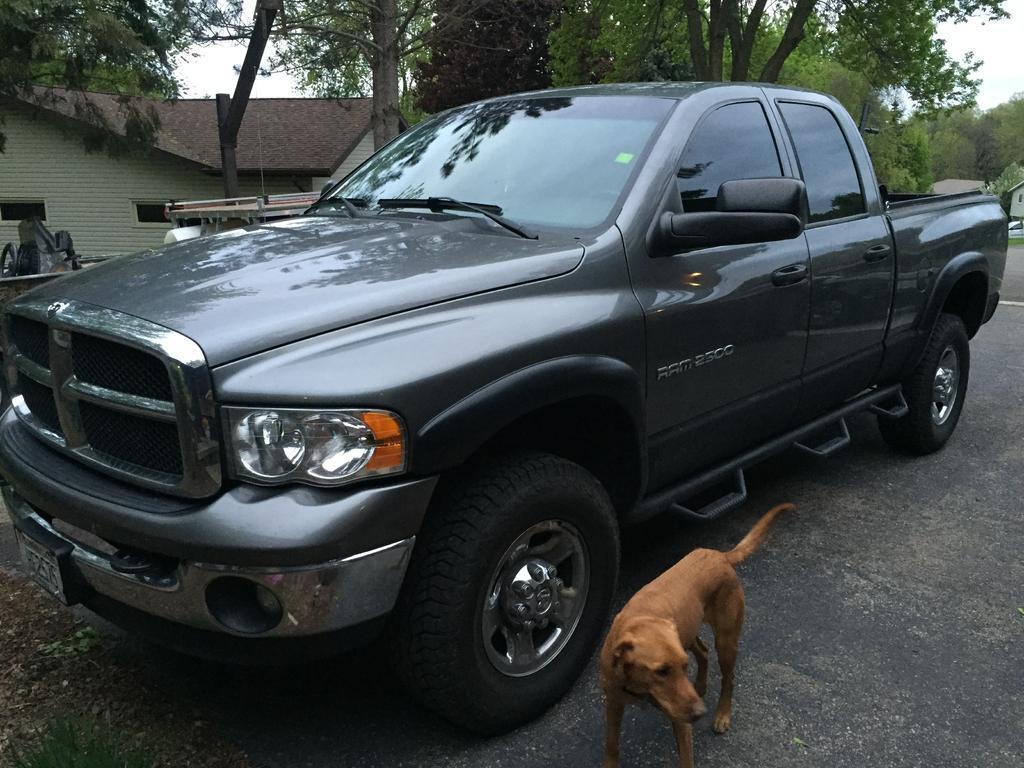

Truck with my copilot, Ruby

BTW nice truck Joel. That is the color I wanted but couldn't find one with the right options. Are those power wagon fender flares?
Thanks for the compliment. Yes, they are Power Wagon fender flares. I love the black on gray color scheme. I think I'm going to remove the lift blocks under the rear springs to level it out and have the tires fill out the wheel well a little more as well.
