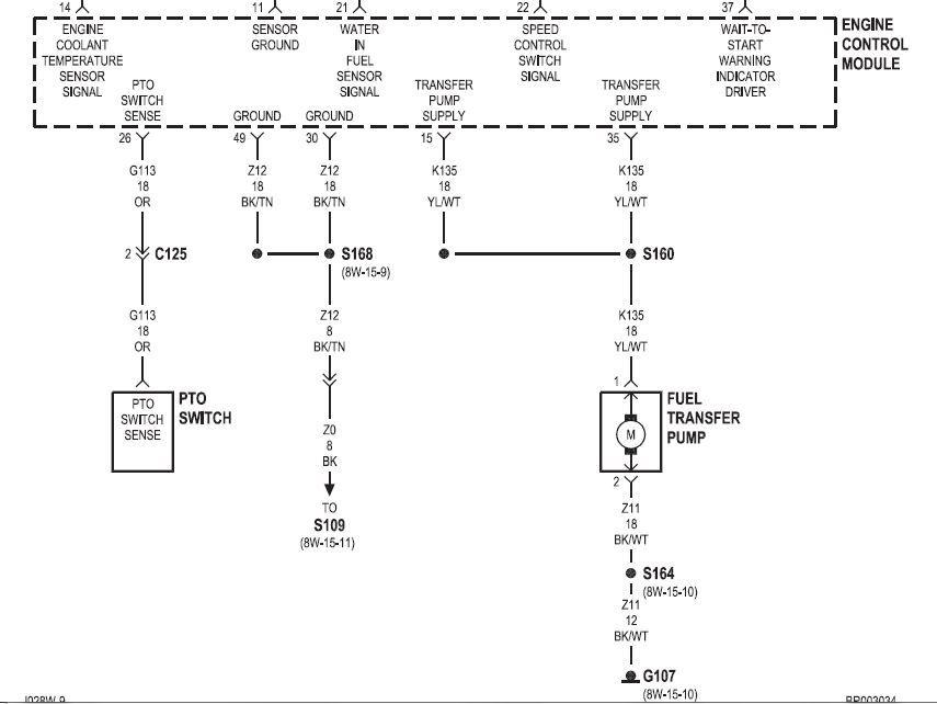

This wiring diagram is for a 2002, but I think it is the same for yours. Note the 18 gauge yellow wire with a white tracer that connects to the fuel transfer pump. This wire supplies 12 volts from the ECM - for approximately 1 second when the ignition key is switched on, and for approximately 20 seconds when the ignition key is switched to crank (bumping the starter).
- John
