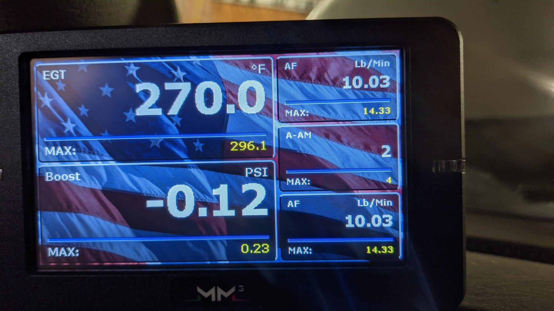

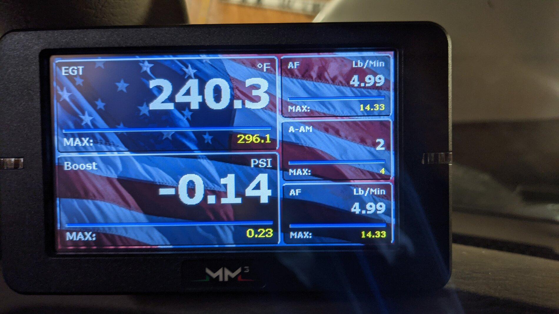

Well this has been an ordeal. Got my rebuilt turbo back and installed it. Pre-charged it with 2 oz of new oil while spinning the compressor blade. Truck isn't producing any boost. And when I step on the accelerator, not hard, but give it a goose. I hear a sound like a fwaackk. not really loud and its only momentary like a second or too. The sound doesn't occur under a constantly increasing light throttle all the way up to 2000 RPM. I cant really locate the sound from the inside of the cab. Is there someway to goose the throttle while under the hood? I've also ordered a aitflow tester so i can test the air intake system for leaks. should arrive in a few days. I also installed a new 2 piece BD exhaust manifold at the same time. Truck at idle definitely sounds different. I mean how hard can this be the turbo was turning when i pre-lubed it.
They did install a new waste gate actuator, kept the original solenoid. Could the waste gate be stuck open? Doesn't explain that noise I'm hearing might explain the zero boost?
Anyone have any ideas?
I've attached a couple of pics of my tuner with some readouts
1500 RPM

Idle
Thanks Scott. I was doing just that. Took the vehicle out for a trip around the block and it became immediately apparent that the noise I heard when tapping the accelerator was an exhaust leak. I was able to generate 30 PSI of boost as well. I suspect the leak may bge the vclamp from the turbo down spout to the exhaust system. I had a bear of a time getting those 2 pieces to line up. Had to push on the exhaust pipe from the back of the truck to close the gap. I've followed BDs instructions on the new manifold to idle for 15 and re-toque. I'll re-torque again here as soon as she cools a bit.
