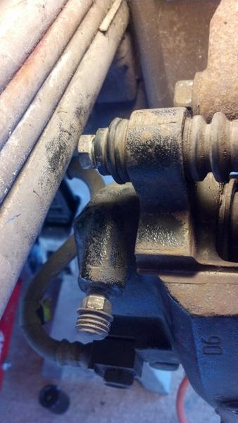

My first brake job on the dually--I am trying to remove the top caliper mounting bolt but it eventually hits the leaf springs. How do I get the caliper off? do I have to loosen the ubolt on the axle?

Somebody has removed the spacers that are supposed to be under the leaf pack. I suspect your only avenue is to loosen the axle U bolts and lower the axle away from the springs.
Check out this video at 1.21 minutes: http://www.youtube.com/watch?v=2PCPJ_6afI4
Thanks for the info. I got the bolt out and the caliper loose.
