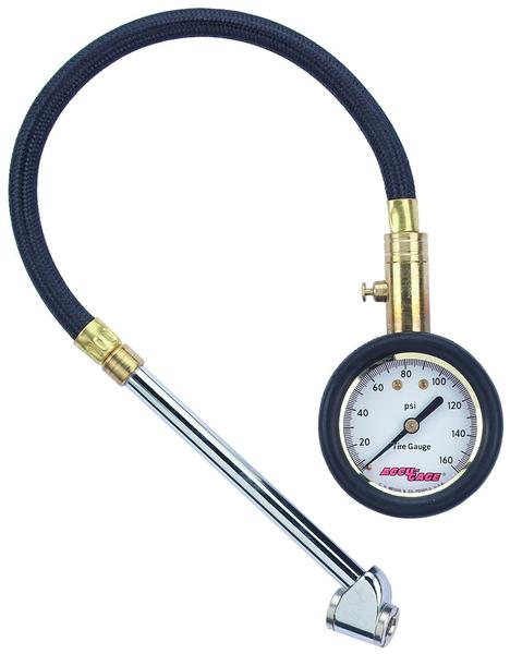

I use this type of gauge on my DRW.
#ad
All my gauges are angled.
I use THIS angle-head gauge I bought on Amazon and don't have any problem checking the inner dual tires with it. The rubber valve stem just shifts over a little to accommodate the angled-head and it works fine.
