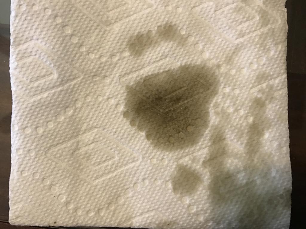

Researched on TDR causes and came across post on stuck injector. Need to troubleshoot. Here's some photos:
Here's a towel with dipstick oil. Was told if diesel oil appears dark in middle, fuel is present. Appears so.

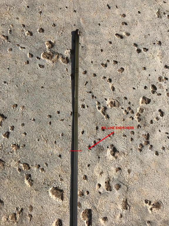

And here is dipstick showing oil over max. At least a quart.

Probably either injector o rings or a sticky injector. What brand injectors and how many miles?
What year is your truck? Early years of the VP trucks are recommended to replace the crossover tubes when the injectors are replaced. That is one possible source of the leak regardless of wether they were replaced (crossover tube to injector connection) , a leaky injector o ring, or a stuck injector. If you got genuine Bosch RV injectors it is possible but unlikely you have one sticking at such low mileage. I would start by popping the valve cover and looking for any fuel pooled up in the oil around each injector immediately after the truck is shut off. If you don't see anything you'll need to start pulling the injectors out one by one and inspecting the crossover tube sealing surface for any nicks or damage. Same for the injector o ring. If you still don't see anything that stands out the injectors will need pop tested. The quickest route would be to find a local shop that could do them for you but if you don't have anything close you may have to send them out.
Before you start I would get a seal kit like this
that way if you find something suspect you can put it right back together without waiting for parts. You'll need them anyhow.
