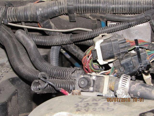

Hello the 1693 is DTC detected in ECU or PCM no big deal. 1689 is no communication between ECM and injection pump. could be loose connection or bad ground. 0380 is intake heater control circuit 1 possible wire. check the little wire to the relay they work loose. 0215 injection pump timing failure. Since the ECM and injection pump can't communicate the pump can't stay in time. fix the communication promblem and the 0215 should clear up. When I got the 0215 code this is the connection that was loose. the white bale has to be as in the picture.
