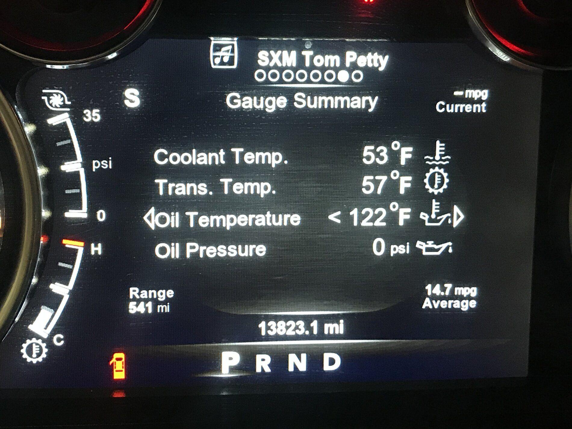

100* is the minimum the EVIC will display. I find this to be very strange as my ScanGauge will read actual coolant temp.
One more thing I’ve noticed is when I cold crank it (like this morning) my coolant temp says 100 degrees. It was 46 degrees when I cranked the truck. The coolant should’ve been 46 degrees.
On my truck the coolant temp never goes below 100 degrees Fahrenheit no matter how cold it is outside.
