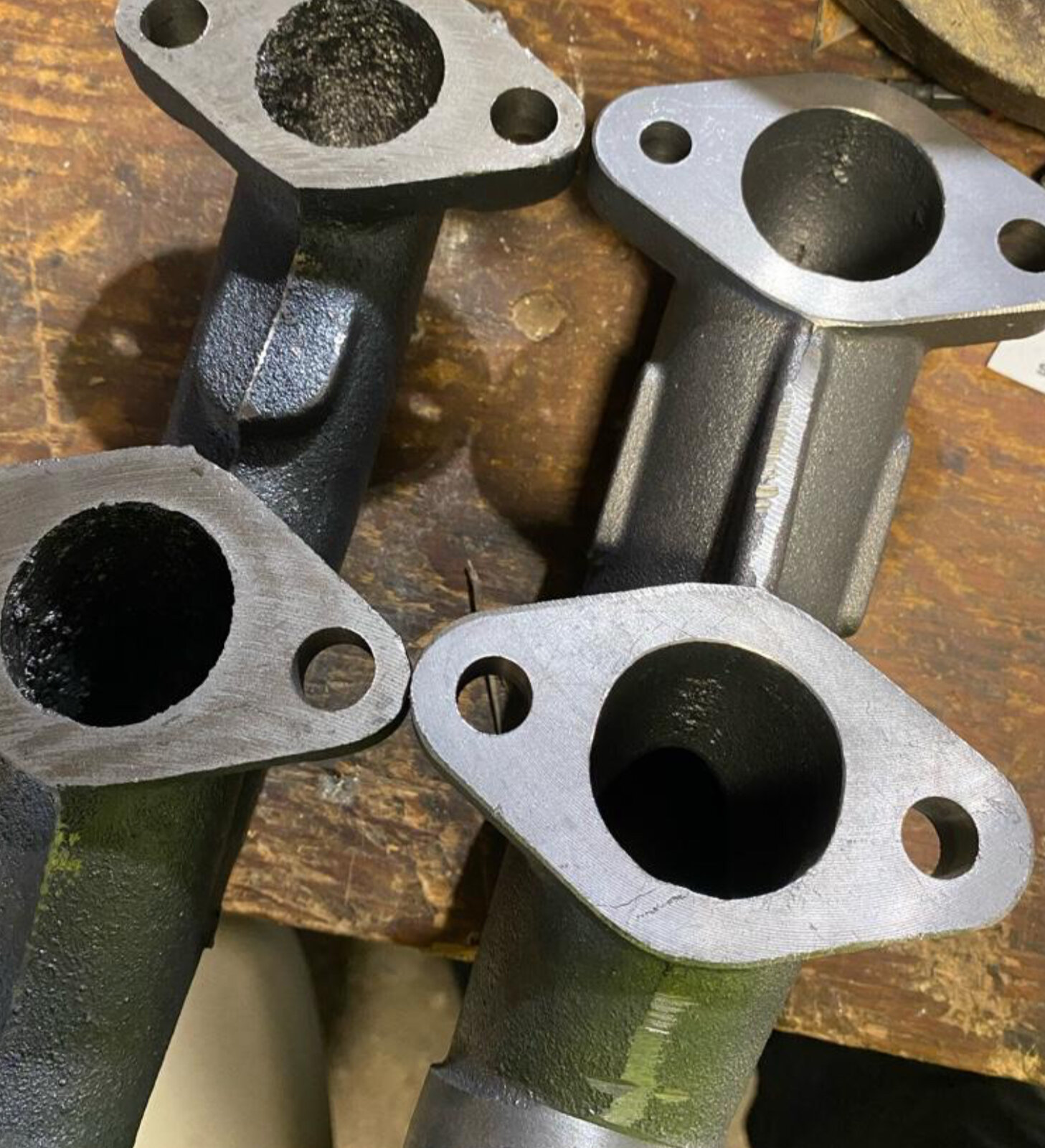

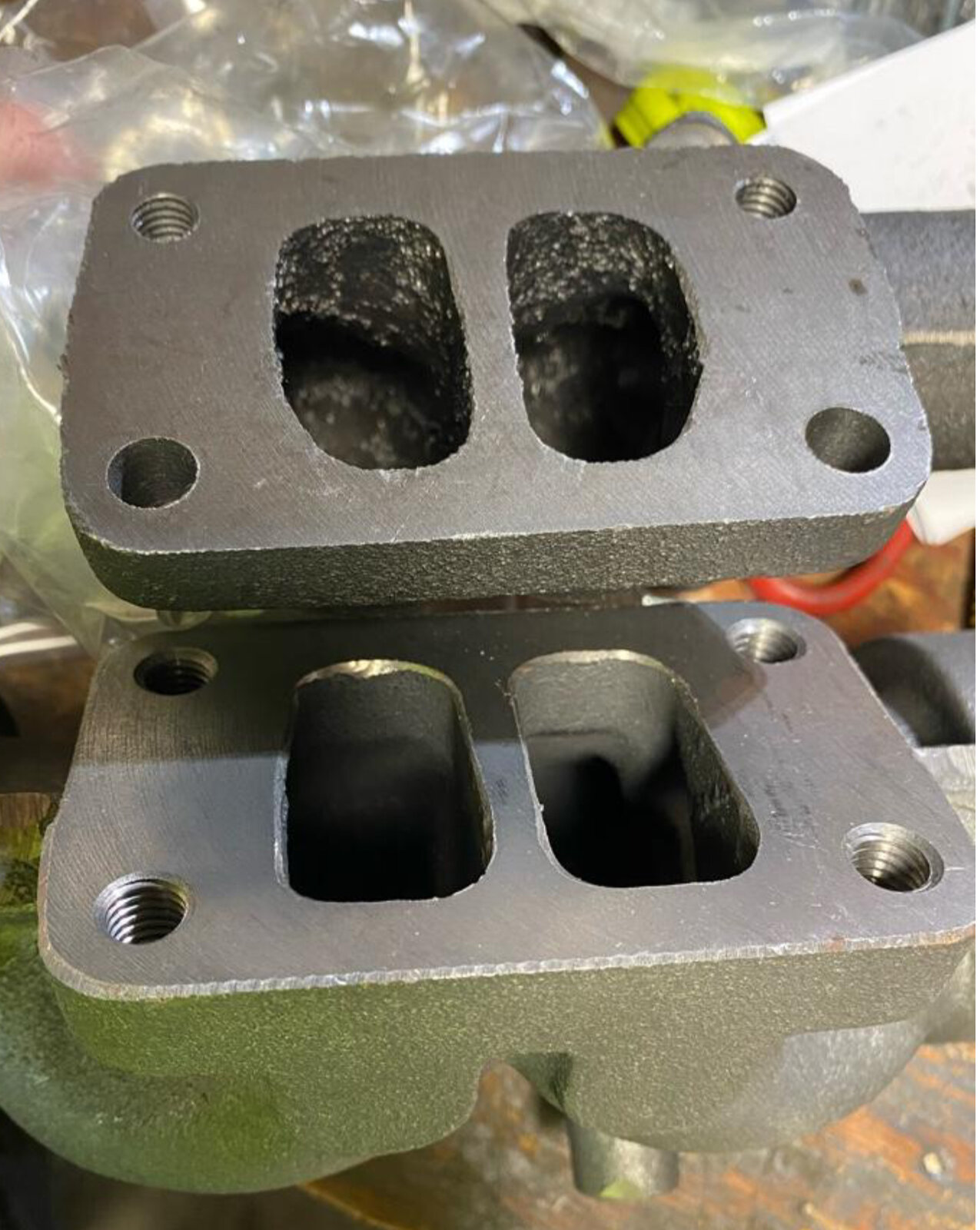

As to the Dorman manifold, I would advise against it. These are pics of a Dorman next to a DAP. I’ve used ATS and from what I’ve been told, Steed Speed is the cat’s meow but they’re pricy.

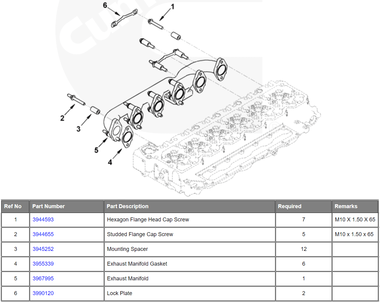

Also, not to say DB’s wrong, I’m sure the studs have worked for him or he wouldn’t recommend them, but I’ve experienced and heard of several instances where studs and nuts are hard to keep tight. Cummins uses bolts and spacers. I never had an issue with the Allen head bolts that came with the ATS. I torqued them at installation and checked them a couple of times over the following couple of months and they were tight every time.
I don't think you could get a rougher casting than that Dorman manifold. Steed Speeds make you want to put it on a wall and just look at it. Beautiful pieces of mfg.

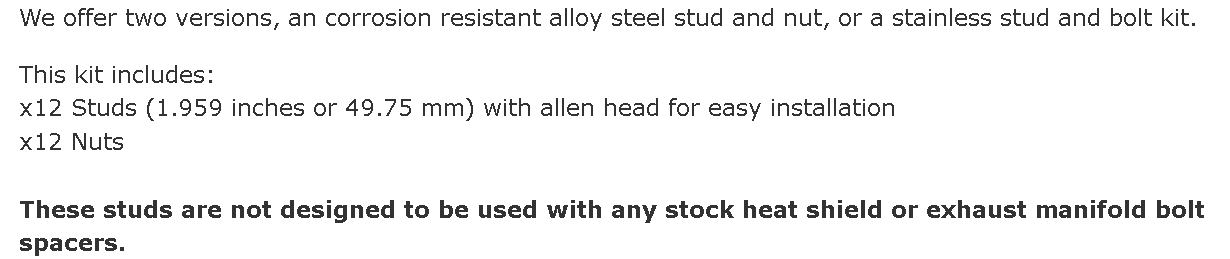

@BigPapa noted, "Cummins uses bolts and spacers." In my opinion, those spacers are a critical part in maintaining the clamping force of the exhaust manifold fasteners. That spacer greatly increases the length of the fastener, thus increasing the operational distance of "stretch" of the fastener. This allows for considerable thermal expansion and contraction of the exhaust manifold to occur without the fastener losing its clamping force.
I did notice that a couple of web sites mentioned the length of the exhaust manifold studs are approximately 1.6 inches and that the original spacers could not be used. To me, that is a recipe for manifold studs to loosen repeatedly over time.

I went back to the bolts with spacers and since the flange on the PDI manifold is thicker I also went with slightly longer bolts and torqued them to 40 lbs (up from the OE recommended 32 lbs) all at the recommendation of PDI. No more problems with the exhaust manifold bolts becoming loose but I still check the exhaust manifold bolts at every oil change because of my experience. Just my .02.
The studs I sourced from PDP are 1.959" / 49.75mm
Fleece hasn't given a length on theirs. I'm sure you could call and ask but again this is all besides the point of OPs issue at hand. We can go back and forth about hardware in another thread.
