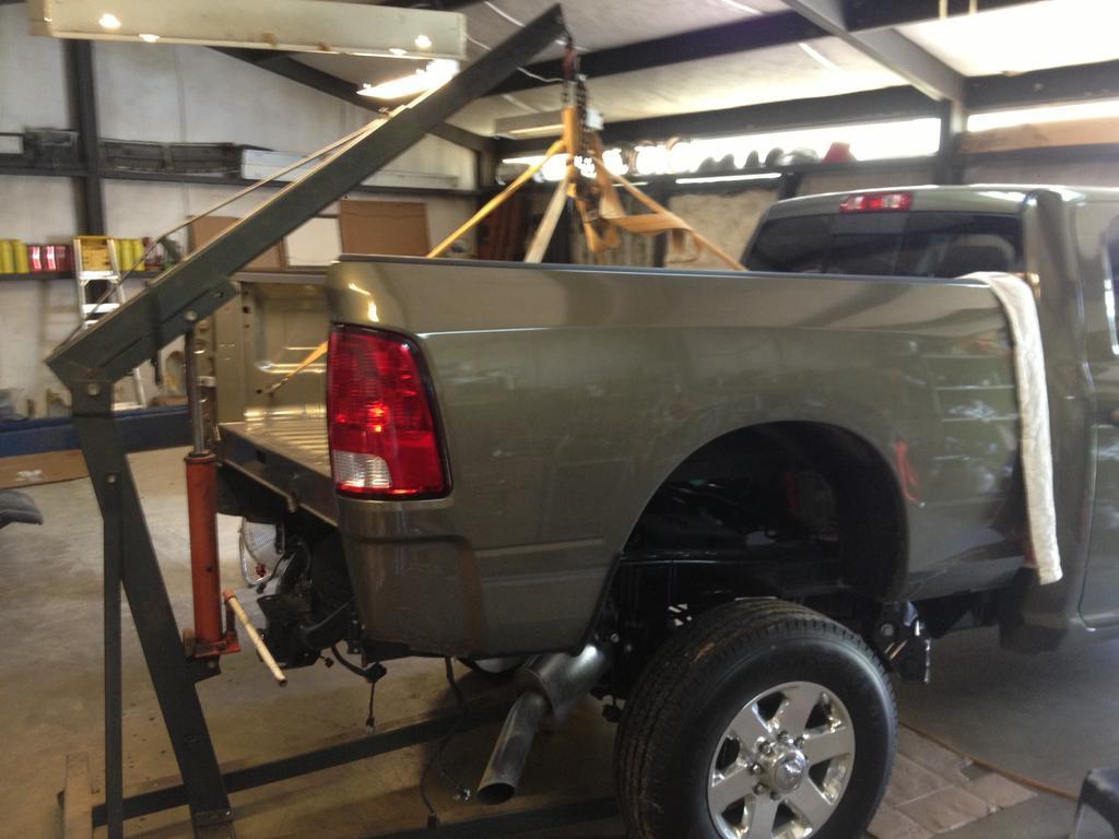

Anyone have any advise on the flatbed installation or my pulling the factory bed/bumper/receiver hitch (by myself, SWMBO will be in the shop). My plan is to hook my engine pulling porta-crane to 4 ropes going to the 4 tie downs in the bed, remove bolts, spare tire and wench, fuel fill port, wires....lift and drive out from under the bed.

<scratches head> On my '99, bed, bumper & hitch receiver are all separate. I've lifted the bed (with cap) a couple of times with a shop hoist (drop the spare tire & tailgate,) to get into the fuel tank module. It's easier than dropping the tank.

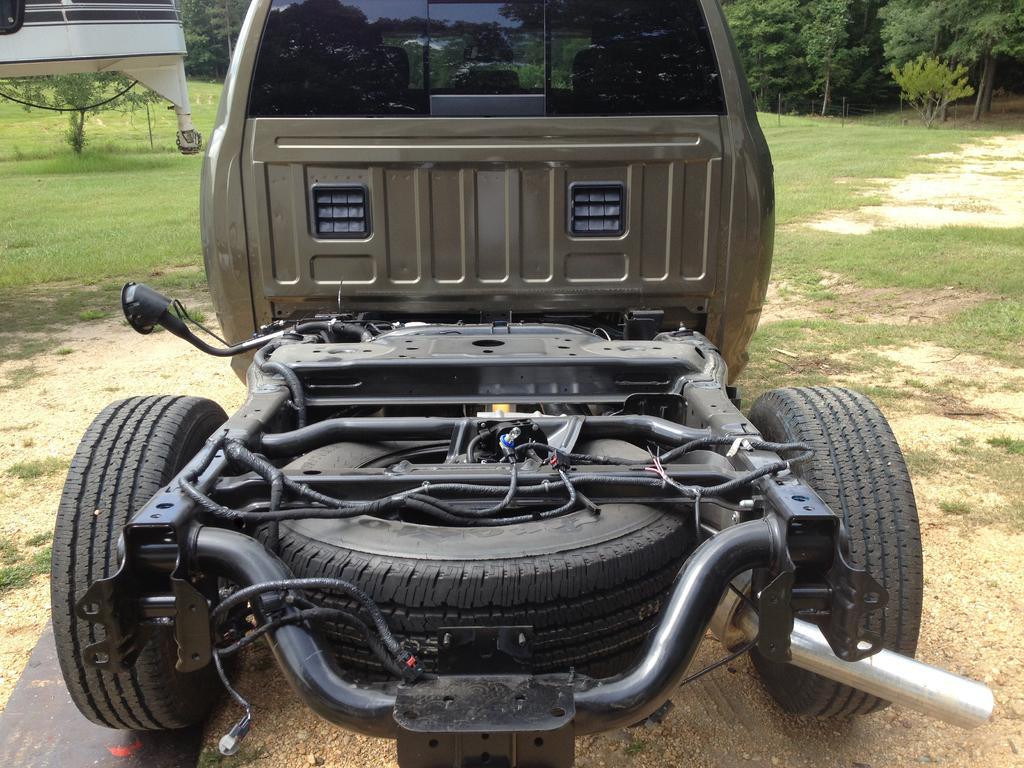

Well, two hours with the wife's help and the bed is off along with the bumper. Couple of interesting notes, no ground strap to disconnect...and there are vents in the back of the cab with filter medium and shutters. The wife closed the truck door at one point and the littler shutters opened up.....interesting.

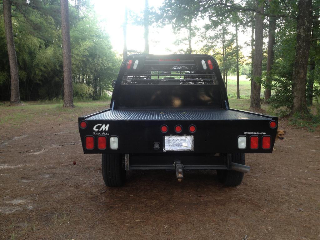

Well, to put the period on the sentence....it's done. Only a day and a half of part timing it and a bit over a 100 inches of weld and we have mounted flat bed. Pulled the trailer last weekend and it's definitely gonna be worth the aggravation. Big bonus, the truck rides much better empty, not to mention the 7'x7' bed that's so much more user friendly than the factory unit.
