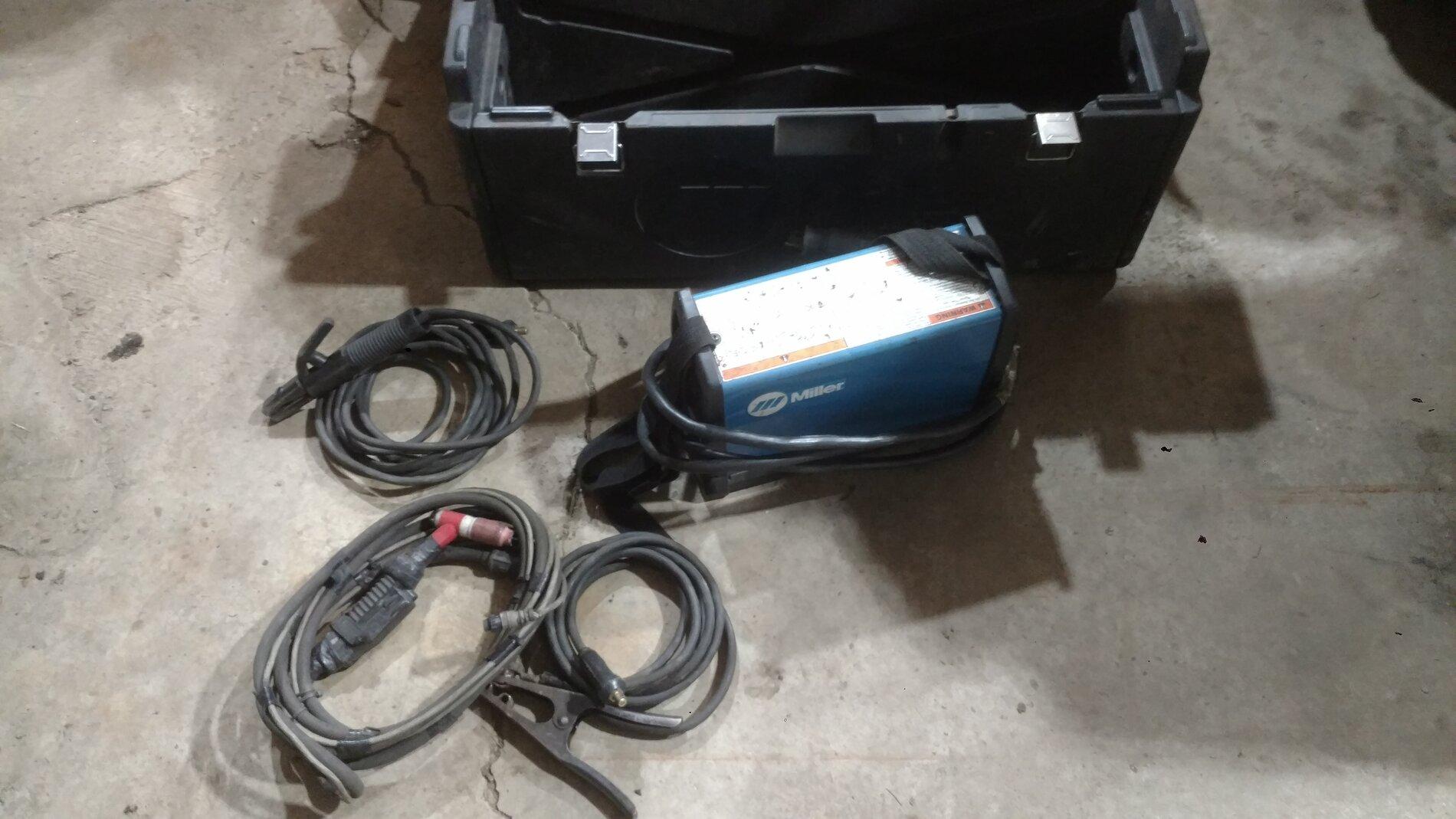

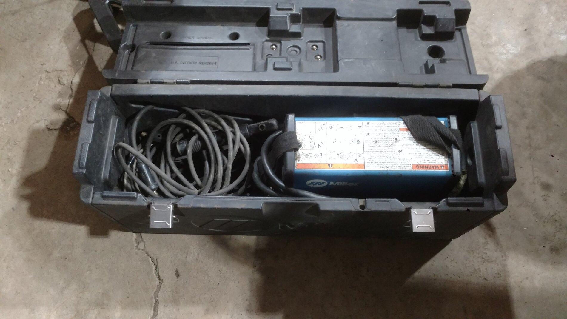

Speaking of welding, check out this little gem I acquired.
Stick and Tig capabilities, 220 150 amp, 110 volt 100 amp. It's also got an adapter for 30 amp rv style plug so I can haul this thing around camping and charge top rate to repair all those crappy RV frames :D
I'm super impressed with it. I've run alot of these inverter based suit case welders and been disappointed with most. Not this one. I just ran some 3/32 LH off a 15 amp outlet and it never tripped. Weld starts are seamless (where these things usually struggle the most).
I will run it off 220 most of the time but have always wanted one of these for their versatility and the deal was too good to pass on.
Happy camper :cool:

JR, I’ve seen that lil Miller in action. Very nice.
