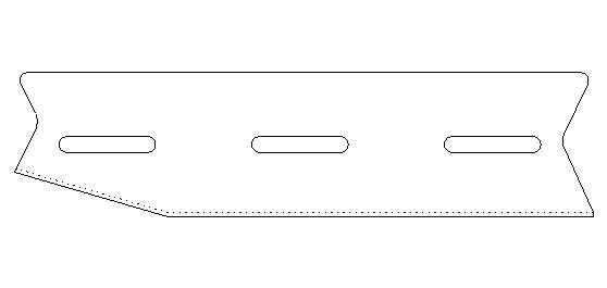

Here's the general concept for the repair piece (5x3x.120 tubing with top removed).
  • 18" long
  • 4-1/2" high
  • Angled ends to prevent vertical welds.
  • (3) centered slots (1/2x3) for rosette welding.
  • The angled upkick at the lower left is where the frame kicks up over the rear axle. The rotted section is below the center slot.
I think this should do the trick. Comments welcomed...
