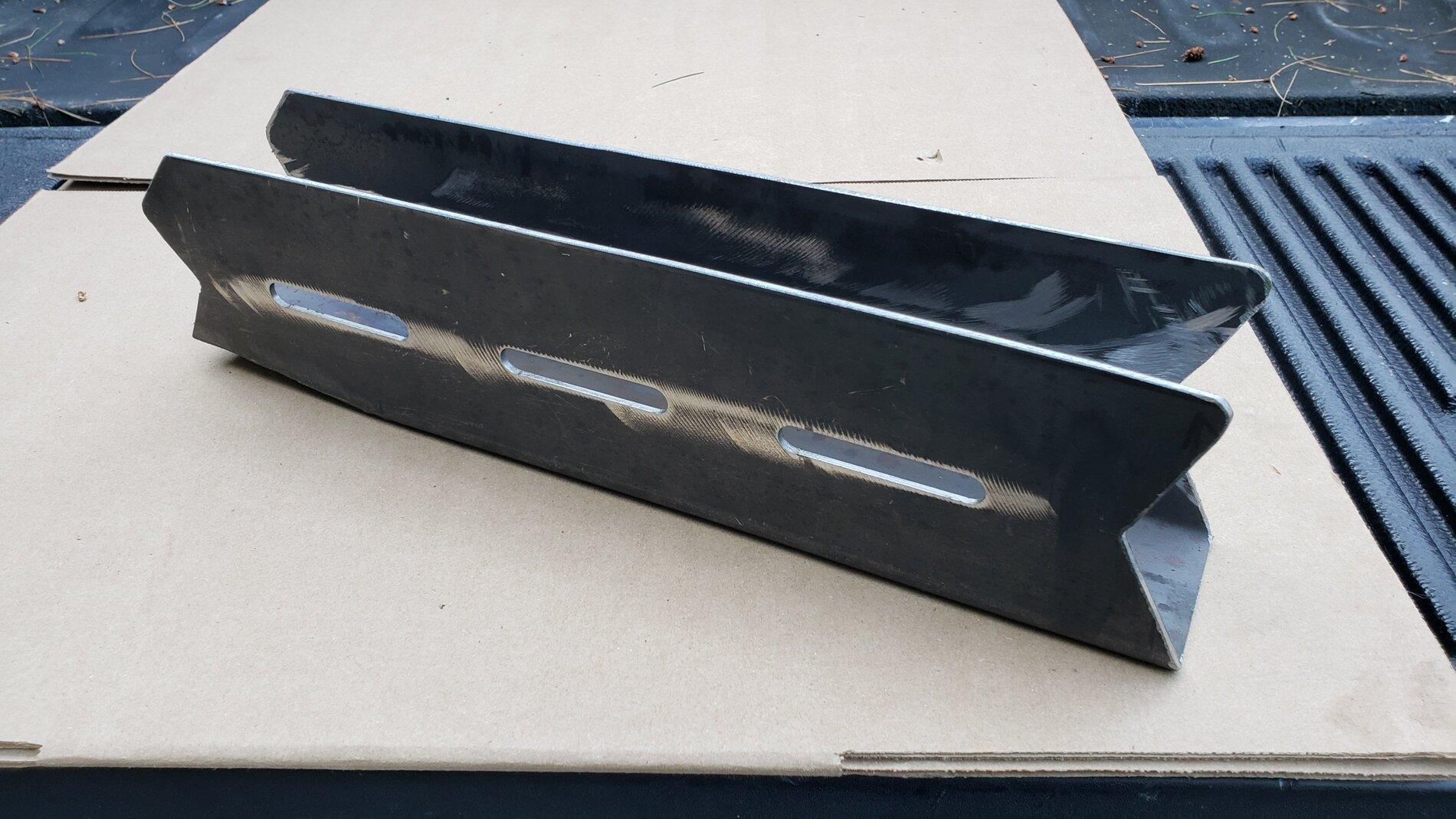

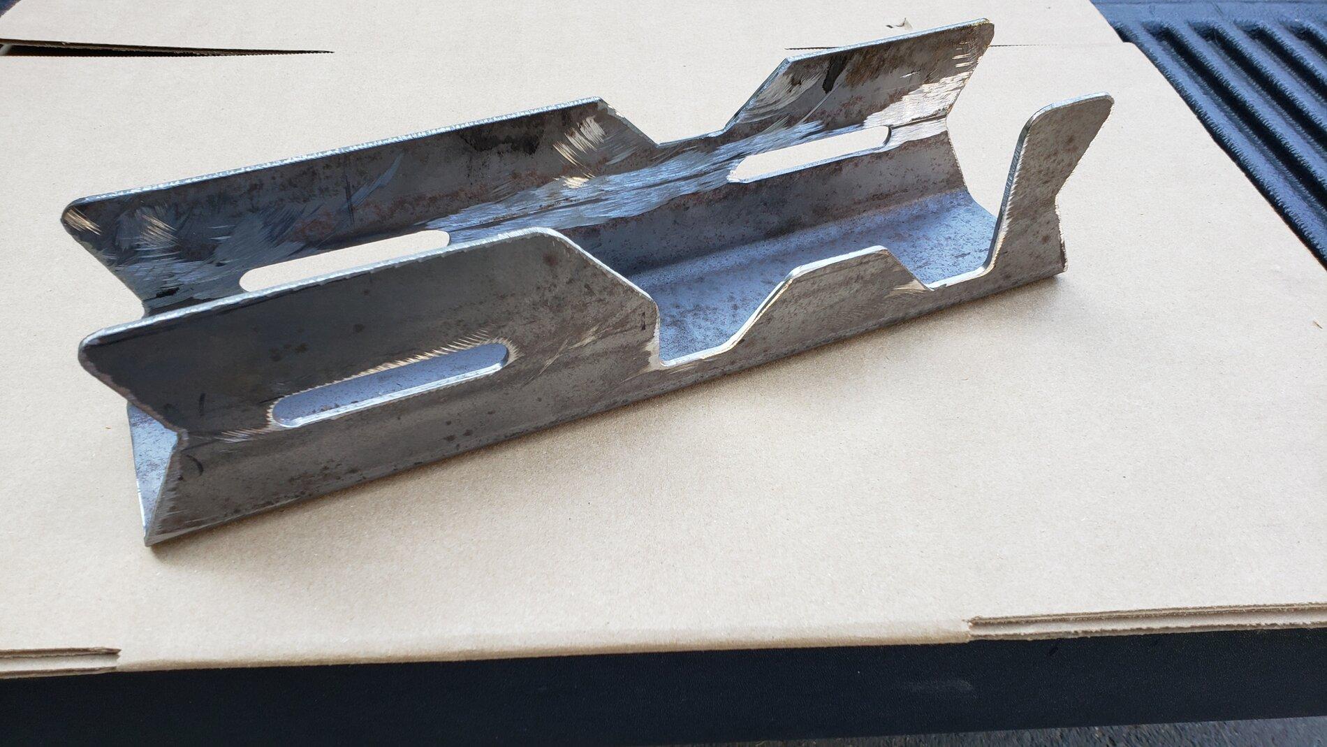

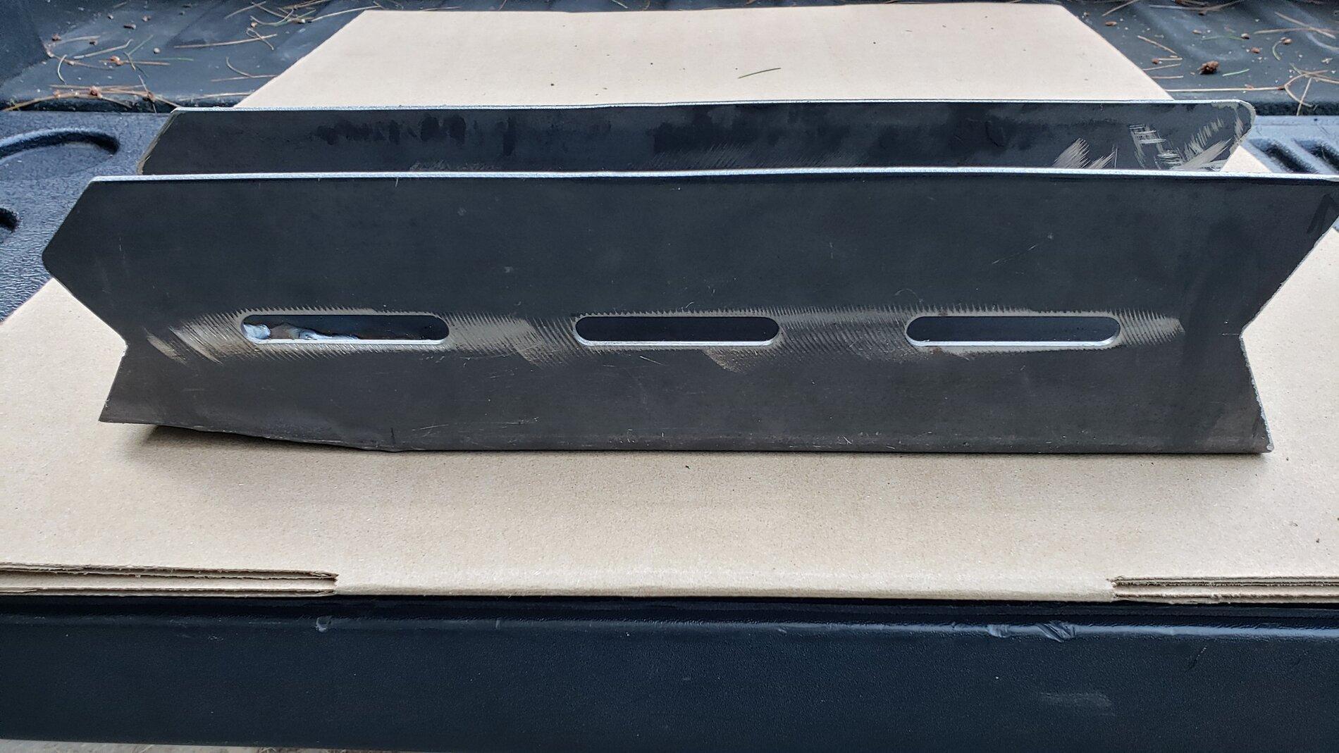

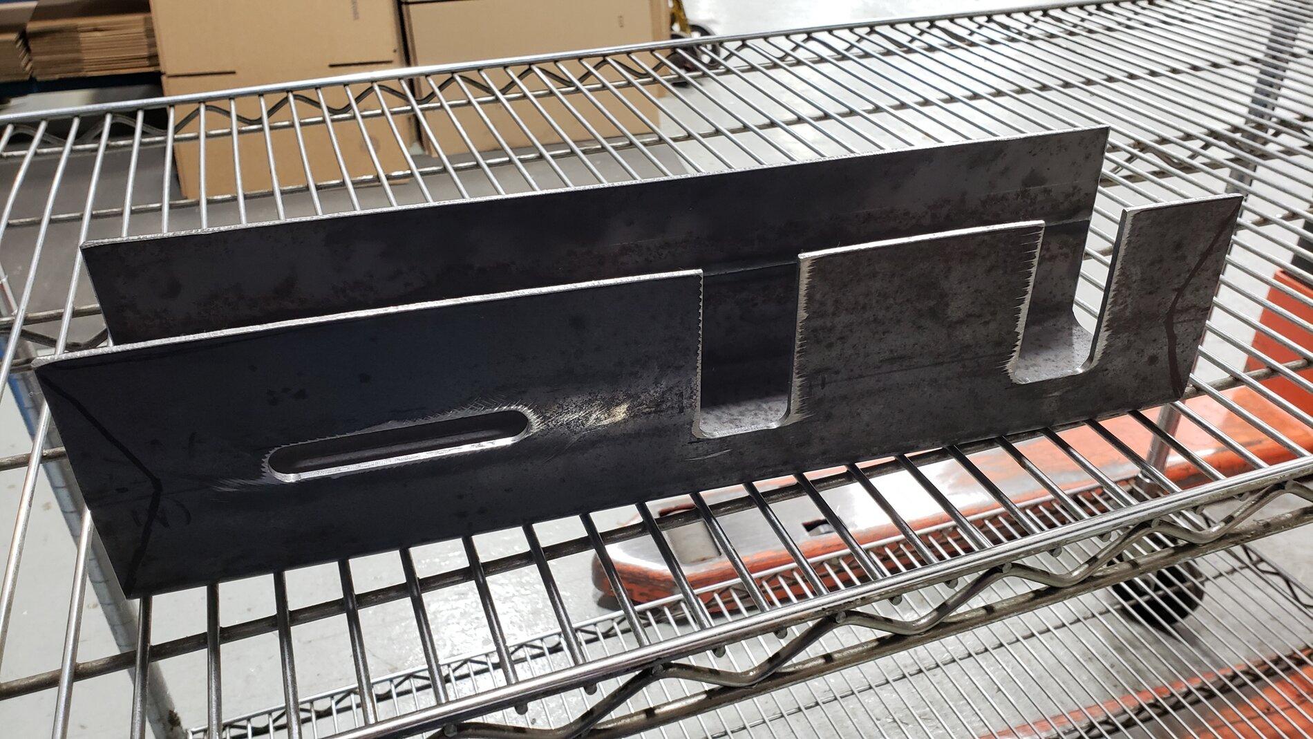

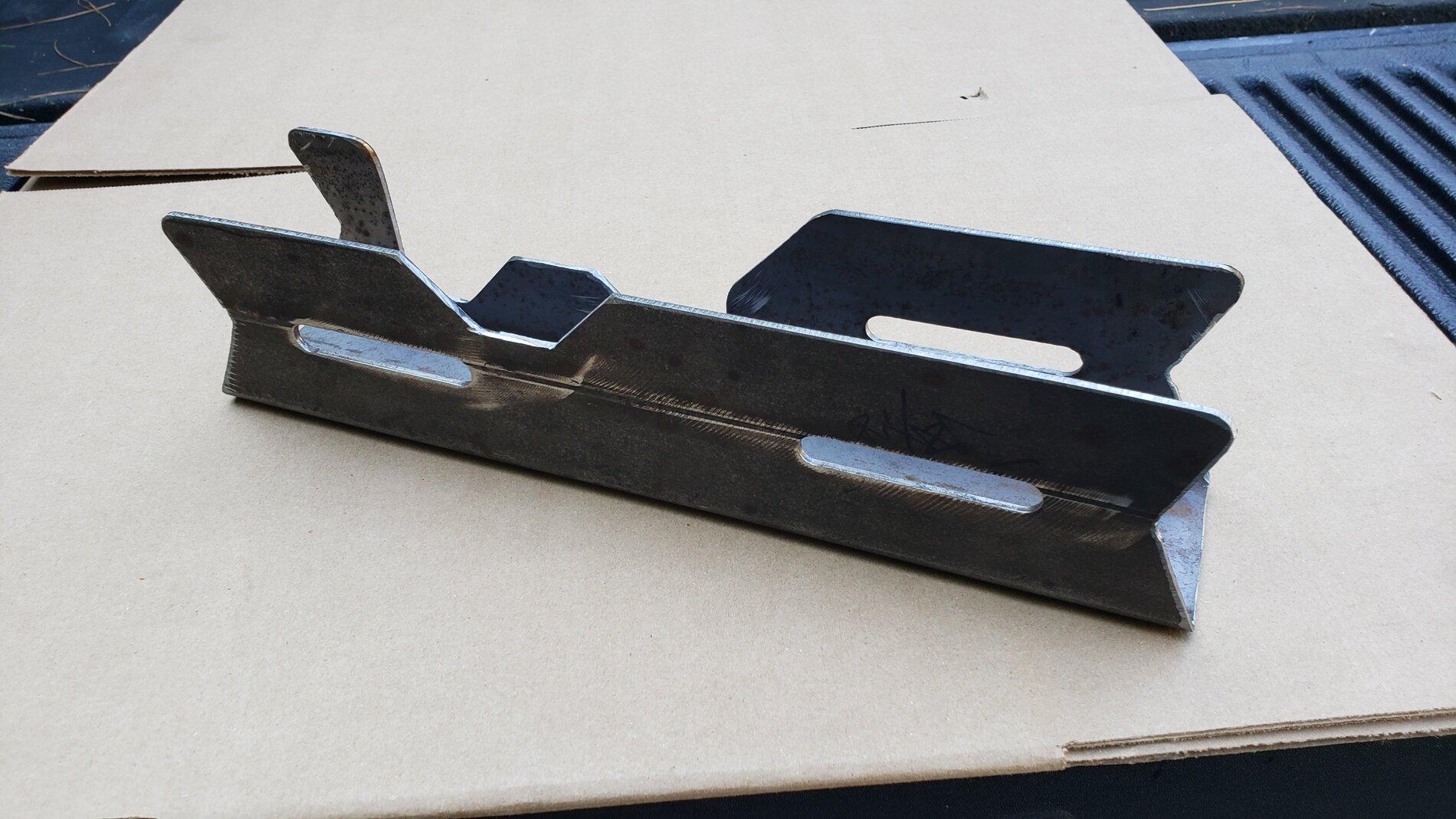

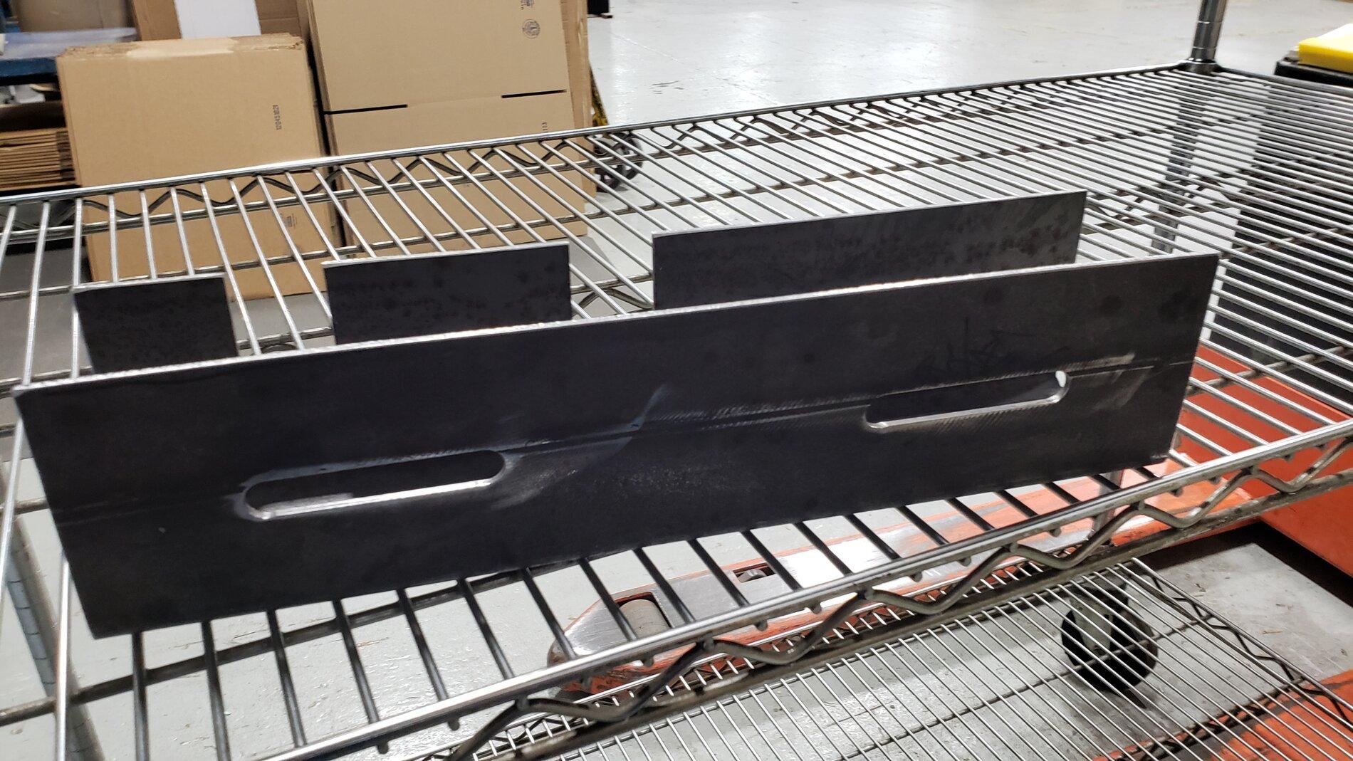

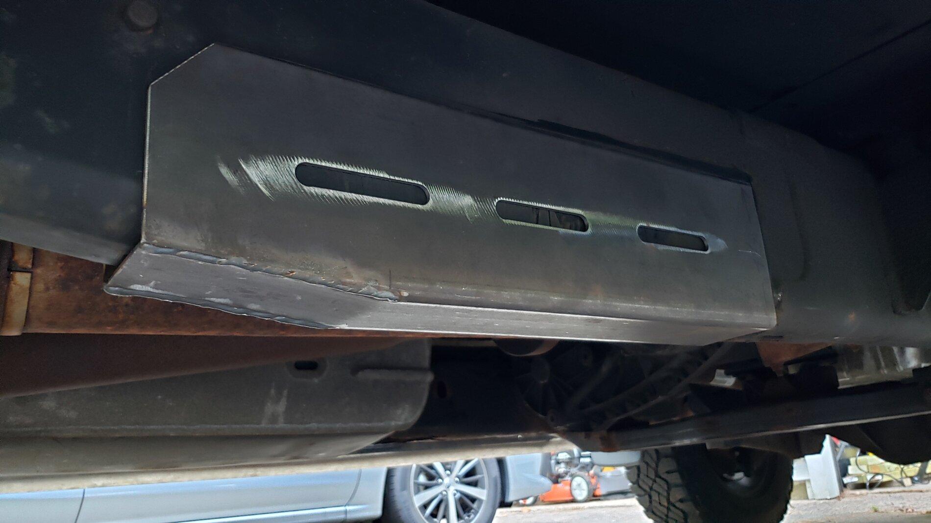

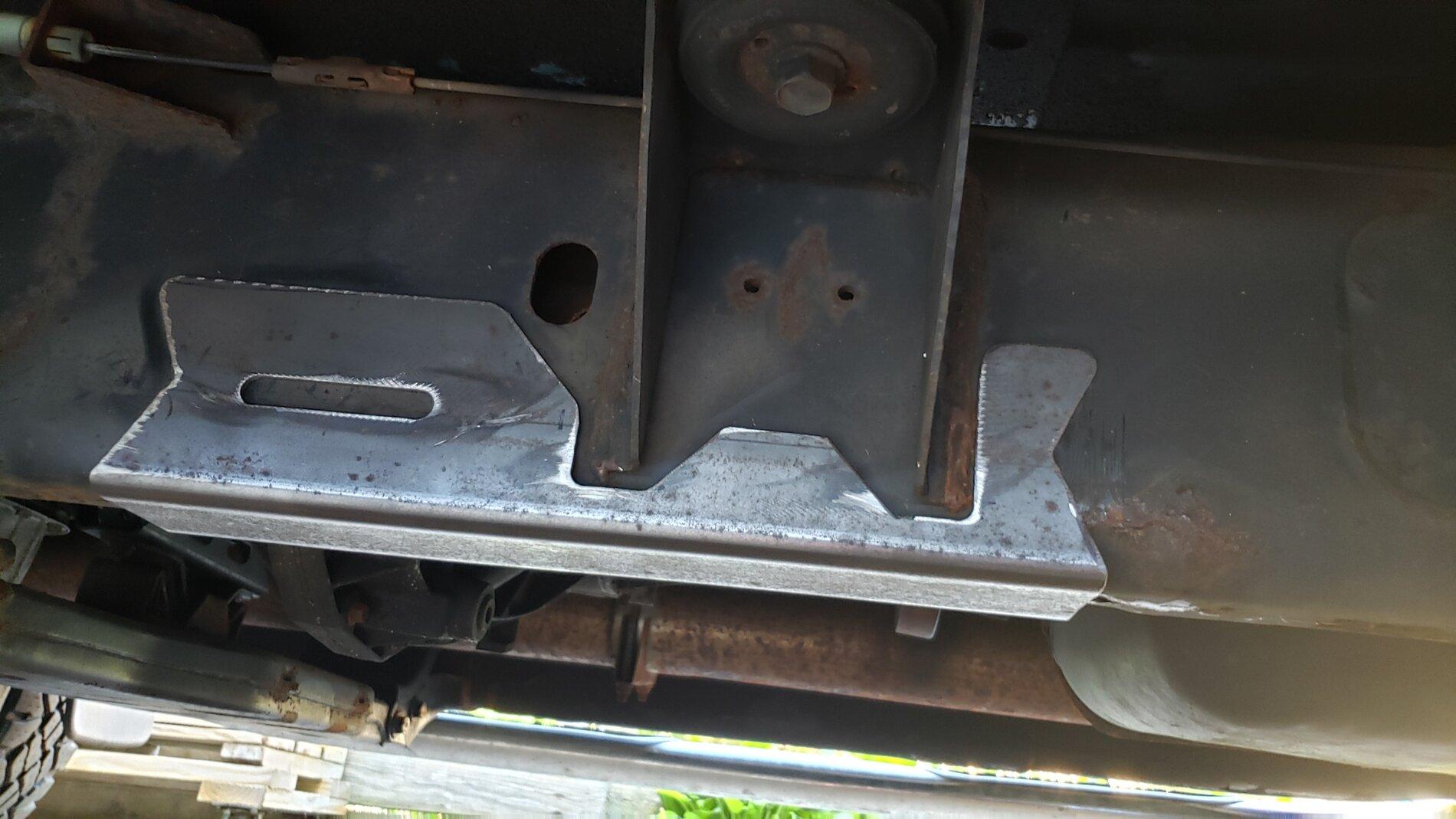

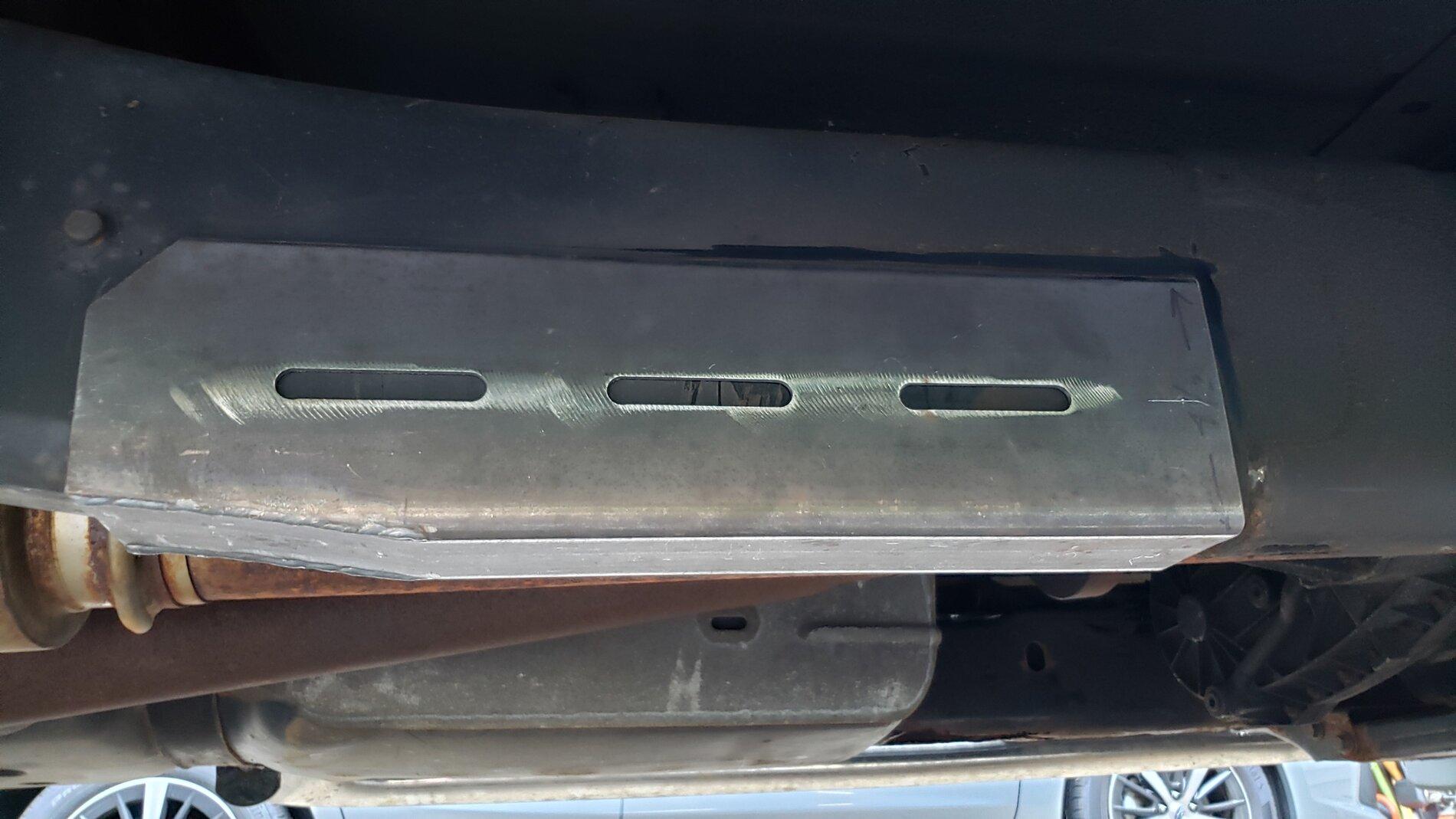

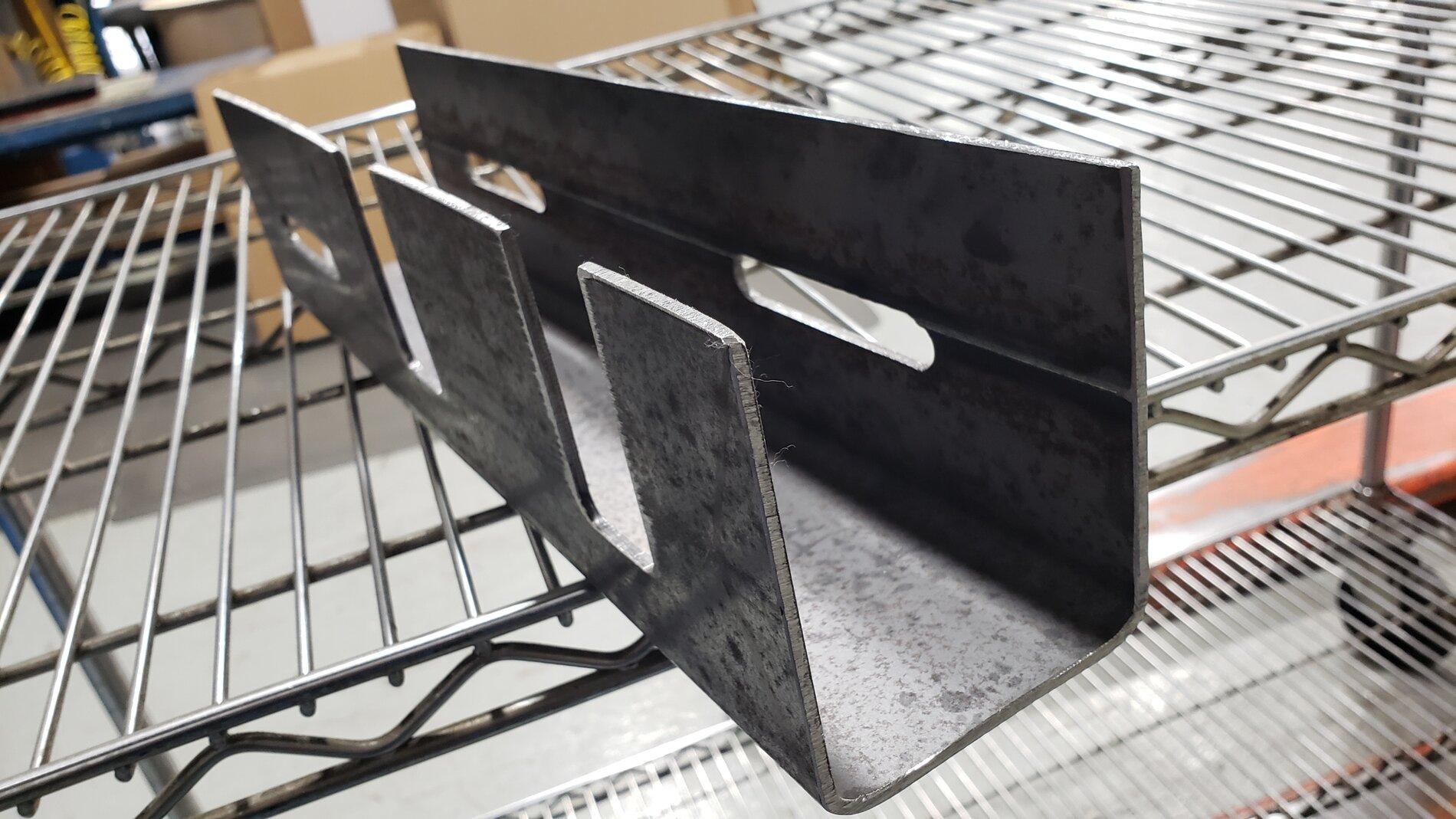

Here's one of the 3 repair sections I'm working on (before some major refinements I did tonight).
I put a lot of thought into how to proceed as well as listening to all the comments here and from some of the fabricators and machinists I work with.
I couldn't bring myself to do anything like in those pics.
If anything can be taken away from those pictures, it's the massive crack in the frame from what looks to be a previous attempted repair (1st pic).
Without knowing the full story I'd venture to say it
Kinda reinforces the necessity of doing some pre heating while welding.

I'm certainly not a metallurgist but from what I've been able to determine is that the 03 frame is not high strength steel, plus the thickness of the frame area to be repaired is .118 and my repair tubing is .120. Not certain but I don't think shrinkage/cracking due to dissimilar metals/thicknesses will be an issue.

That repair looks... um... bad.
Thats a very kind speak. It is plain horrible, like made in some third world country. They didn't even clean the surface from rust and everything else prior to welding, the welds are so porous that i hopefully never meet the vehicle in real life!
That example of a repair is the perfect example for a "don't do it like this"!
That wasn't a welder doing this - maybe a barber or a psychologist but not a welder.
Don't worry, it isn't going to pass safety inspection.

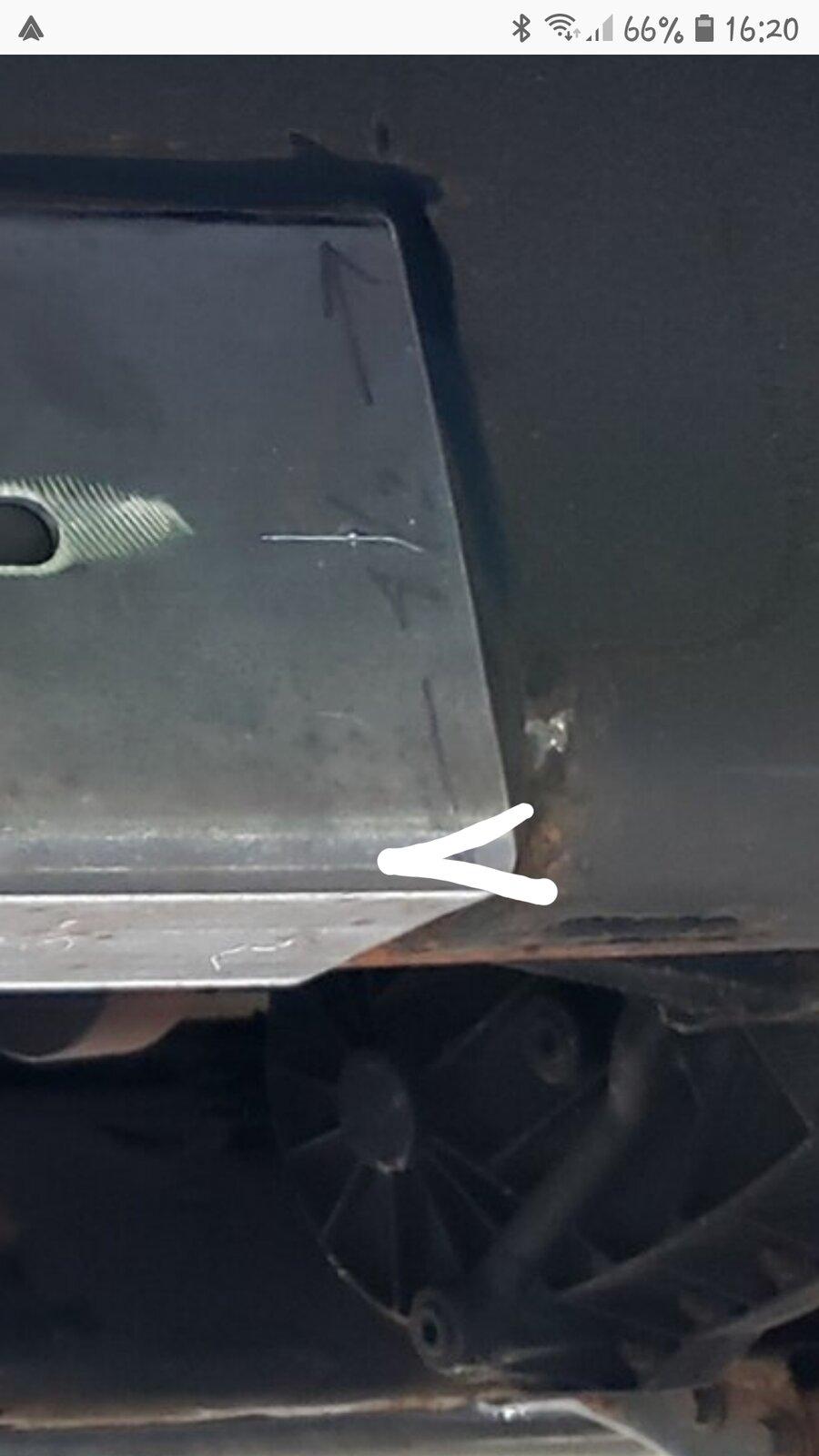

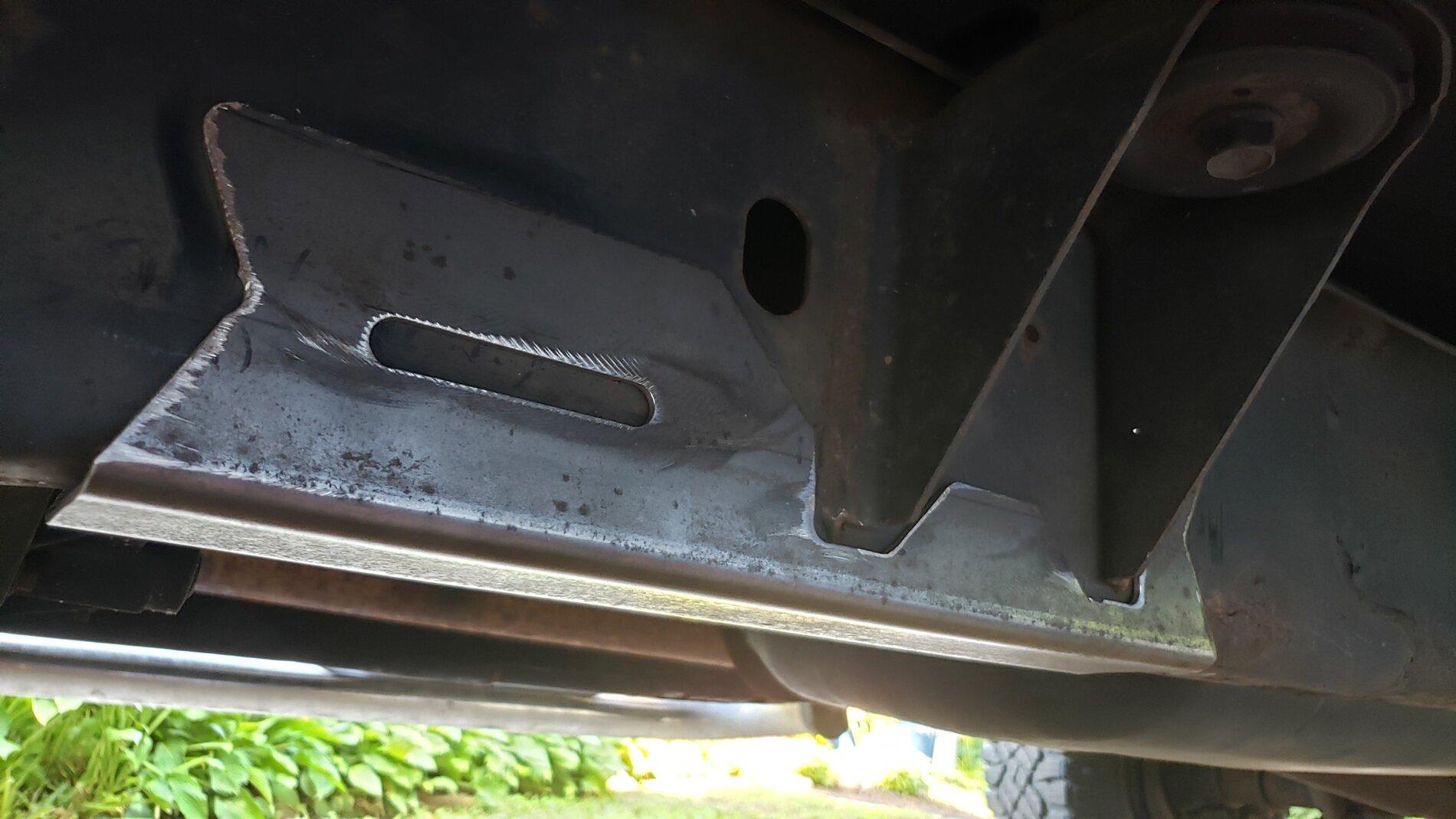

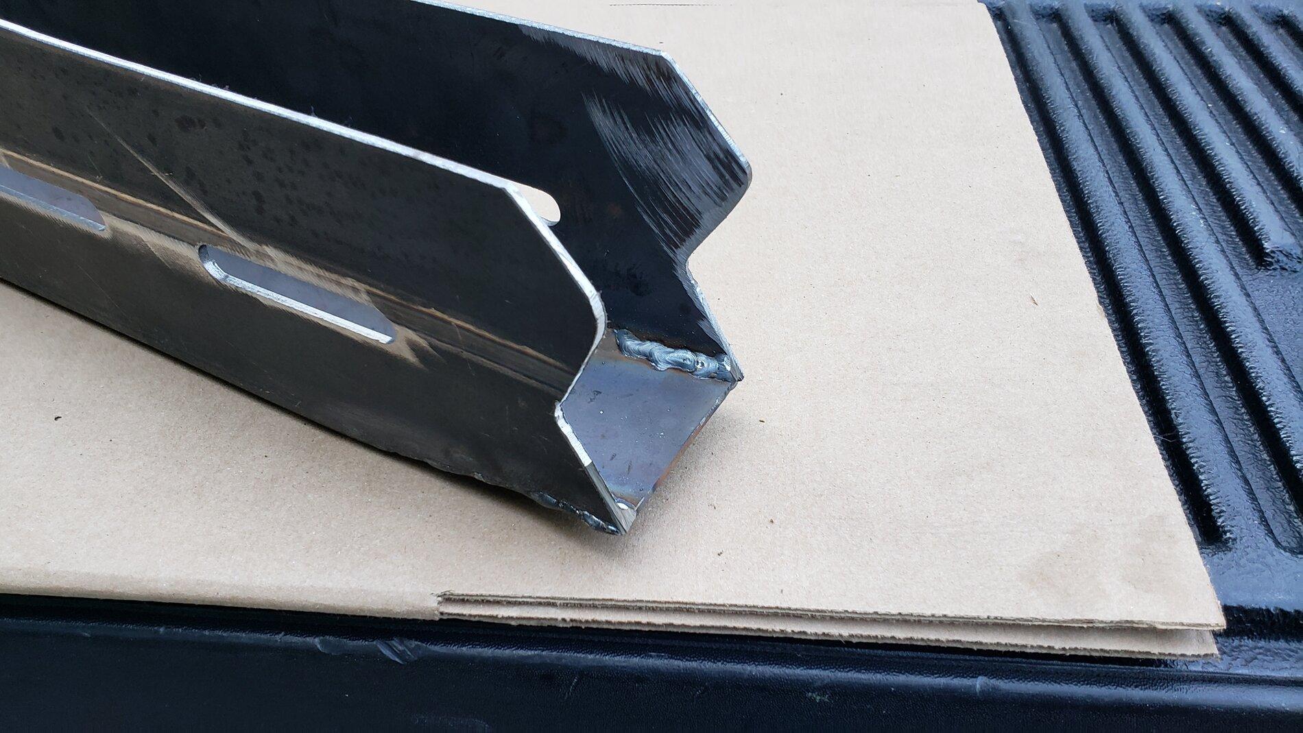

Looks good, now you need to cut out the frame and clean away all paint, rust and debris down to the bare metal to weld properly.
If these are the corners that do not fit, you could cut them like I show on the picture with the white line, then hammer them on end weld the gap.
That’s the next step. Heavy rains predicted for tomorrow into Saturday will set me back a couple of days.
I think I’ll just cut straight in the corner, wrap the ends around on each other, and then weld them.
