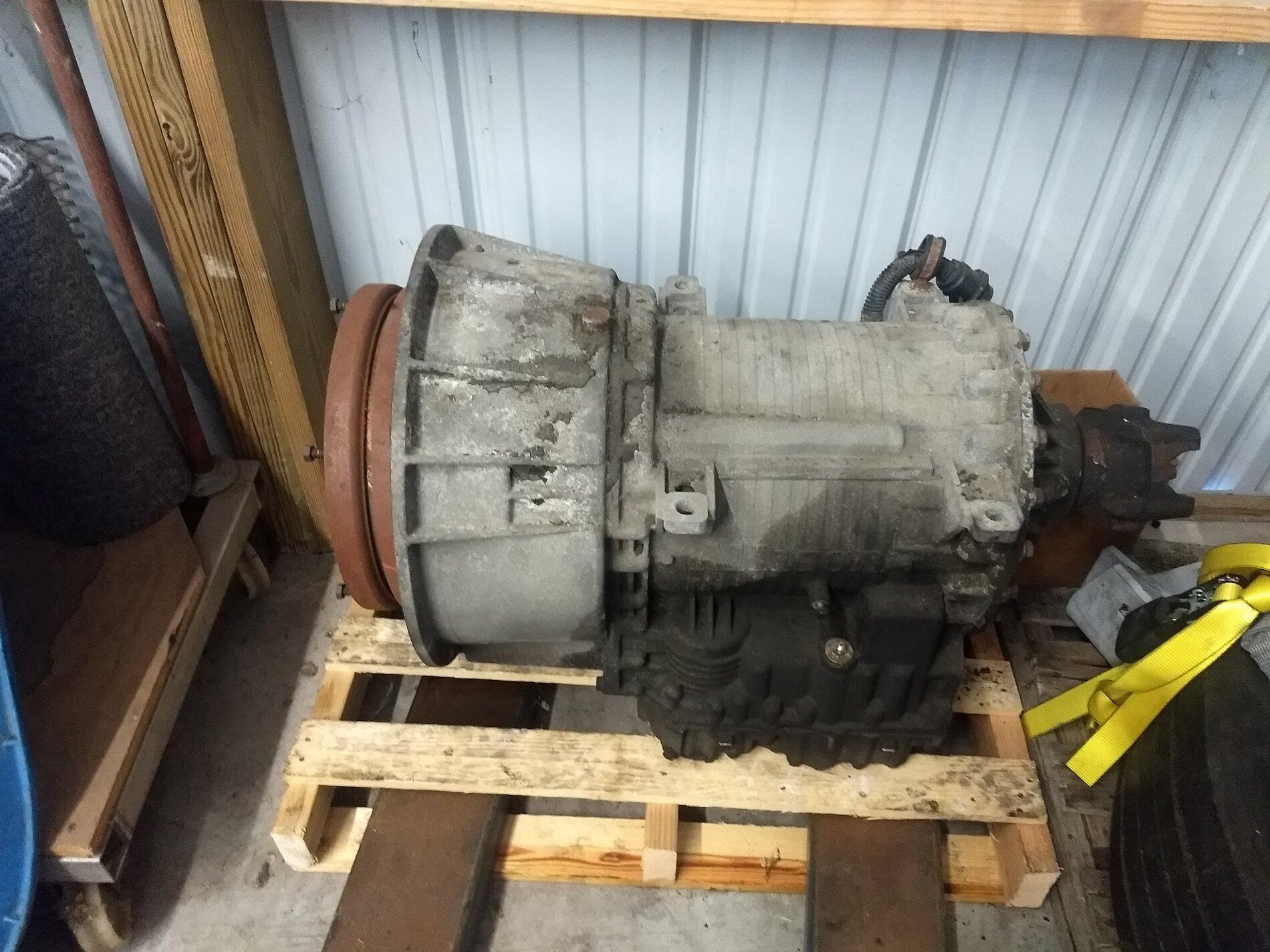

Nope sorry on that one, they're automatic, but you'd never hurt it
