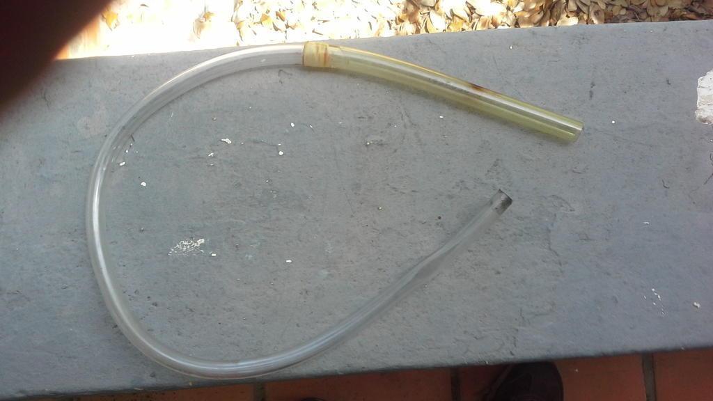

In this Picture, I took the 7/16 that came stock on the front filter of my 2013 and jammed a 3/8 in ID hose into the stretched out end of it. (the end that had been on the fuel drain on the front filter.
Both ends of this new combined hose have different inner diameters. so I use it on both front and back. I just turn it around because both ends have a different diameter.
It doesn't leak.
