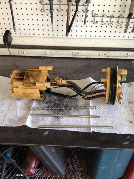

I pulled the pump from the tank and I found (1) long spring and (2) tubes sitting on the bottom of the tank. I pulled this pump in 2009 to do the tank modification but I don't remember much about it. Any help where the spring/tubes go?
