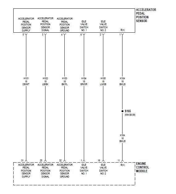

Yes he tried one for a 99 that he had in his shop. Really thinking of taking it to a Dodge dealer close by that has always had a diesel Tech. and letting them try to figure out what it is. I hate to think of that but it seems definitely not mechanical more electronic. I'm "hopefully" closing like May 13th and I need my truck to do things here and at new place. I'm at a loss... Thoughts?
Wild guess...
The ECM don't recognize that you put it in gear and therefor does not raise fueling according to the load that the TC puts on.... and it dies.
David, idle valve switches, humm. #1 idle no load - #2 in gear load. Not sure but???
Like David asked anybody know anything about them?
I am wondering if that is an error in the diagram or the diagram is for gas engine. I do know that there is an idle validation switch (valve? maybe they mean validation?) in the APPS circuit and I think some of them have two idle validation switches. I believe that the second one could be used for an accessory such as an aftermarket exhaust brake control.
I don't know this for sure. I do know that one function of the idle validation switch is to give all fueling control to the ECM at idle - the APPS has no input at this time.
- John
1&2 same signal from what I know, fail safe as there is only one other throttle signal. It's the same APPS all the way to 04.5 and I had to change mine.
It is used for the EB for example, also it hands over throttle control to the ECM if the load changes through AC on or load from the Alternator.
