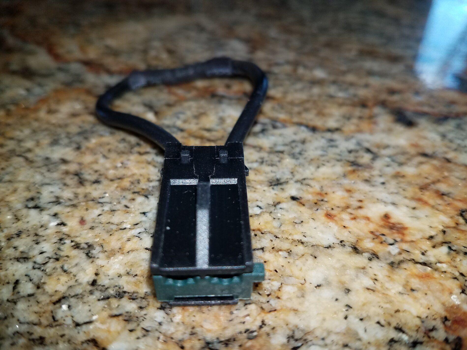

thanks fellas. im, for now, just going to tie the wires together. slightly frustrated, and need to just think about work for a few days....cheers! and thanks for the part numbers too. chris

comrades - one last question - if i tie the wires together on the clutch switch, will i fry the cruise control? just wondering. i have strange luck, so just throwing that out there. thanks! cheers!
Everything should work normally EXCEPT the fact that now you can start the truck in gear without the clutch. I do know it won't effect the cruise system. I had mine this way for over 3 months while I tried to figure out the same issue.

made a jumper from a sensor i bought online. had same connector on it. for a older dodge... turns out the dealer who had my truck for 30 days never tied up the wires correctly, and the clutch sensor wires fell down and got pulled out by the clutch pedal itself. this is the kind of thing that happens when a kid takes apart a brand new truck at the dealer. will be interesting to see if they warranty the new switch replacement, given the wires fell down from their tampering with them? cheers comrades!
