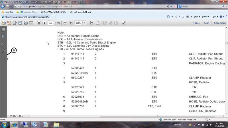

I just used a 1998 and there is only one choice... ..... Standard or Auto makes no difference as the transmission cooler for an Auto is in front of the rad.
Go into this and play around a bit. If you need help with navigation let me know.
https://www.turbodieselregister.com/forums/showthread.php?232223-Links-to-Dodge-Parts-Fiche-PDF

What Mwilson said. I had the radiator out in the 99 w/ 47re and in the 01 w/ nv5600 and they are exactly the same. Only difference is the 99 had the trans cooler.

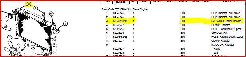

So wonder what the difference is then between the 98 and 02 is then. Logic dictates newer is better as something was likely improved..... :D
I did not try it, but the part number for the '98 may supercede to the part number for the '02 when all is said and done.
