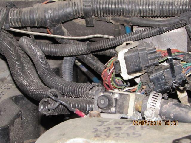

I hooked up my scanner once I got home and found it giving me the death code P0216. Hey 216 code can also be a bad connection. I was getting it on mine took me 3 weeks to track down the connection. It is the big one on the firewall with the white bale. Also check the vp 44 connection they do loosen up, or the a&^%$ could have messed with it. didn,t read all of post, see you are already rebuilding. Looking good.

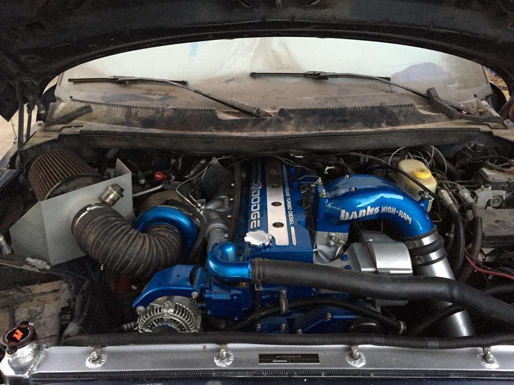

Here she is sitting nicely in the engine bay. I have only driven 20 miles or so and have tightened the head studs twice now. It runs very smooth and it seems to have good power. I have only gone half throttle and she comes on strong. I will be driving it more this week after I install the ARP rocker arm studs and re-adjust the valves lash.

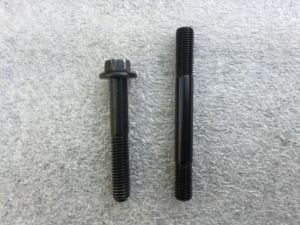

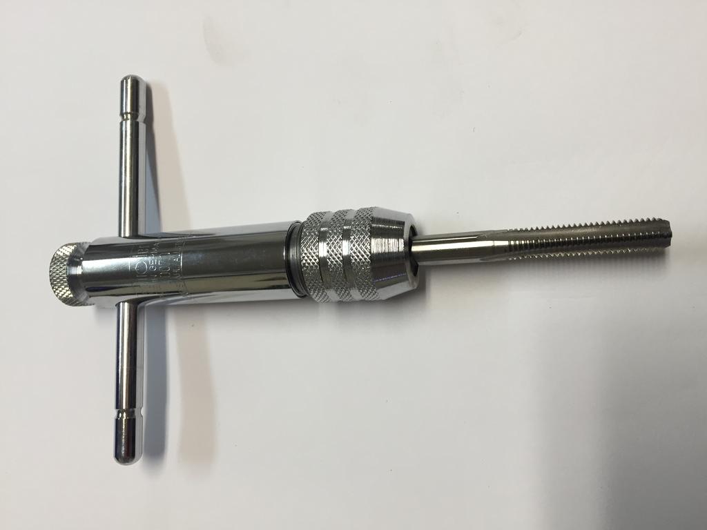

So I got my APR Rocker Arm Studs yesterday and you can clearly see the differance. These are very high quality and cheap insurance if your plannning on installing bigger stiffer springs because the stock bolts are not up to the task. Tools of choice are a ratching T tap wrench and cotton swabs. I can't stress enough to buy a high quality bottom tap it is worth the money. I used the bottom tap to clean and fininsh tapping the holes all the way to the bottom which wasn't very much. I used the
cotton swabs to remove all the oil and metal shavings from the holes which worked very well. Just us extreme caution when cleaning out the holes not to drop and of the metal shaving down inside the bottom of the head. Tonight I will set the valve lash and run it around for a bit.
