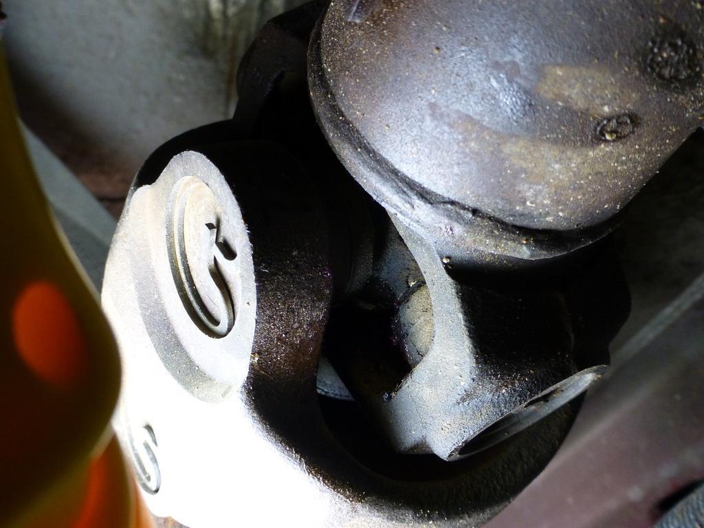

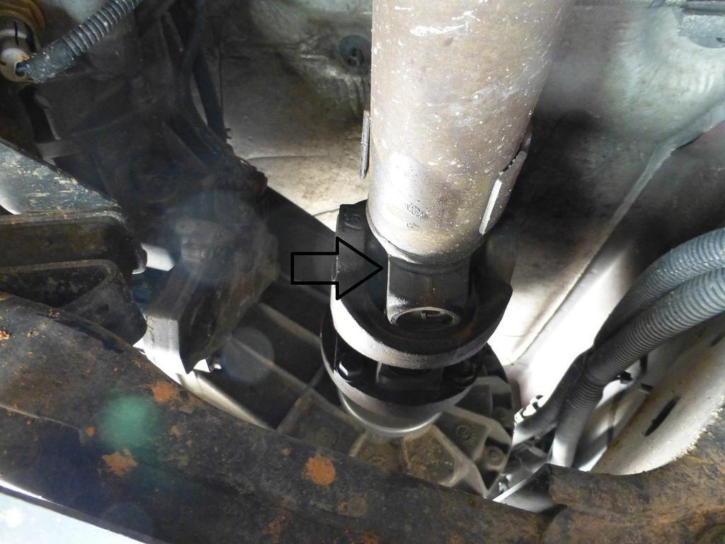

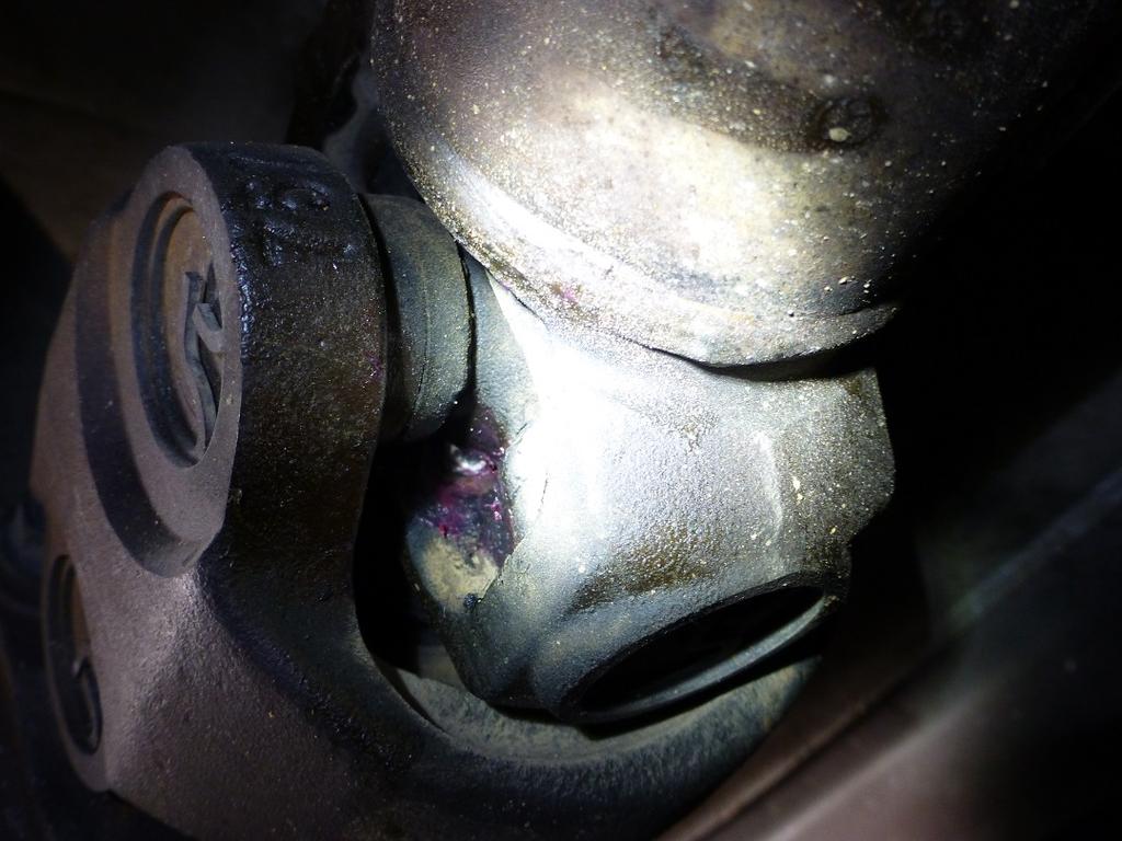

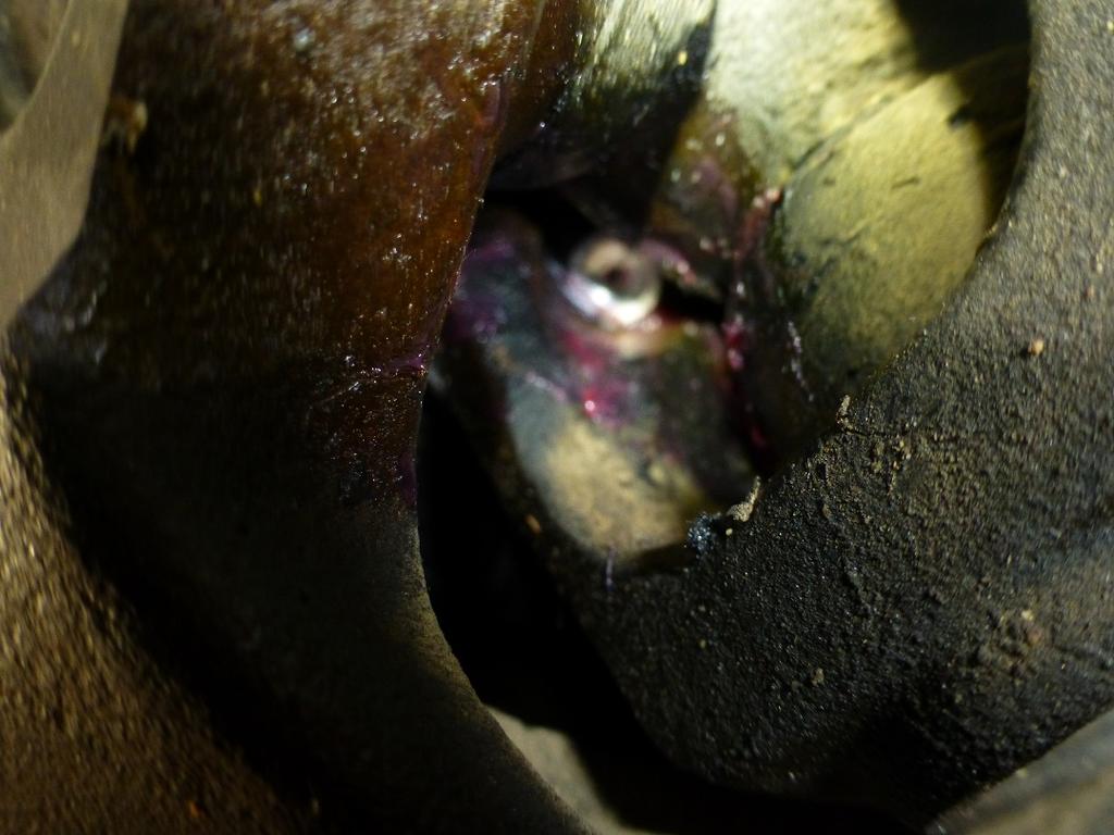

Here are some pics - hope it helps! On mine, if the u-shaped ends of the front driveshaft were up and down and the u shape end of the yolk (?) that goes into the transfer case were horizontal to the floor - it was in that position I found it.
