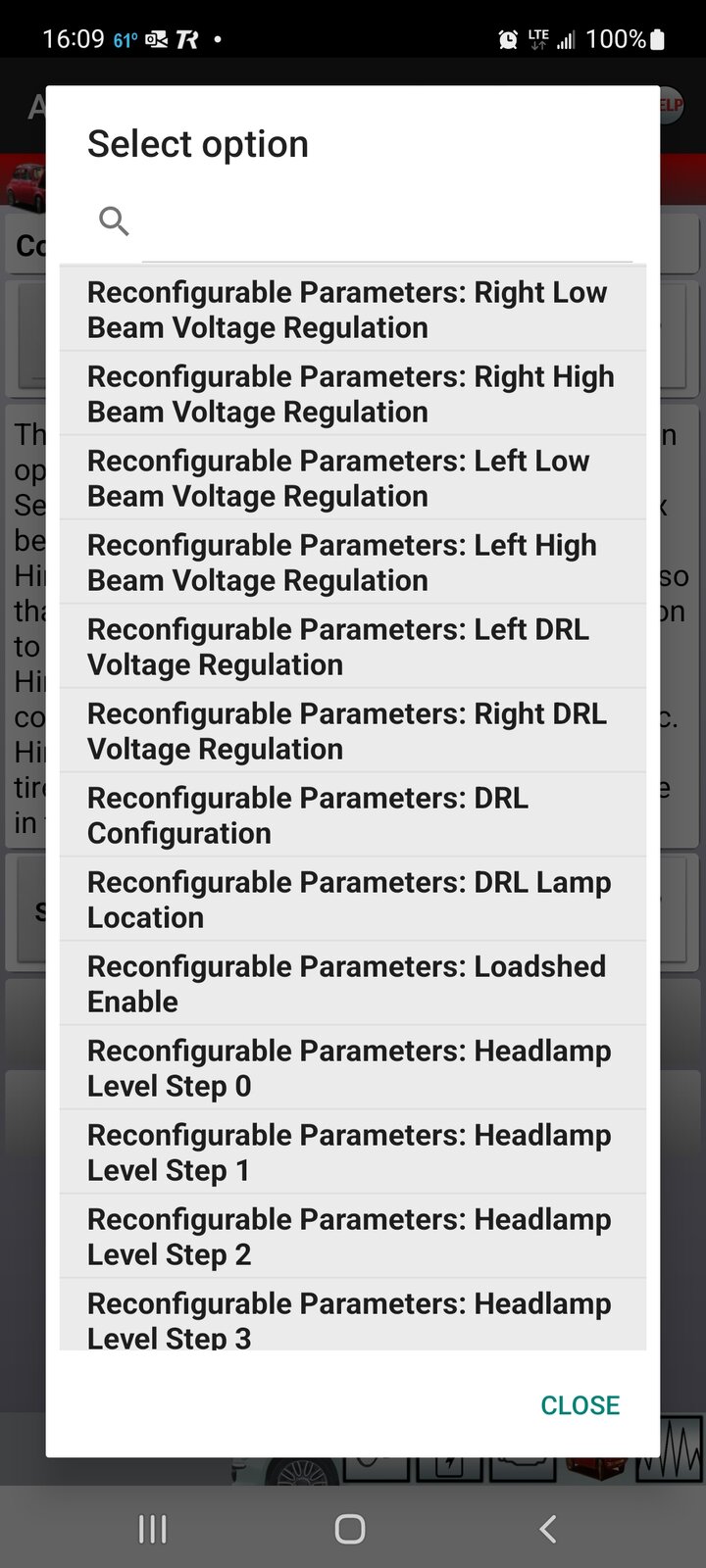

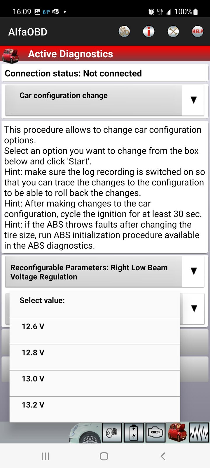

With all the discussion of headlight voltage, I was curious if anyone is aware that AlfaOBD is capable of setting it anywhere from 12.6V to 13.2V. Of course this only applies to '06 and newer. Also, It will allow you to have fogs with high beams, and enable 'quad headlamps' to have both filaments lit while on high beam.
Interesting. Is the voltage adjustment just to the headlights, or all exterior lights? My neighbor has a 2011 truck - would this work on his truck?

The setting is for each headlight individually. As for your neighbor's 2011, the procedure will be the same. I actually performed this adjustment on my '09 to see if it did anything. I made the change on just one headlight to compare, and I noticed a difference, both in intensity and color. This was a couple years ago and unfortunately, I didn't take any pics.
Factory setting was 13V. I know that 0.2V doesn't seem like a big difference, but it was noticeable. Too bad it won't allow you to set it closer to 14V, but I'm guessing it has to do with bulb longevity.

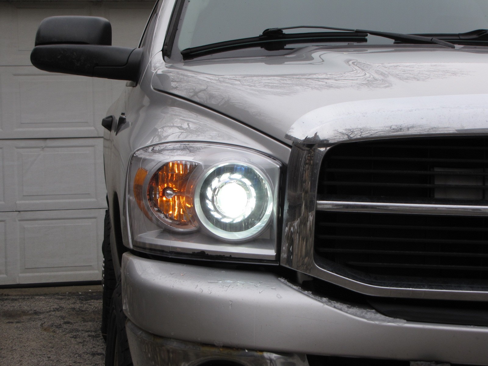

Morimoto Mini D2S 5.0 projectors https://www.theretrofitsource.com/bixenon-morimoto-mini-d2s-stage-3-CRK-D2S?quantity=1with turbine shrouds, backlit with switchback LED ring for DRLs. The headlight housings are DEPOs from Geno's. If you want an LED solution, Morimoto M LED 2.0 would be it. https://www.theretrofitsource.com/bi-led-morimoto-m-led-headlight-projectors-kit-HS-MLED?quantity=1 The Retrofit Source is wear I got everything.
