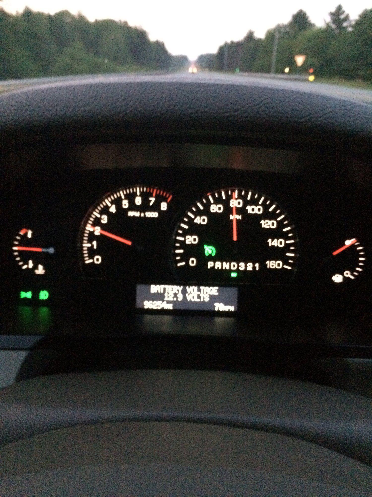

12.9 volts @ 2000 rpm?
Perfectly normal. The GM BCM cuts the rate of charge back when the battery is satisfied. The other DTS and my Yukon do the same thing.
The HID headlights and LED tail, marker and dash lights draw a lot less than conventional bulb set ups so normal for the voltage to drop back even after dark.
The only thing that will make it run 14 volts other than after a start is using the rear window defogger....
I believe that the batteries last far longer that way...
Glad to hear it is normal. I would have thought the lowest non draining voltage would be 13.2, but have never given it much thought before.
No, it all about CAFE and squeezing the last 1/10 of a MPG out of it. Battery satisfied - no. It takes a long time to get the last little bit of charge in a battery to top it off and prevent sulfation. GM is treating a starting battery like a deep cycle battery. Further there still isn't a battery temp sensor on the GM stuff. More batteries die from chronic state of undercharge and sulfation than any other reason.
Cadillac's are known to drain batteries esp. from the OnStar. May be a TSB out there to disable OnStar etc. if you let it sit over a week at a time.
