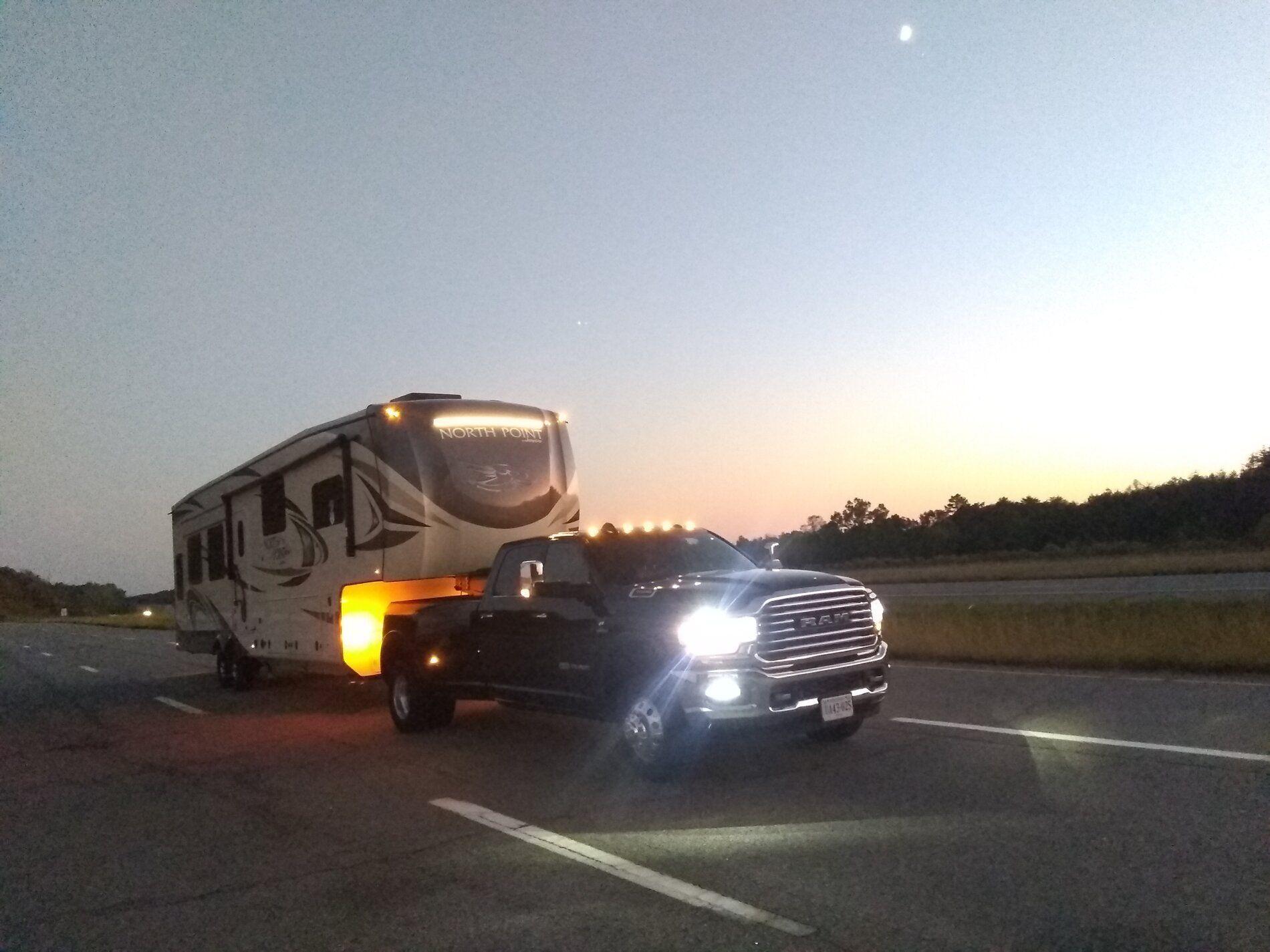

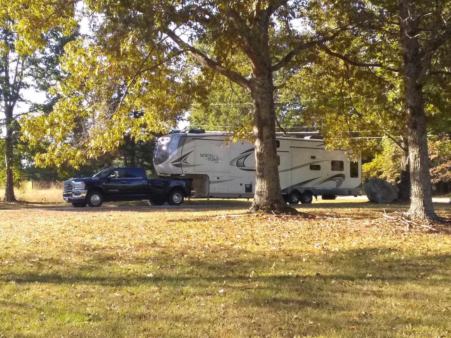

Thanks guys its a rig that was over 20 years in the making and lots of planning and prayers and lots of cash too but it goes up hills like a rocket I wanted to get a truck that could Cruise at 75 all day long if my wife needed to be in a certain area in a certain time to be at a book signing or function.
If you did not Know my wife is a christian author and speaker and we cant drive at 55 LOL.
I will also not be taking it on the Blue Ridge Parkway any more because the trees hang low and hit the AC units all the time I think the Northpoint is 13 feet to the tops of the AC units.

Y'all take some really great pics... Is Cynthia and the kiddos driving a chase car to get these shots?
I think you could do a trailer life spread on buying a truck and an RV.
Have fun and many safe miles...
