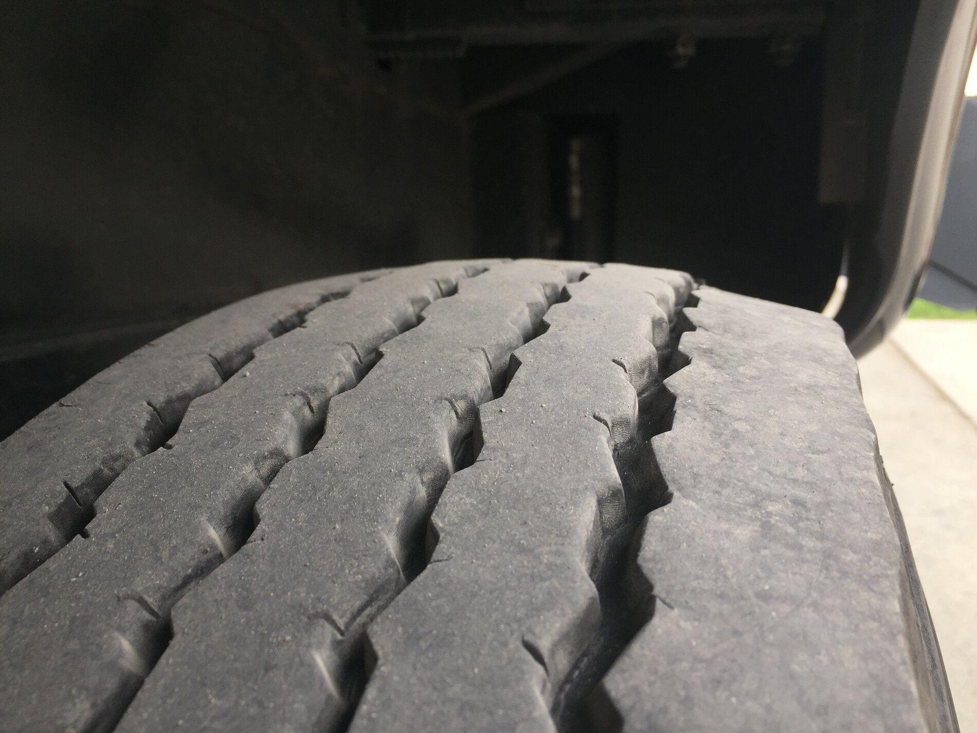

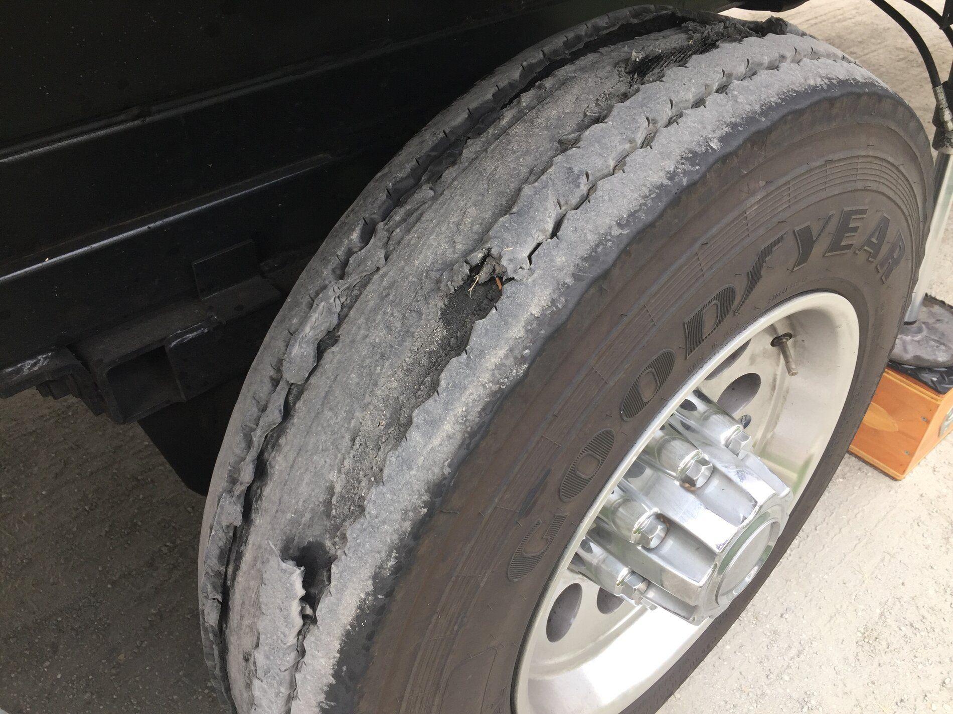

I had one tread separation on my GY "H" tires dated 2015 they replaced all 4. They had a few during that time but since they are fine. Look at your tires if they have the center three ribs starting to look higher than the outer ribs you have tread separation.

Did the tire have tread separation??? Like below?

No tread loss, looks like sidewall blowout. These are Hs. I'm starting to look at Sailuns... good reviews and not bad price. Looked at Michelins and looks like would be over $500 tire. I still have a while so gives me time to get the best VALUE.

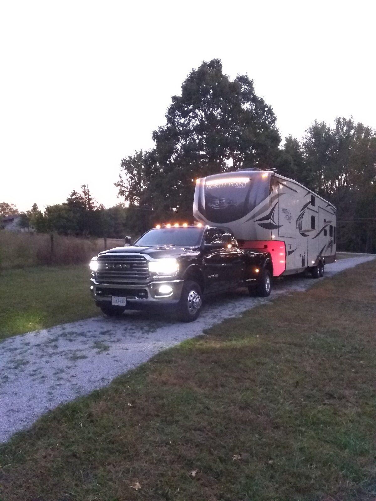

I believe it's a beautiful day in the neighborhood just wanted to send a picture guys I got the Marquee light on on the top of the jayco North point it's a thing of beauty and look at that sunset wow here in Danville outside of Danville Virginia pittsylvania county Virginia.
