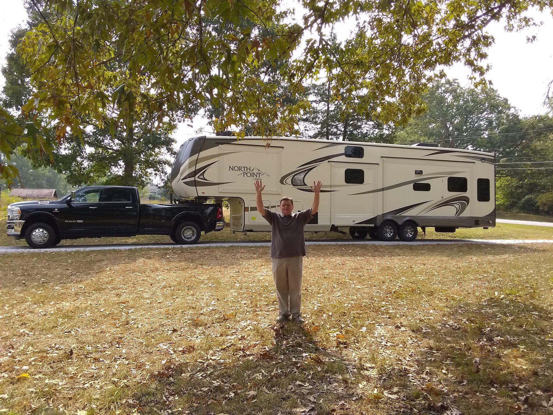

I am here guys here's a picture of me in front of the RV in the pickup truck it's very level I think why don't you guys chimed in with your opinions my lovely wife is going to take a picture of me hahaha.

The point was that by reversing the base it seems to have stopped some of the pogo effect and by reversing the Coupler that seems to have increased the suspension travel on the trailair, also as you guys know I was not a fan of the ALT ride height but since the Northpoint seemed be be a bit higher I said lets just give it a try.
Well it seems all the changes and now having the weight in front of the CA seemed to put all the pieces in a good chain so to speak and I must say I have not taken it off Alt Ride Height since yesterday and am now a fan of ARH so my search has ended lol one thing that does scare me is I think I have about 110 PSI in the airbag but its up to the line on the Trailair and it moves up and down smooth as butter I just hope I dont blow up the airbag lol that would be a real BLAST.
By the way does it look level in the photo from this morning I can lower it to the next hole on the aluminum ball.

Looks a little high in the front? Not the best angle to tell. Lower one hole
