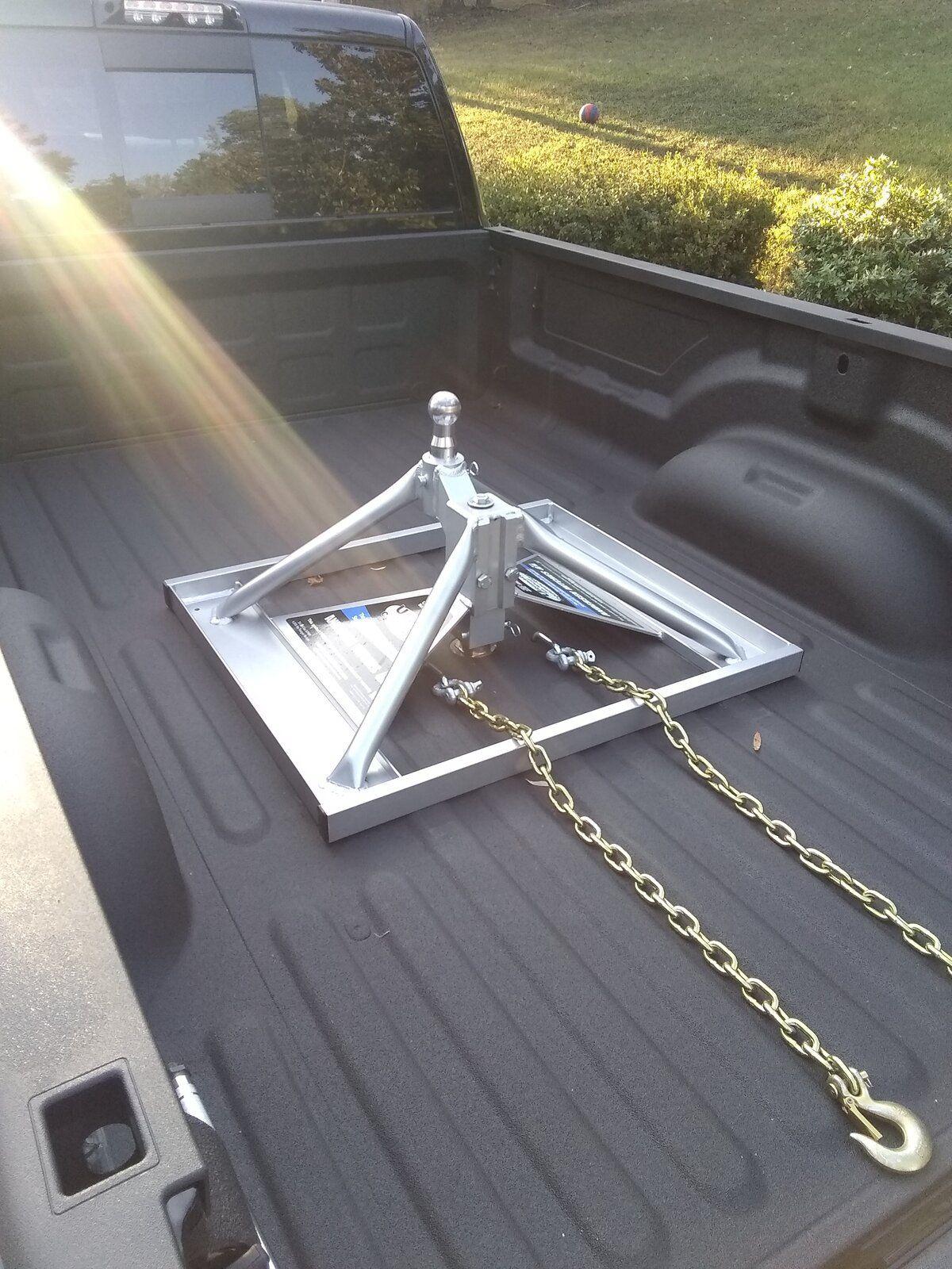

This morning at a dealership in Utah they had some Anderson products and we started talking about them. The salesman said they never were overly fond of them, but it the only option for some short bed rigs. Since then they have starting selling more pullrite's, which also appear to use a ball???

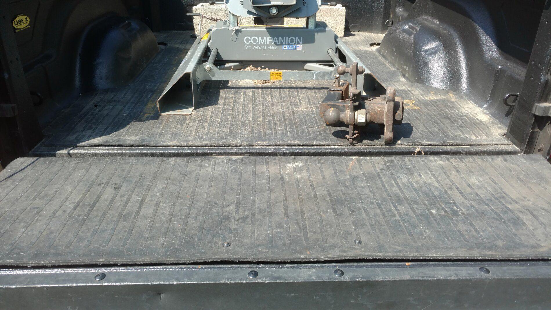

The companion uses the same attachment method as the Anderson but use the truck bed and the turnoverball different in some ways but both use 60 ft lbs on the gooseneck hitch in my case BW1320 Turnoverball.
They are simlar, but not the same.
The RVK3500 has a bolted in shaft that drops into the GN hole, vs using the GN ball.
The RVK3500 also sits on the bed differently.
Both of those might seem like minor things, but they help absorb the fore/aft forces of the trailer differently, and better IMO.
The RVK3500 also has rubber bushings where the head attaches and that will absorb vibrations/movement too.
As John already said, the B&W doesn't use the ball, it has the post on the bottom of the hitch that drops down into the receiver. Once in place the draw down bolt gets torqued to 80 ft lbs.
Also there is quite a difference in the two bases, my RVK3405 base measures 35" x 45", the base itself weighs 215 lb. The head alone weighs 75lbs which I believe is close to double the weight of the entire Anderson set up. I realize the Anderson is aluminum so there is that, but there just isn't much there when looking at the over all foot print and supports. They certainly took a very different approach in the design of the Anderson compared to the B&W.
Ok, I see it now, the Anderson attaches to the B&W ball. Thats just another potential pivot point that can move. Stuart, get the Companion, you'll have alot less back and forth movement that the Anderson has due to all the different potential pivot points. When you have that much weight through the several points of pivot, it will magnify that movement.

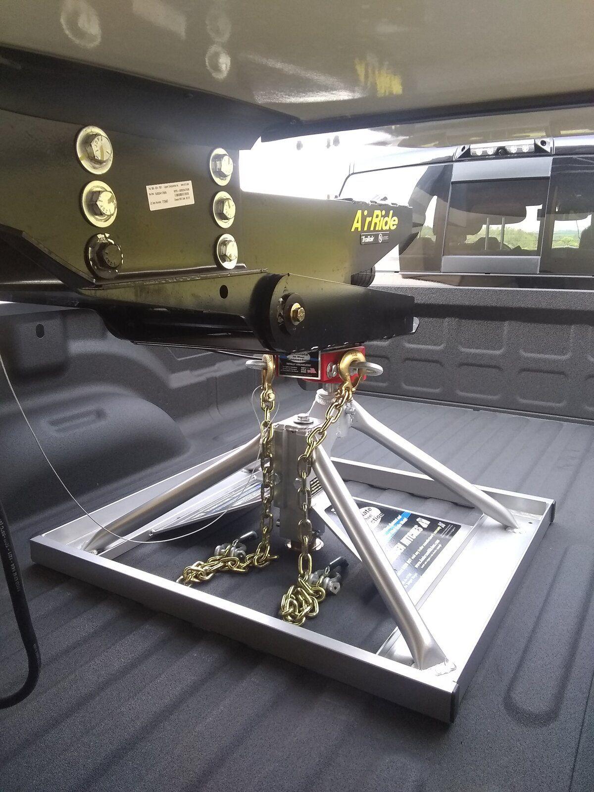

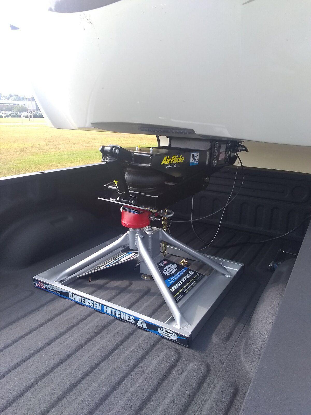

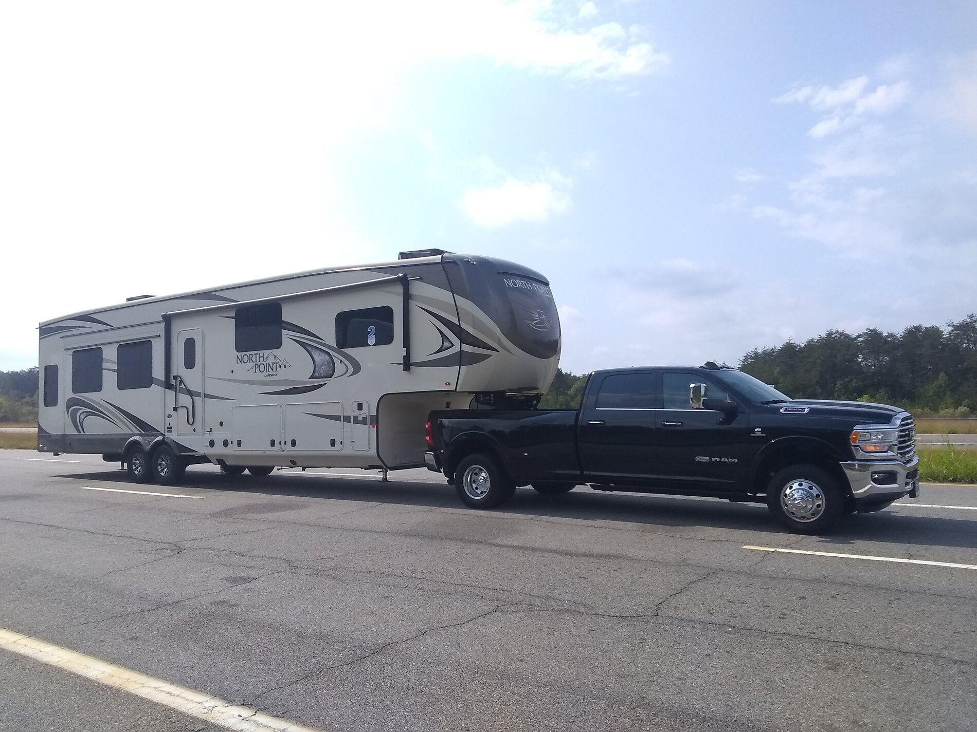

I got it guys I got it it's all great doing great I reverse the Anderson I also reverse the coupler and I put it on the front of the kingpin and the difference is dramatic I'm also using trailer alternative trailer height which is lower and it's riding great the chucking is reduced I would say by 70% I'm happy with the combination at this point it's really really really functioning well yep it really is functioning well so I am a I am in not getting rid of the the Anderson yet because it's working well now so the difference I made by turning around the base by also turning around the coupler on the kingpin now I'm getting at least two and a half inch of up-and-down suspension for the for the pin box and for the trailer air and its outstanding I can't say anything more I'm happy as a clam in the sea.
I am happy to see you did what I mentioned , you did as we talked about ,you got the weight more forward of the axle, plus you gave that trailair a better chance to work. Lots of advice here ,but you did what IMO would help.

The point was that by reversing the base it seems to have stopped some of the pogo effect and by reversing the Coupler that seems to have increased the suspension travel on the trailair, also as you guys know I was not a fan of the ALT ride height but since the Northpoint seemed be be a bit higher I said lets just give it a try.
Well it seems all the changes and now having the weight in front of the CA seemed to put all the pieces in a good chain so to speak and I must say I have not taken it off Alt Ride Height since yesterday and am now a fan of ARH so my search has ended lol one thing that does scare me is I think I have about 110 PSI in the airbag but its up to the line on the Trailair and it moves up and down smooth as butter I just hope I dont blow up the airbag lol that would be a real BLAST.
By the way does it look level in the photo from this morning I can lower it to the next hole on the aluminum ball.
