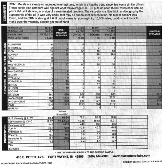

My advice is dump the OE oil get yourself 12 Qts of AMZ/OIL 15-40 Signature Series with their filter. Run it to 15k then change from there on at 15k intervals.
My numbers compare well to the Universal averages of around 6,000 miles.

Do a UOA and you'll see why 15K mile intervals are acceptable.
These aren't 1970's oils.
Stuart, I didn’t get the memo that it’s 15k miles, from the EPA. My Toyota’s are 10k miles, and I refuse to believe that, I change oil every 5ks EPA I believe has their hands in those numbers. My 2019 will be 7500 and that is too long for me.
Even with results like mine at the full 15k and they say I could go longer???

My comment was to reinforce the OE OCI, not promote anything else. @RVTRKN is skeptical of the OE OCI, and one or two UOA’s would be far cheaper than cutting the oil life in half over the life of the truck.
Ok, I’ll drink a small glass of Koolaid and have a UOA done at 7000 miles, but how will I know if it’s good or bad?
I haven't done one in ages, but Blackstone usually had a bit of commentary on the report. TBN was what I first looked at as far as oil longevity. Unless something is out of whack, it was more a matter of looking for trends once you have a baseline, much like us going for a blood test. There is a ton of information to digest, if you are inclined.

That is their job to tell you, but you can post the report on here too.
I prefer OAI testing over Blackstone. I found Blackstone to be less than knowledgeable when talking to them, and they charge more for TBN. When I was fed up with Blackstone I asked the local Rocky Mountain Cummins who they use and they recommended OAI (oil analyzers inc).
If you do choose Blackstone be sure to pay extra for the TBN report, as it’s crucial to oil life.
that being said I’m a big fan of a short first OCI. Personally I’d dump it before 5K miles, then again 7K miles later and then work on 15K intervals. That has to do with breakin metals and such, not oil life.
My first change was at 4.2K, and I’m in the process of my 2nd change today at 11.1K. I’ll run this oil for 15K or 1 year, whichever happens first.

The OCI certainly doesn't have anything to do with the EPA. They don't provide the warranty. 500 hour intervals are the norm on the 6.7 in anything Agriculture and construction. Granted the sumps tend to be a little larger but the duty cycles also tend to be a little harder than a pickup.
I recently saw a new DD8 (Detroit 7.7 liter) with up to 2000 hr interval on the engine oil/filter depending on duty cycles. Again a larger sump and not exactly an apples to apples comparison but the point is 500 hrs/15,000 miles is pretty conservative with the current emissions and engine manufacturing technology.
Like mine???
Or mine, with plain ol conventional oil o_O
