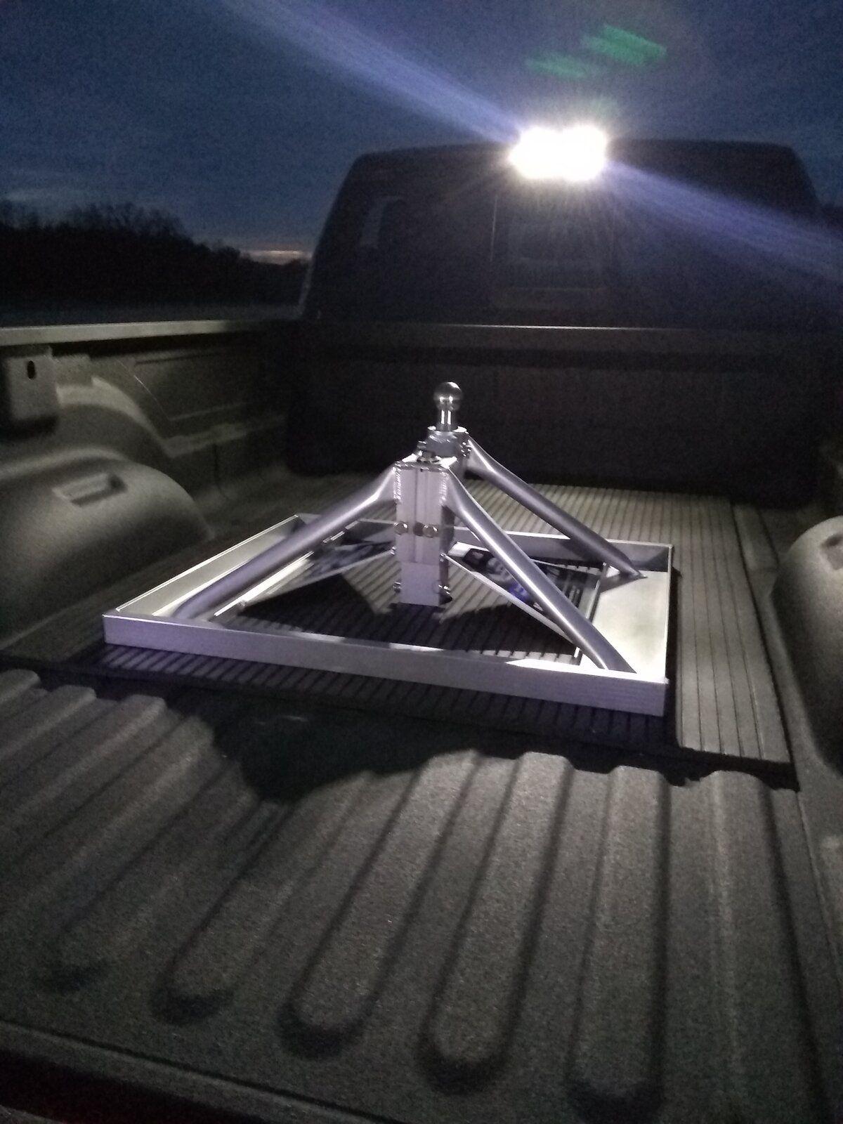

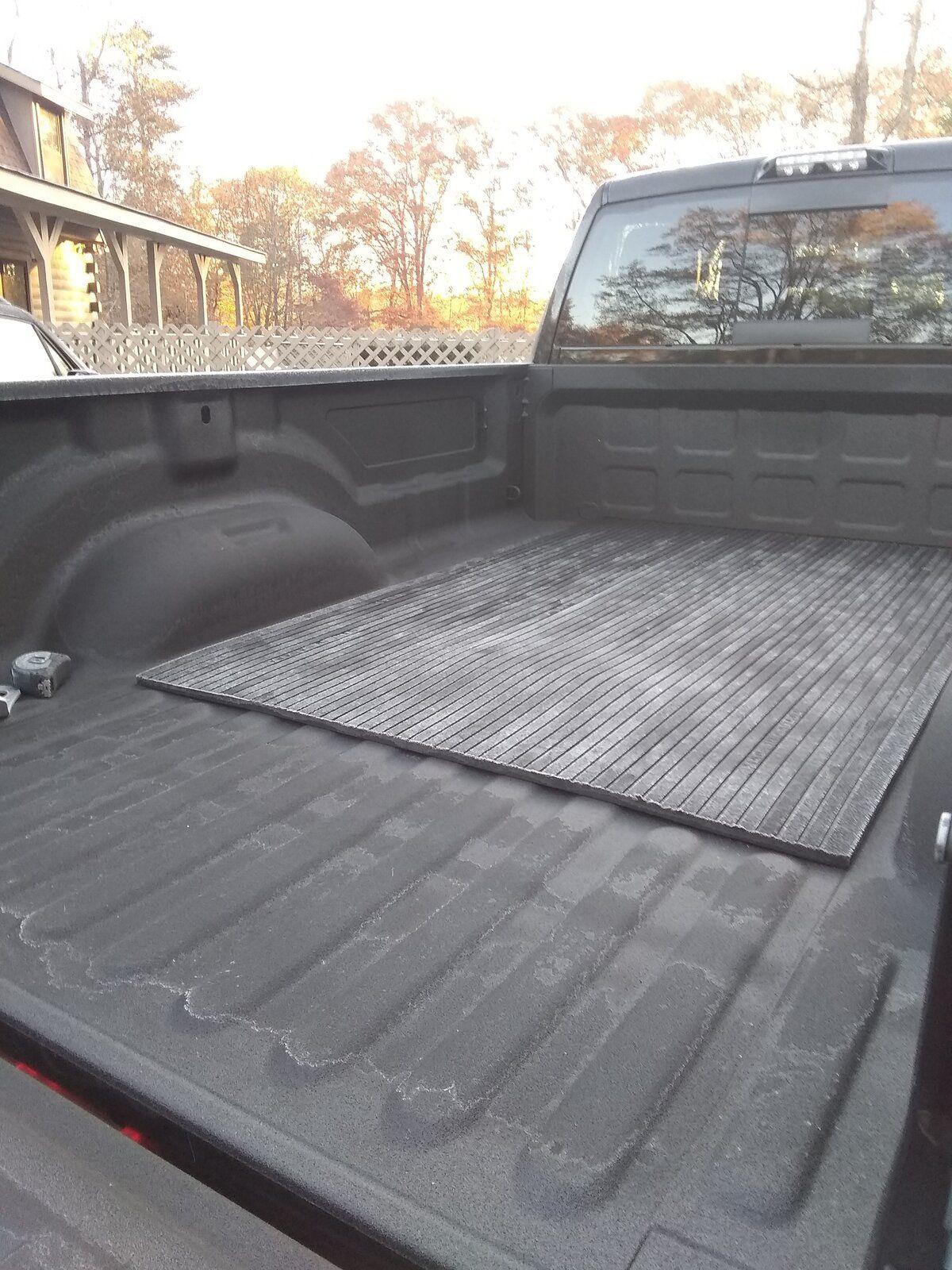

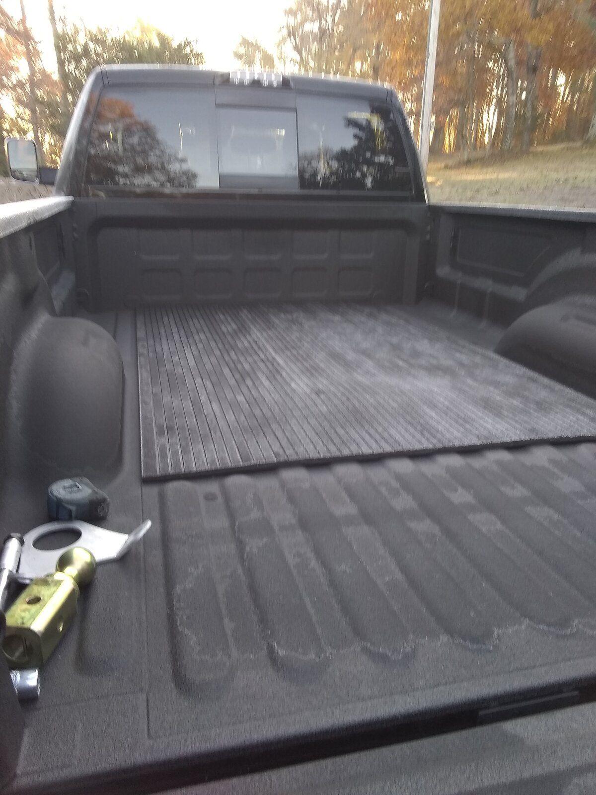

okay I got the horse mat yesterday it's 3/4 inch thick tough tough tough rubber so I've got to drill a hole for the gooseneck ball and then we'll see what happens but yeah I've got the horse stall mats made in Canada it's 48 in by 6 ft so we'll see what happens it should take care of any problems in the future I'm sure and remember I have the Anderson reversed I have the ball forward towards the truck window I do not have it in the standard position because I have a long bed crew cab dually the horse stall mat weighs like a hundred pounds to it's really heavy wow.
Not trying to incite anything, but I fail to see the logic of introducing flex into what is supposed to be a rigid system. The fact that the hitch can rotate around the ball indicates a problem. Yes, suspension parts, and Rota-Flex pin boxes, etc., have rubber components, but that is engineered in, of some known durometer, and is contained/controlled mechanically. This seems like putting a Band-Aid on a sucking chest wound. I'd sooner put a sheet of boiler plate to spread the load out...

EDIT: Finally, I think it's a MISTAKE to mount the hitch on the bedmat… It introduces another dynamic of compression that could further EXACERBATE your problem(s).

Andersen does talk about using their anti-friction pad or a bedrug, thou neither are as thick as a horse mat. The installation instructions do change a little, in terms of when the torque is applied to the ball. Andersen wants the pin weight on the hitch before final torque.

I understand about the big truck big RV guy he uses whatever somebody pays him money to use he could care less I think about what works or does not work he gets all his crap for free and no I wanted to put the rubber mat because when I tighten my the main bolt down to about 70 foot pounds or 6570 whatever it'll be fine guys everything's going to be fine I know what I'm doing the whole problem know and I do not want the ball behind the center of the axle so no I want it turned around I talked to some tech nine tech guys and Anderson and they said it's fine it's a pyramid it is a basically a triangle.

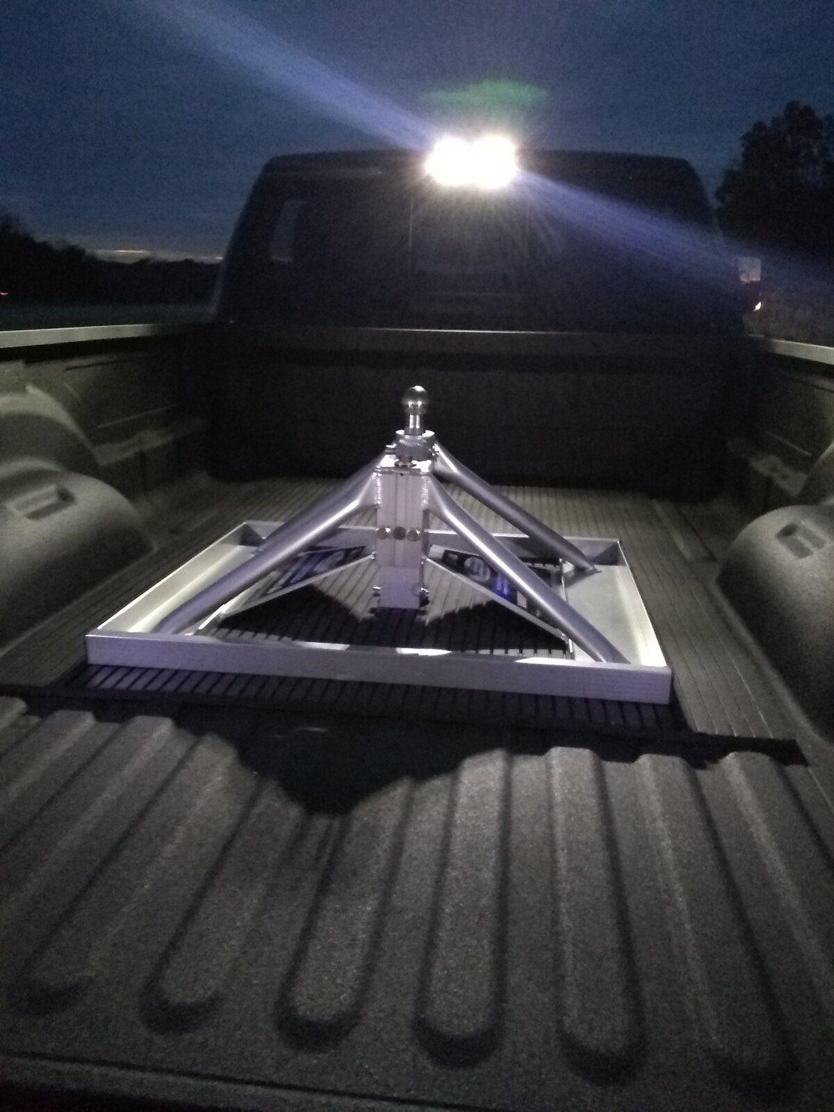

I have said this before and I will say it again the reason that my truck get bed got dented was because I had the electric brakes on light electric and I had an emergency stop situation and it Rock the Anderson a little bit it walked in about a quarter of an inch or whatever and that cause the engine tatian in the bed so long story short now that I've got the electric brakes on heavy electric I'm not having a problem anymore but I don't want to dent my bed anymore that's why I'm putting the rubber there it should help and also it may provide a little traction for the Anderson base because the spray in bedliner is extremely slippery and I know if anybody has really seen one of these Anderson's they're very Stout I'm not sure about the engineering but I have not given up yet if this final piece does not work and get it right I will be getting something else that's just a fact I've got too much money tied in with this but I'm also I'm trying not to be a quitter on the Anderson because I think it's a decent product not the best product but a decent product a good product.
I am not the typical Andersen ultimate connection customer I have a long bed dually crew cab most of the people that buy the Andersen ultimate are short bed six and a half foot bed owners and no I did not want to mount the base behind I don't want to have it behind the center of gravity which is in the normal position at the Anderson comes in so all right guys sorry for the voice to text but I don't have any internet access I'm on the road right now.
I meant to say I do not want to have the Anderson ball rear would of the center of axle by trial-and-error I found out the hard way that my truck and my RV and my pin box by the trail air air ride all rides way smoother when I have the Anderson Ball 2 to 3 in a head of the center of the axle I did this by trial-and-error and it works fine at this point I've got a very decent ride and I've got my brakes worked out and I just figured none of it and you know what maybe this this this horse rubber mat will help if it doesn't it's only $39 no big deal????????

Stuart you simply don’t understand. Anytime you hit the brakes hard with a heavier RV you WILL have bed deflection. Plain and simple ANDERSEN is relying on the top layer of the beds corrugation to hold the base solid.
You simply made the damage happen sooner than later!
I understand what you are saying perfectly well yes I get it there is deflection also the Anderson base the aluminum base can slide on the truck bed it could maybe slide 1/4 inch or whatever and that is a problem I understand I've already come up with a way to mount it is quite similar to the BW but it would require to weld something to that BW gooseneck ball and Ash after that ball of steel shaft it's it's somewhat involved.

Andersen does make the bed shaft that would reduce a lot of the movement, but it's designed to work with the OE GN hitch and not the B&W.
As long as you clamp on a GN ball there will be unwanted movement... If its moving 1/4" some is VERY wrong. I'll bet your damage is coming from less than 1/8" movement... just repeated movement.
Did you torque the hitch with the pin weight applied? If you did not you will need to do that before towing otherwise you will get more movement with the mat than without.
