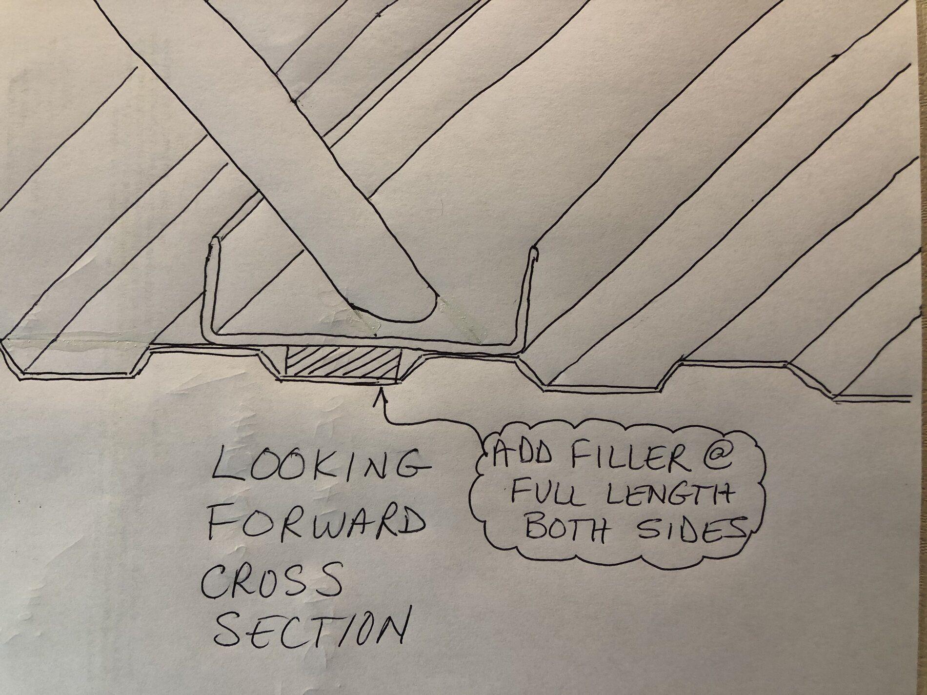

The matt will still put MORE pressure on the high ridges than the low ridges of your bed, but now introduces potential for more compression AND more leverage. The ONLY real solution to better distribute the weight of the hitch on the front and rear is to install ridged fillers that would basically double the surface area and support front and rear.

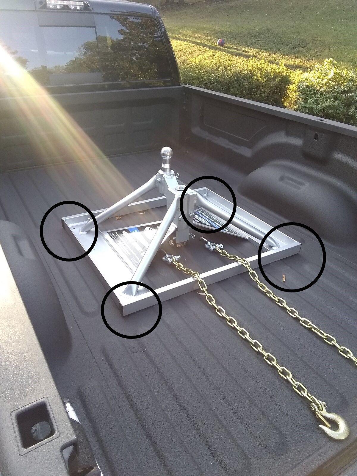

This may be falling on deaf ears, but pics of hitch in bed reveal hitch isn't supported on the corners due to interruptions in the ribs on the truck. Appears to be the same rear facing and forward facing looking back in chapter 8, page 102 of this book.
EDIT: Revelation, those GAPS on the bed are where the PUCK go, when equipped.
MORE EDIT: CUT THE BEDMAT INTO LONG STRIPS AND USE AS FILLER SUPPORTS IN THE TROUGHS BETWEEN THE RIBS FOR BETTER SUPPORT.
Just saying that the multiple leverage arms in the air pin box, the hitch adaptor, and the hitch itself plus the corner areas of the hitch, plus less than half the contact are of the bed (every spaced rib plus the missing ones each side corner) could cause undue stress and possible bending of the bed. If any of the leverage arms increase, we could have greater deformation of the bed, like adding a thick bed mat that crushes or compresses under extreme torque (stopping). Lots of dangerous forces here.

Incredible. I state some facts backed up by a VERY NICE DRAWING :D and then it's OH POOR STUART.

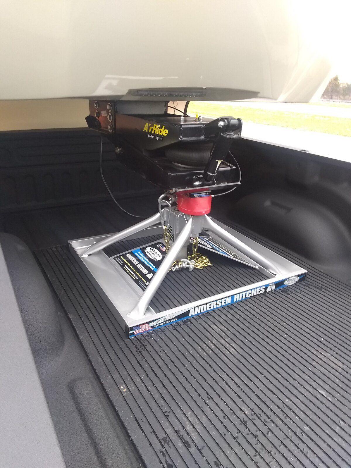

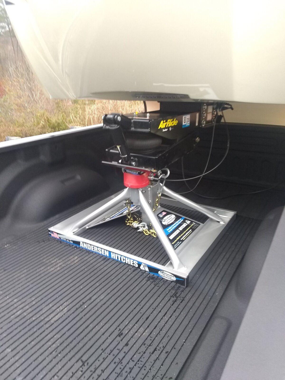

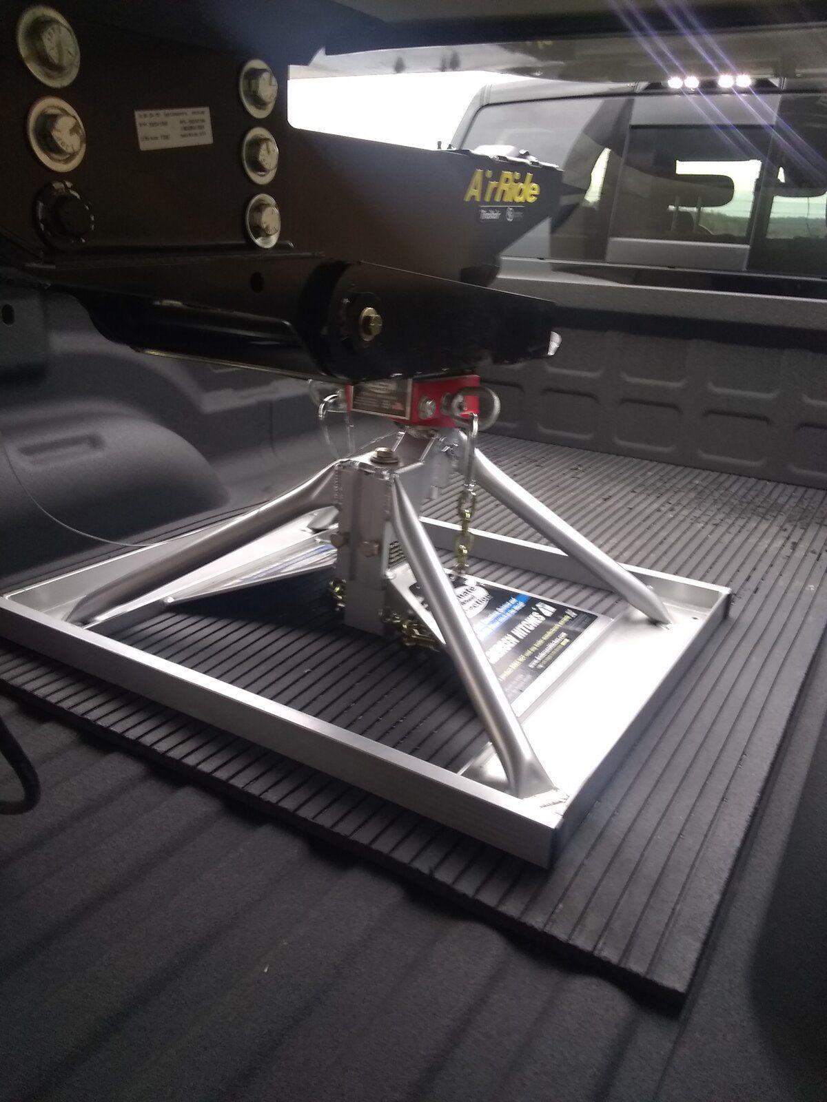

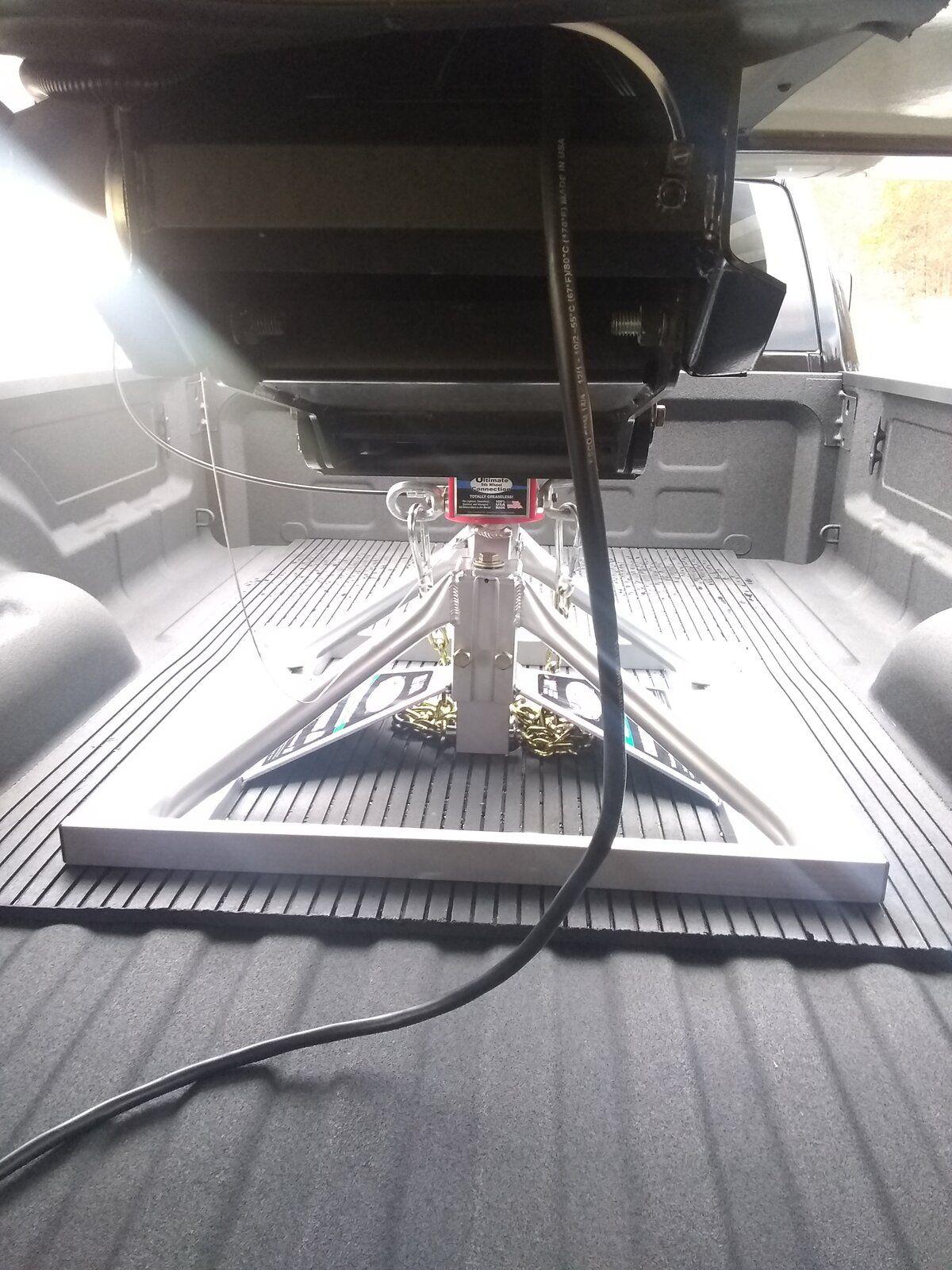

I understand all your points guys all right well here's the pictures it's finished see how it works now and I understand about putting the pieces of rubber around the four corners I get it I understand it no problem at all again if your brakes don't work right it's going to overstress the Anderson anyway you cut it anyway you slice it and anyway you put it so I think I'm a little better off now with brakes that work or at least work very well but yeah here's a couple pictures enjoy.
