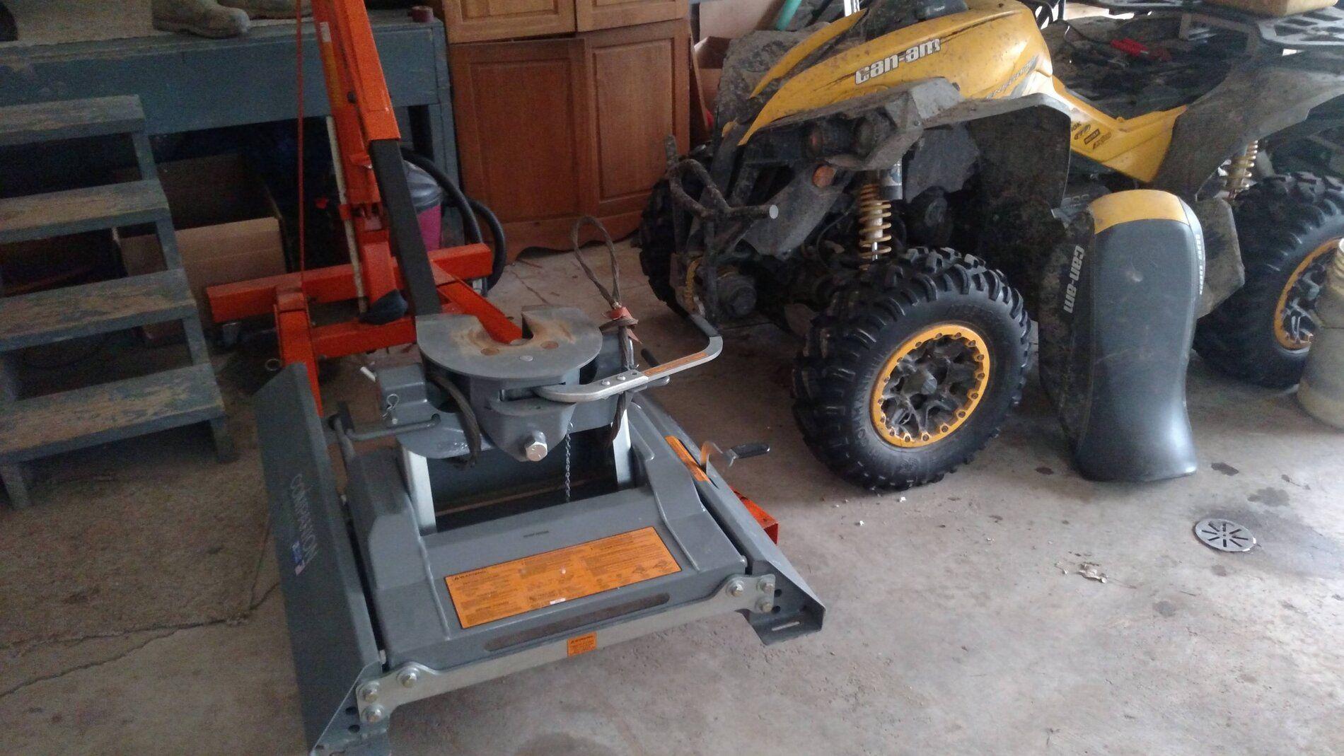

I've only got 3 seasons on my Companion but it has not put so much of a scratch on my bed...at least not that was already there. Being I bought it used it was missing one of the two teflon looking bed slats or shims as some refer it as. The last owner advised I should buy the missing prior to use but we were committed to a short trip the following weekend so I went ahead and towed without either installed.
3 seasons later it's still being used without with no ill effects, although this past summer I did add a rubber bed mat from my old gen 2 long bed over top of my Line X. So now the hitch sets on top of that.
Day I brought her home. You can see the slotted hole on the right side of the hitch where the bolt is supposed to hold the teflon slats. Slotted for adjustability.
It is no coincidence it is sitting on the legs of my engine hoist.....;)
A fella has to have a back when he's done unloading his hitch ya know :D
