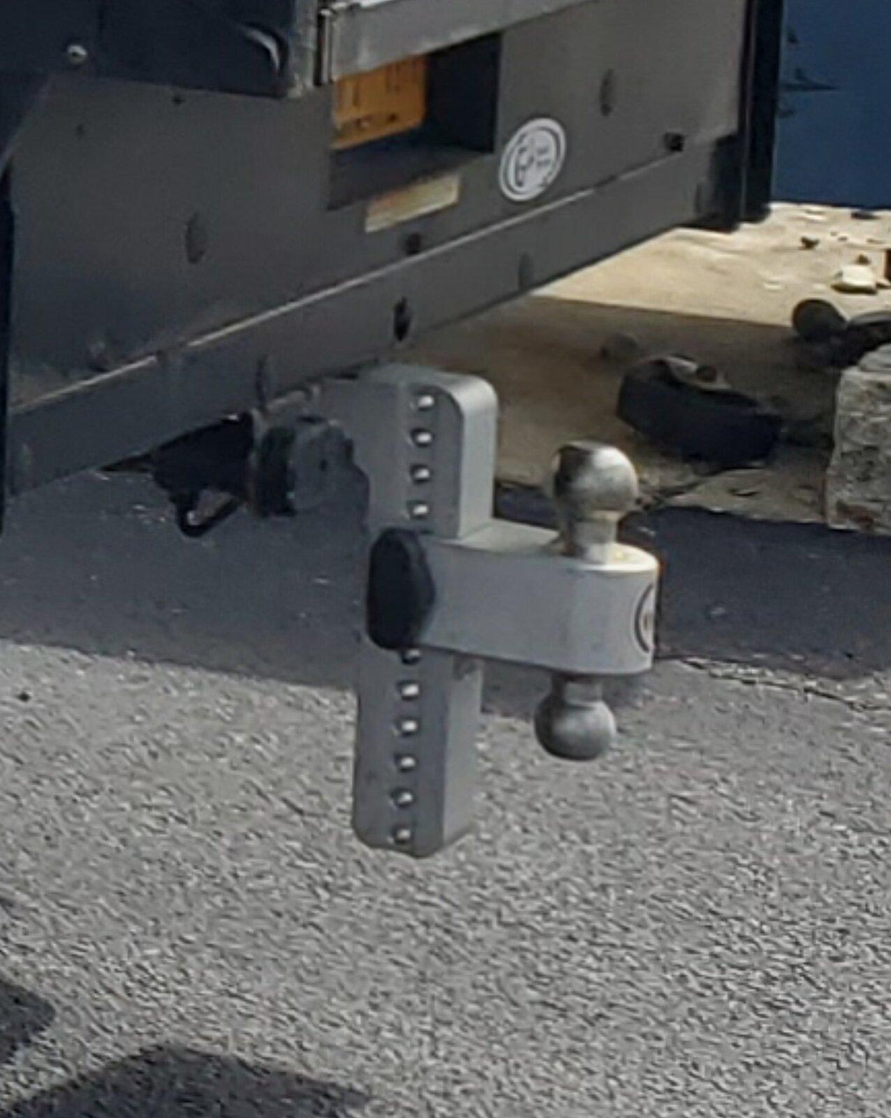

The main point I was trying to make, is upgrade your ball mount. You have a class 5, 2.5" receiver, take advantage of it and get in the 15-18k range. You are hauling commercial, you don't know what you will be towing next.
Trucking needs all the help it can get because what can go wrong at some point will. If you are on top of your business you will try to mitigate that as much as possible.
Again, it needs to be adjustable or carry a bunch of different drops so you can keep your trailer level.

If you check out Weigh Safe ball mounts they are pretty nice 2.5" units, also Anderson has nice 2.5" units, they don't do the WD set up, but those are pretty common, much different technology then back in 98 when you had your accident. Can't really compare the stuff from back then to today.
The 2.5" mounts take out a lot of slop that the adapter adds in.
Mine was like $135 for a weigh safe with out the scale, think it was 7.5" drop.
But Anderson has nice ones as well.

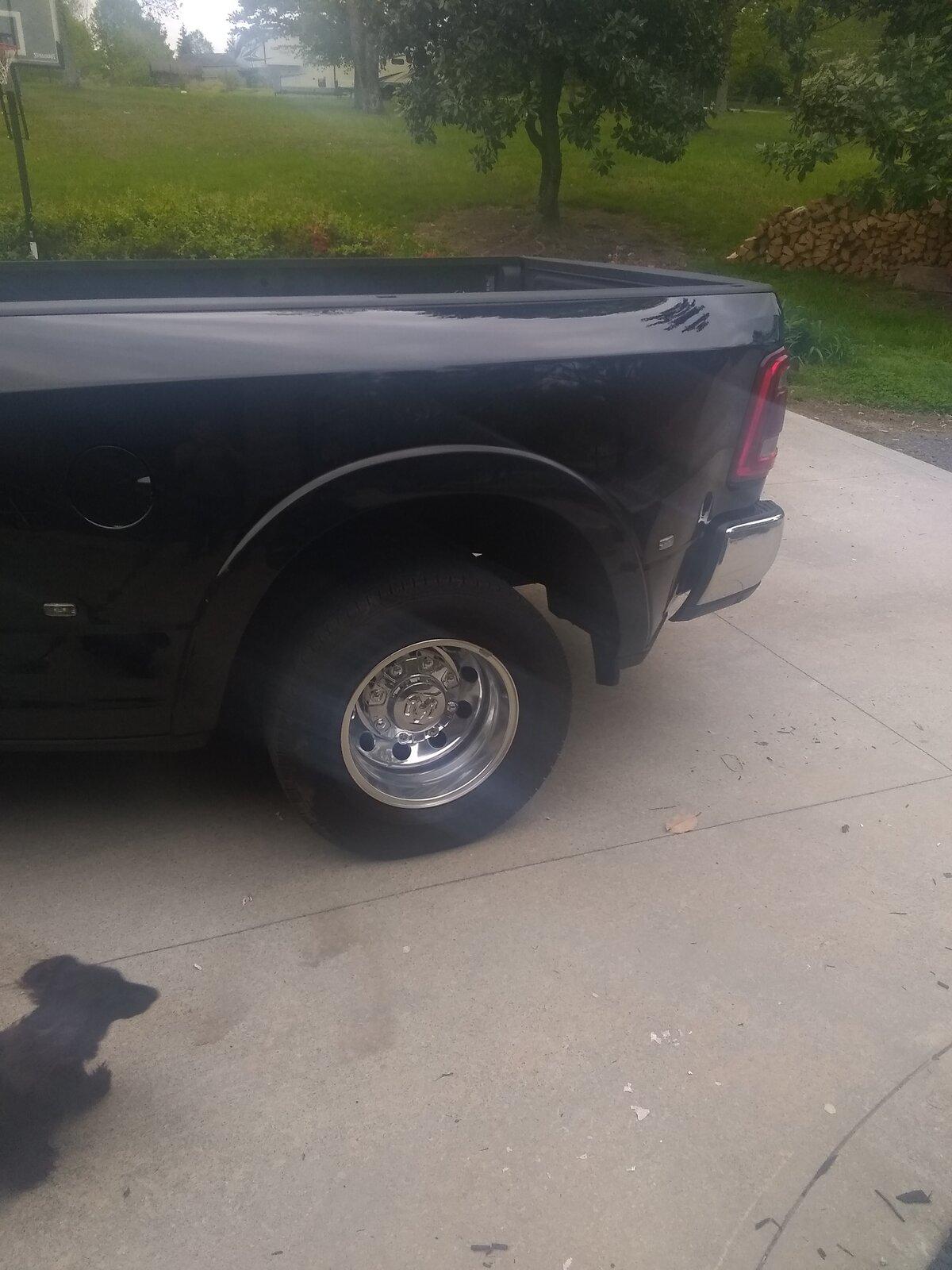

Ok I now have the tires at 32 psi on the back and 80 psi on the fronts still riding a little rough but better......I also got the air ride fixed they said that one of the lines had gotten loose however I'm wondering if maybe I had too much weight on the rear I had some of those concrete blocks in the truck bed so it may have been at like 4200 pounds but I believe the load capacity on the truck with occupants is 5210 lbs.

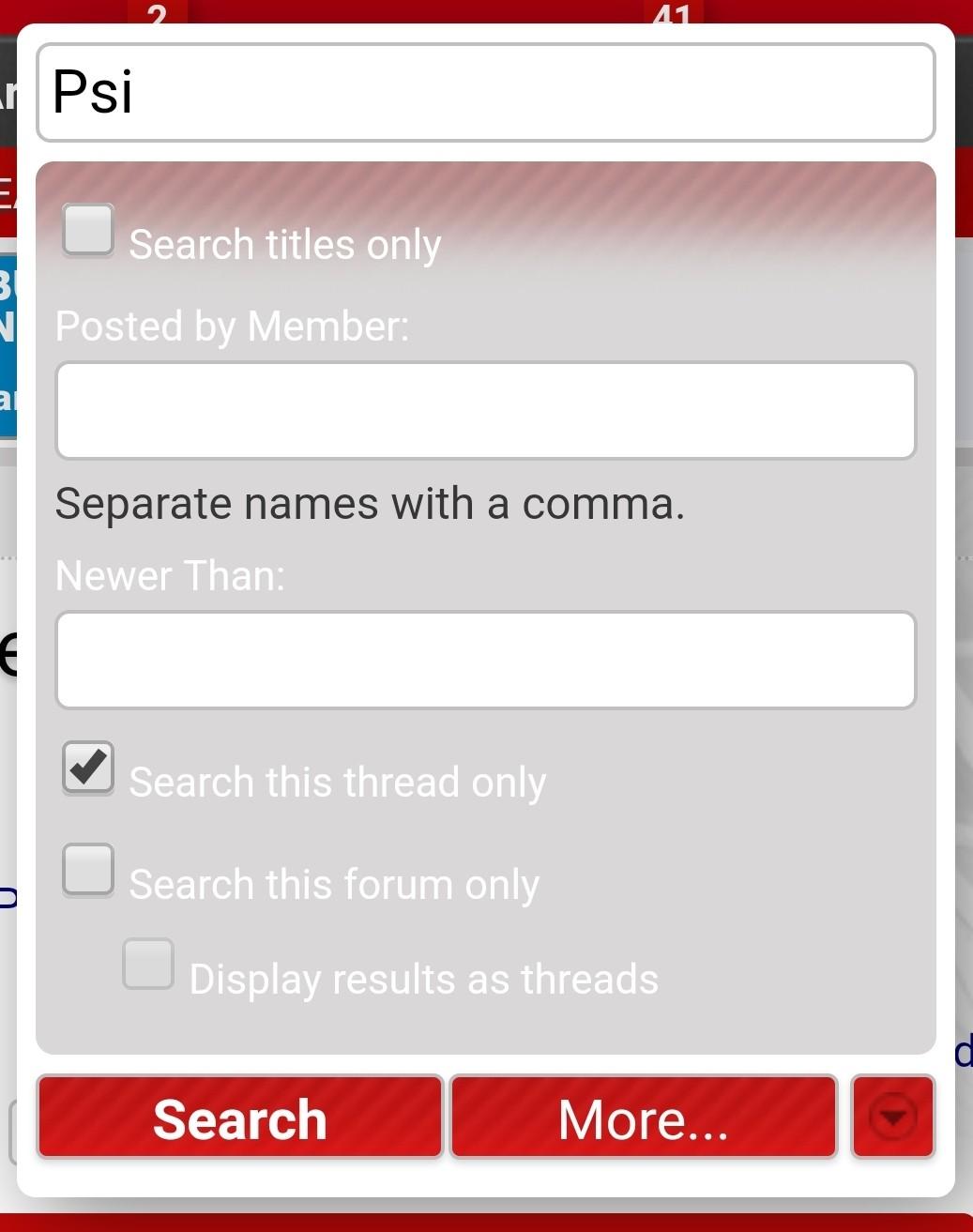

Search psi and select this thread only.
Your post #116 on page six has a bunch of info.
Just making it easy for you to find the info, wonder what non-political technical thread has the most entries?
@TDRAdmin4 is there a way to sort by thread replies and see the top threads? This thing has to be up there...
https://www.turbodieselregister.com/search/841878/?q=Psi&t=post&o=relevance&c[thread]=267350

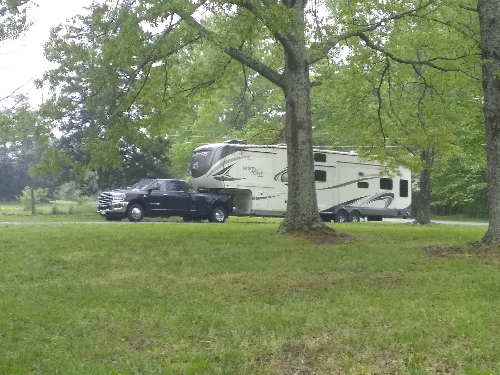

I can't believe it well guys the beast is ready to go the 2019 Dodge ram 3500 turbo diesel with the 410 rear end and the aisin transmission is ready to go so to Florida we shall go I'm hoping by Monday I think which is the first right now once the first next Friday alright we'll figure it out hope everybody's well.
