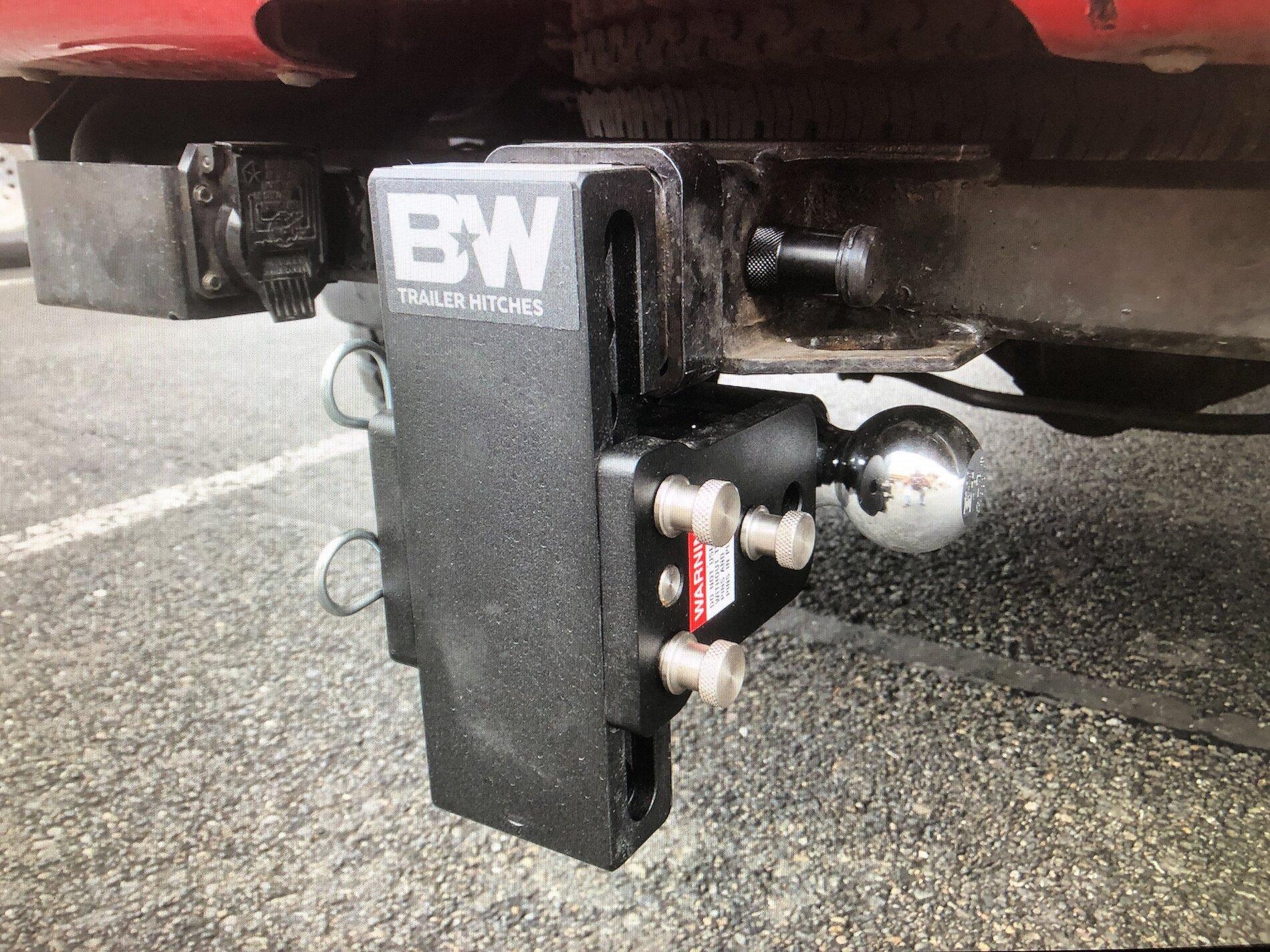

As a commercial RV transporter, I would upgrade your ball mount to match the 2.5" receiver. That 2" 3 way ball mount is probably rated about 10k and is non adjustable.
This equalizer hitch is only 2" but you get the idea, one in 2.5" would be great and is adjustable. You want to always have the truck/trailer combo, as level as possible.
Those are not safe when you have a 9500 pound dually and not necessary.

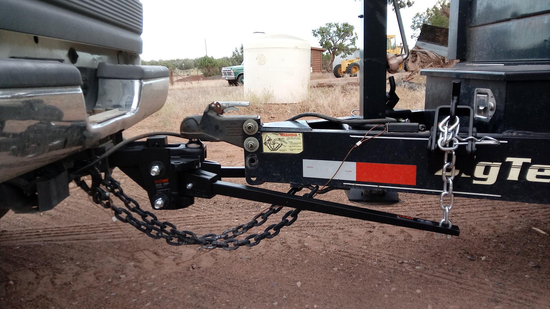

in 1998 I was pulling campers and I had the weight distribution packet package like you're showing their however it was I believe it was a Reese type and it actually close to me or it was a partial cause and be having a rear-end accident where I rear-ended somebody because it literally unweighted my rear wheels when I was coming to a stop so I don't believe in them I believe they're unsafe I have a background in engineering I do know what I'm talking about but not before a lighter way truck will work but in essence your cantilever against the ball and the ball is you having leveraged against the trailer lifting the front of the trailer up a little bit and lifting the back of the truck up a little bit I don't believe in them but I think they're not safe.
Also I have Auto leveling air ride suspension it's totally unnecessary.
when I looked at several of the RV companies to work for I look for a company that did not require that I used to weight distribution package and I know Anderson does cell one but it's nowhere near as strong as what you're using as far as the ability to lift the rear of the truck and the front of the RV up bike and levering with those chains it's just the way it works it's physics it's a cantilever.

Auto Level and DRW have Zero, Zip, Nada, Zilch bearing on what a WDH does, but whatever helps you sleep at night.
Guys like @NIsaacs have forgotten more about towing trailers than you will ever learn, especially with that attitude you’ve shown TDR for taking advice.
I am a FAN of weight distribution when it's NEEDED! IMHO hauling little RV's is's not needed. Now if the recommendation is to help you with ride by essentially making the RV and truck "ONE" then that's something to consider.
YES the rear air ride keeps the truck at the same exact ride height with or without the load.
Stuart I hope you ARE using ALT ride!!!!!!!
Now as far as a QUALITY setup I HIGHLY recumbent this. I "THINK" it's available in 2.5" also.
This thing is NOT cheap but has PLENTY of capacity for anything you will haul. 2 and 2.5" ball size on this.
I bought the 2" so I can use it open my 01 Sport and 15 DRW.
Sorry do what inform you guys you're wrong and I don't care what the other guy says the State of Florida did they a investigation into the accident that I had and it was partially to blame because of the weight distribution package the weight distribution bars that leverage against the hitch and lift the front of the RV and lift the front of the truck slightly sorry you're wrong I've got the crash dummy test on this one and the investigators that did the investigation at the time you're wrong.
For a truck as big and as heavy as mine it doesn't do anything and actually in my case it actually added to the accident because I was not only able to stop appropriately because it lifted my rear wheels off the ground there were no skid marks for my rear wheels at all in the accident that I had.
Sure maybe for a little you know a little 1500 or 2500 yes they may be necessary but not for a dually that's 9000 some pounds okay just my opinion and opinions are like A$$holes everybody's got some.
