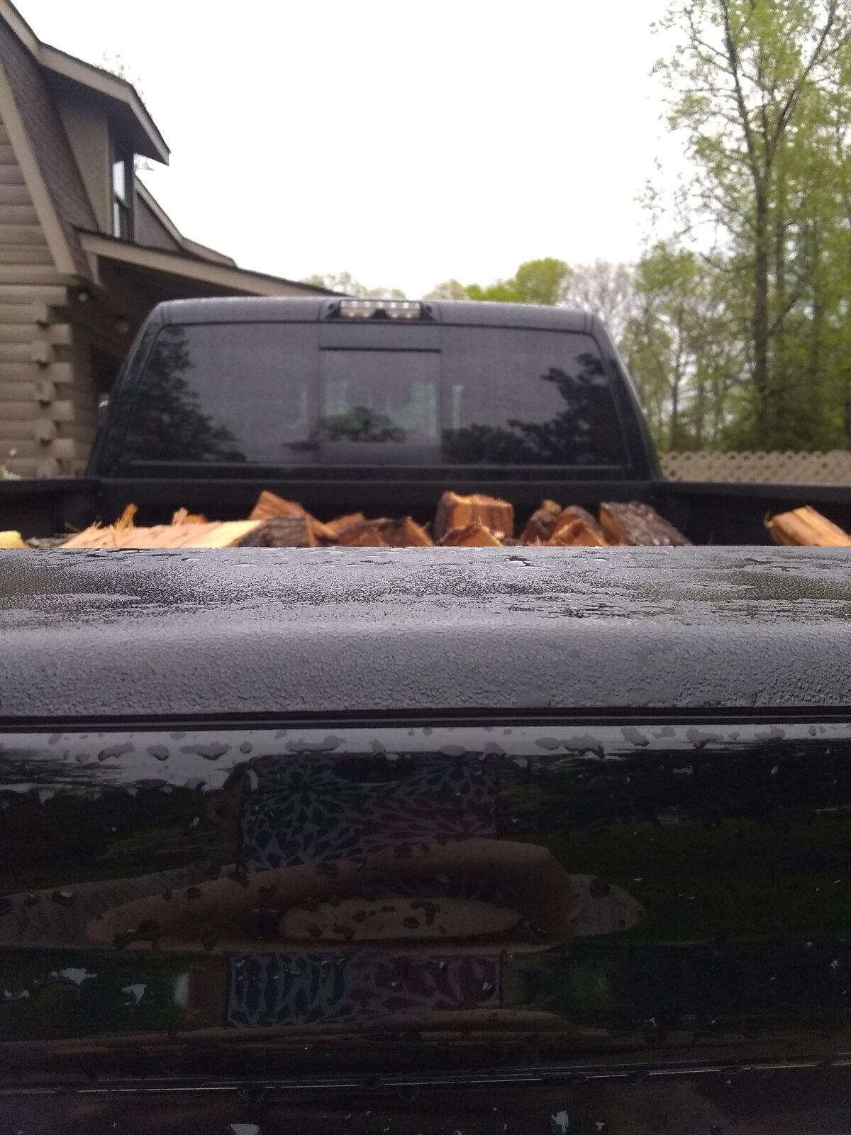

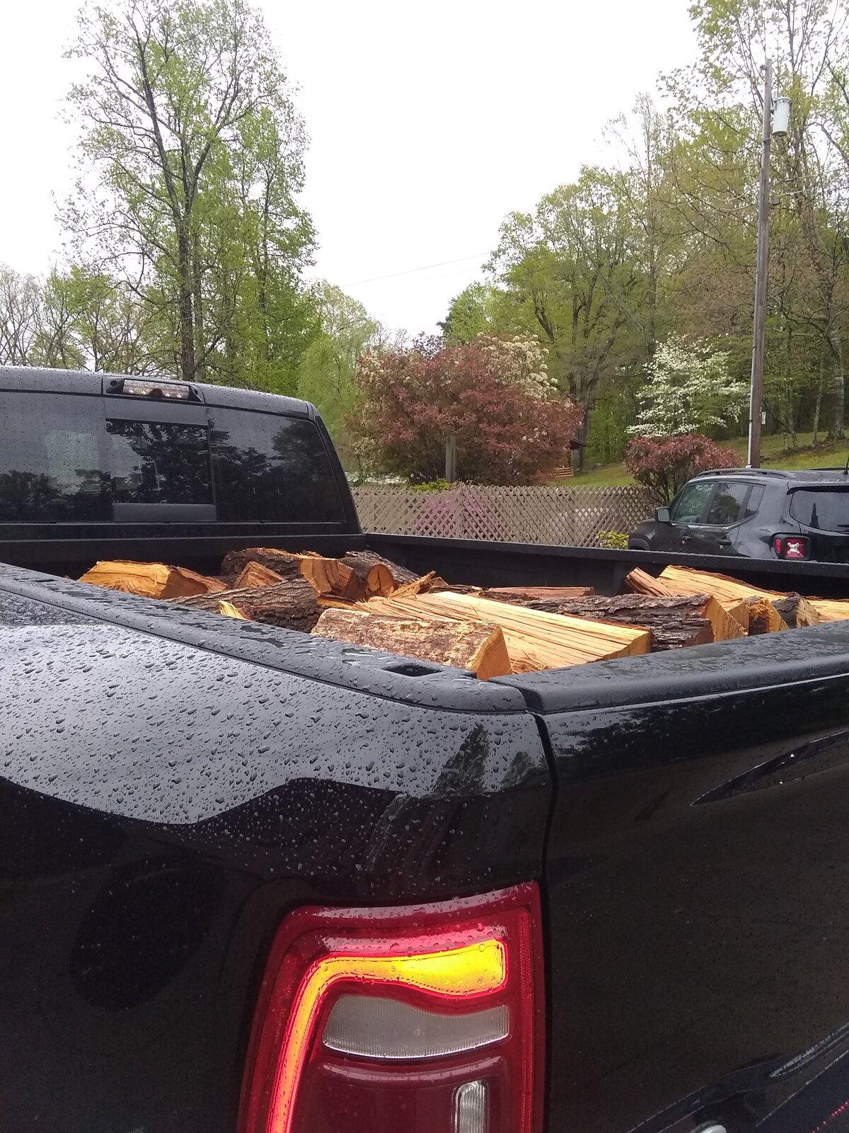

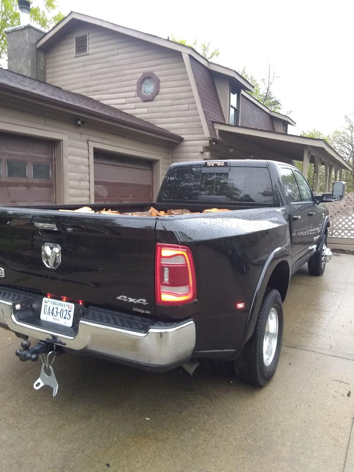

Nope just floating to make sure the pieces of wood will fly out and hit all the other cars and cause all kinds of accidents and damage and stuff I just want to make sure that happens on the interstate at 70 mph.
The concrete blocks are tied down and the wood is all wet heavy red oak and will not come out of the truck bed unless I flip the truck over.
Not that I care what you think but nothing in my truck bed or truck just flops around ever!!!!!!
Remember ignorance can be taught youth outgrown drunkenness sobered but stupid is forever.
Whoa, easy there, Stuart! You've come to this forum seeking advice and I think this is the best place for it. When you talked about the stuff in the back, my intent was not to imply you were ignorant, but was a genuine concern. I have a friend who is a retired highway patrolman. One time, we were talking about some of the things we see in the back of pickups and he told of an accident he worked where a pickup ran off the road and hit a culvert. The driver had a handyman jack unsecured in the back. When the pickup hit the culvert, everything stopped suddenly, except the jack. It came through the back window, hit him in the head, and killed him. So, I just wondered what you had done to prevent a disaster in a similar case. Myself, I'd install a headache rack or do something to secure that load of wood, but that's up to you. Feel free to take my advice, ignore it, or print it out and use it for toilet paper. Have a good day!
Bud
I understand I have a friend who is a Virginia State Police motor commercial vehicle enforcement guy and he looked in the back of my pickup truck with all the wood and the blocks and stuff and he said you're you're good as long as it's underneath the lip of the truck bed you're fine that's what he told me I'm just saying no offense taken just some of these guys on here make some stupid comments me included.

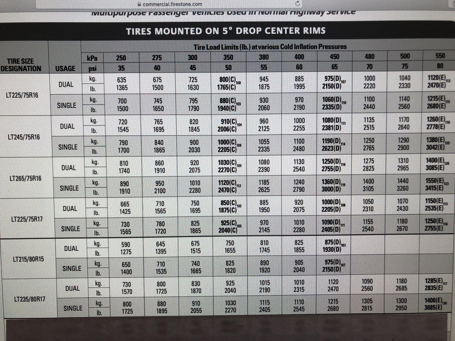

Stuart your tires are on the bottom row. Look under "DUAL".
You are at 1,414# per tire now. Using the chart 35psi would give you a cushion at covering 1,570# per tire or 6,280# with all 4 rear tires.
Lets say you take your 5,660# and add 10% of a 8k TT. That would make your rear weight 6,460#, that's 1,615# per tire. That is right between 35 and 40psi = say 38 psi. So add 5psi for fluff as GY recommends when using charts. You are safe to run 42psi with 6,460# rear axle weight.
What pressure have you been running???

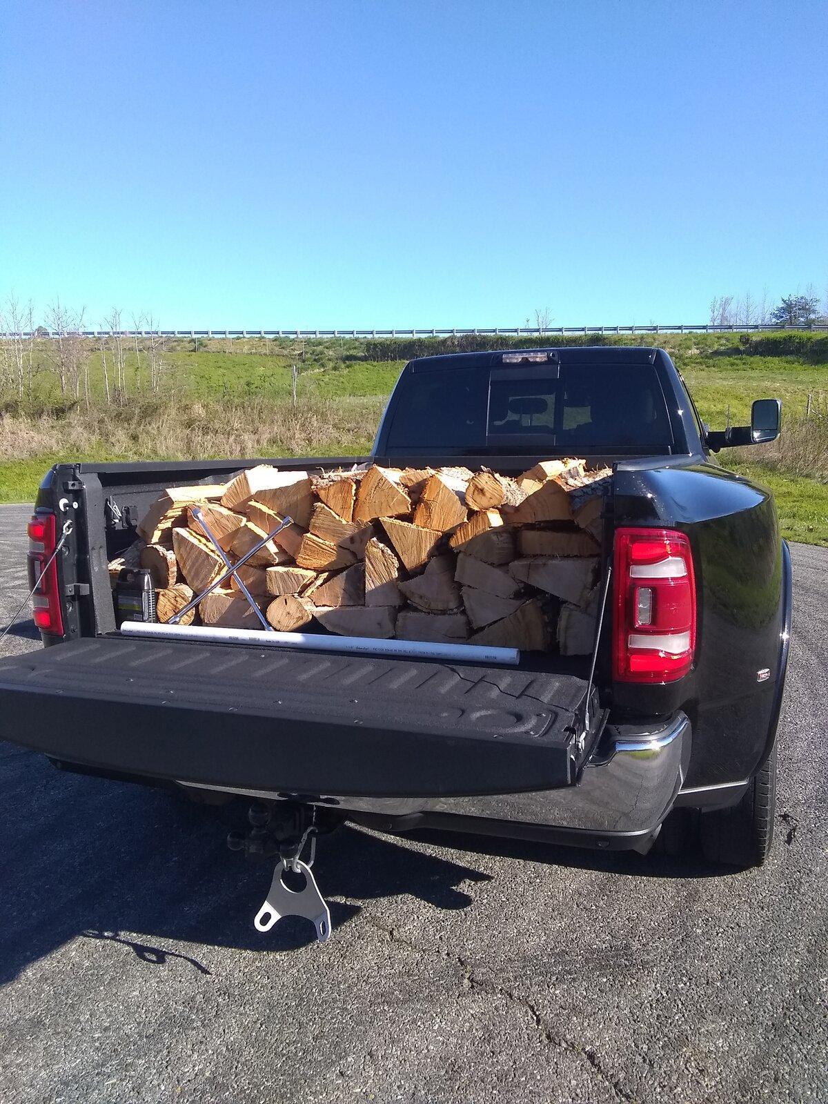

I don't know what you mean by flimsy but the plate that hangs down I used to attach to the chains from the travel trailers and that plate is 3/8 inch plate hardened steel so I don't know if flimsy is the correct word but it is strong as hell and is powder coated so take this flimsy and shove it.
Okay, I will shove it with the flimsy rope buckles.....

I am currently running 50 psi I just looked at the post I think it's the right one the way you asked about what tire pressure I run a always 80 on the front and 50 on The backs right now now that's with the 2 lb thousand pounds of wood and concrete blocks in the back and I will say today it is 60-something degrees and the tires are hard as rock the pack will deny has rock but they're very hard in the back I'm sure I could be no one at 35 PSI and wouldn't do much but my wife will not stand for it.
