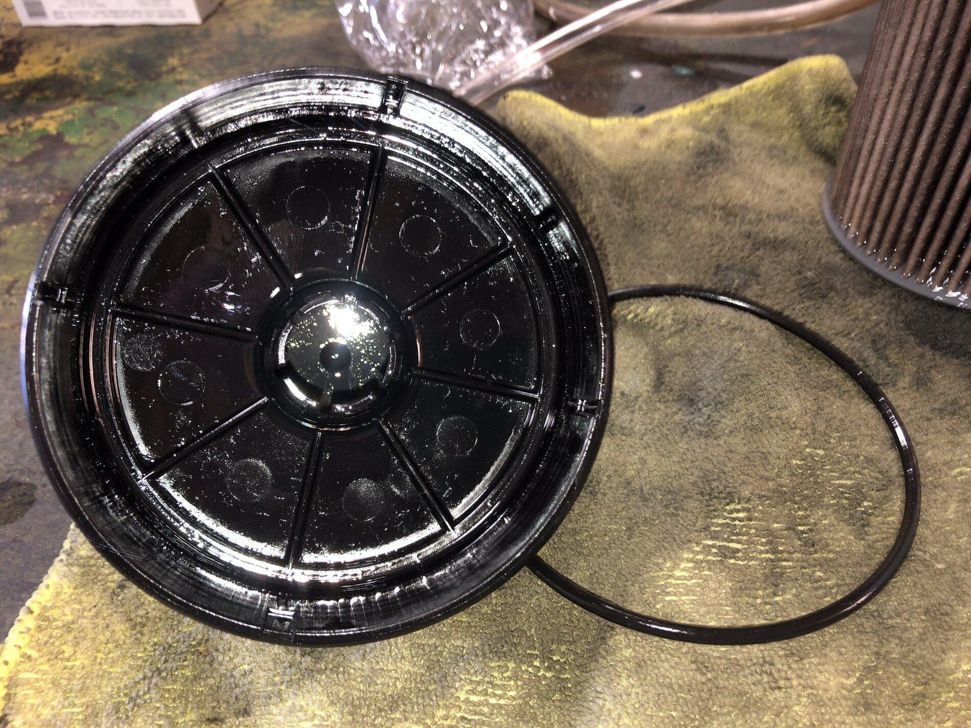

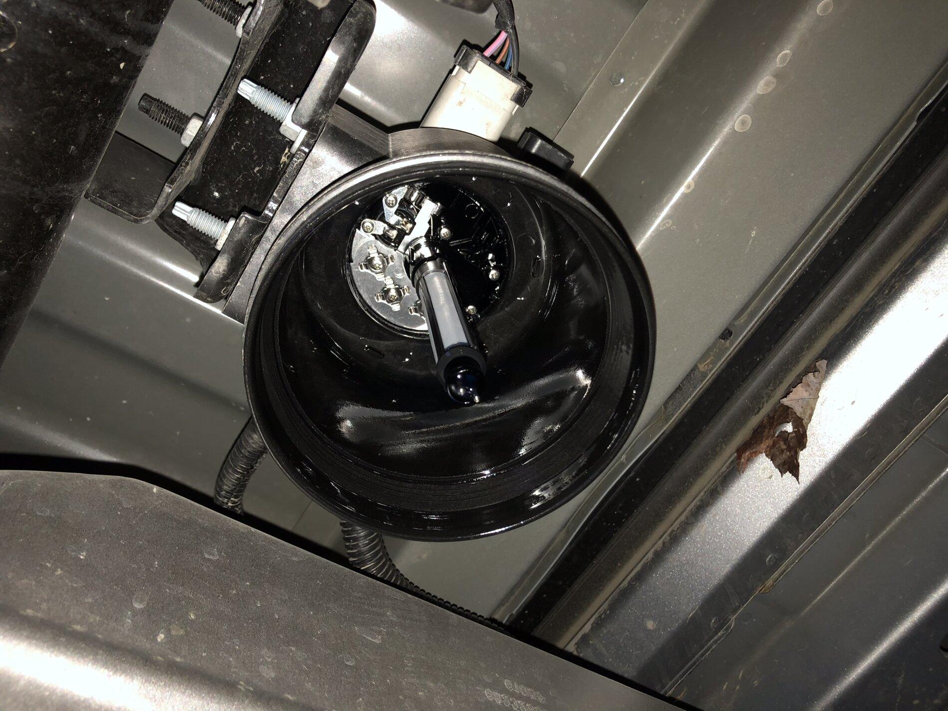

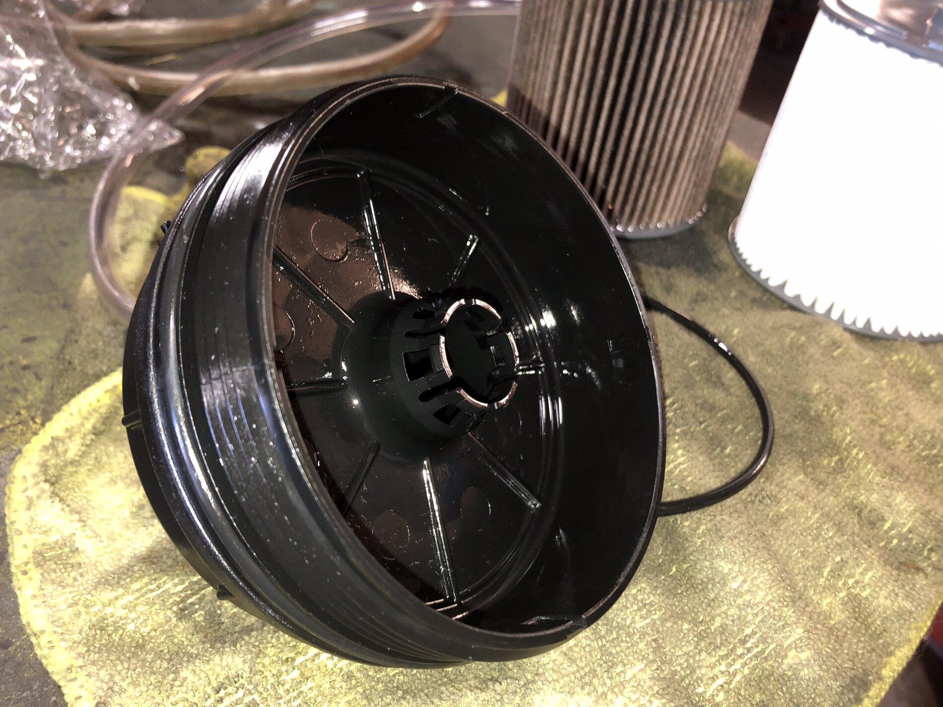

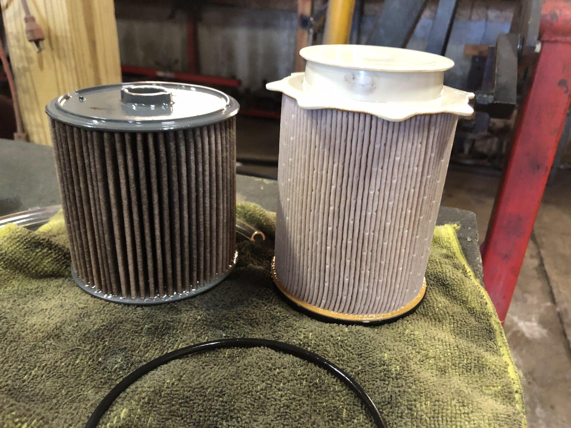

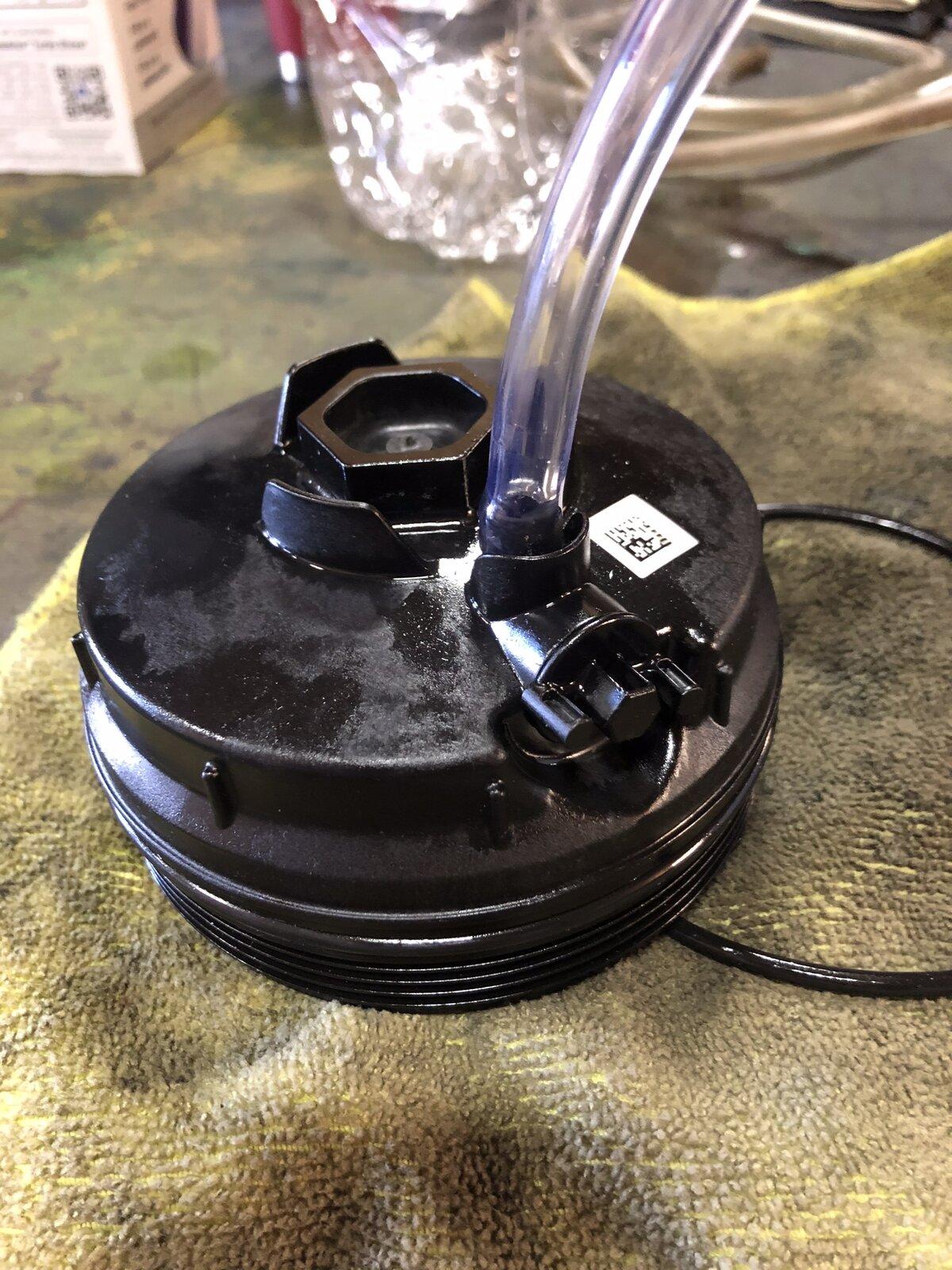

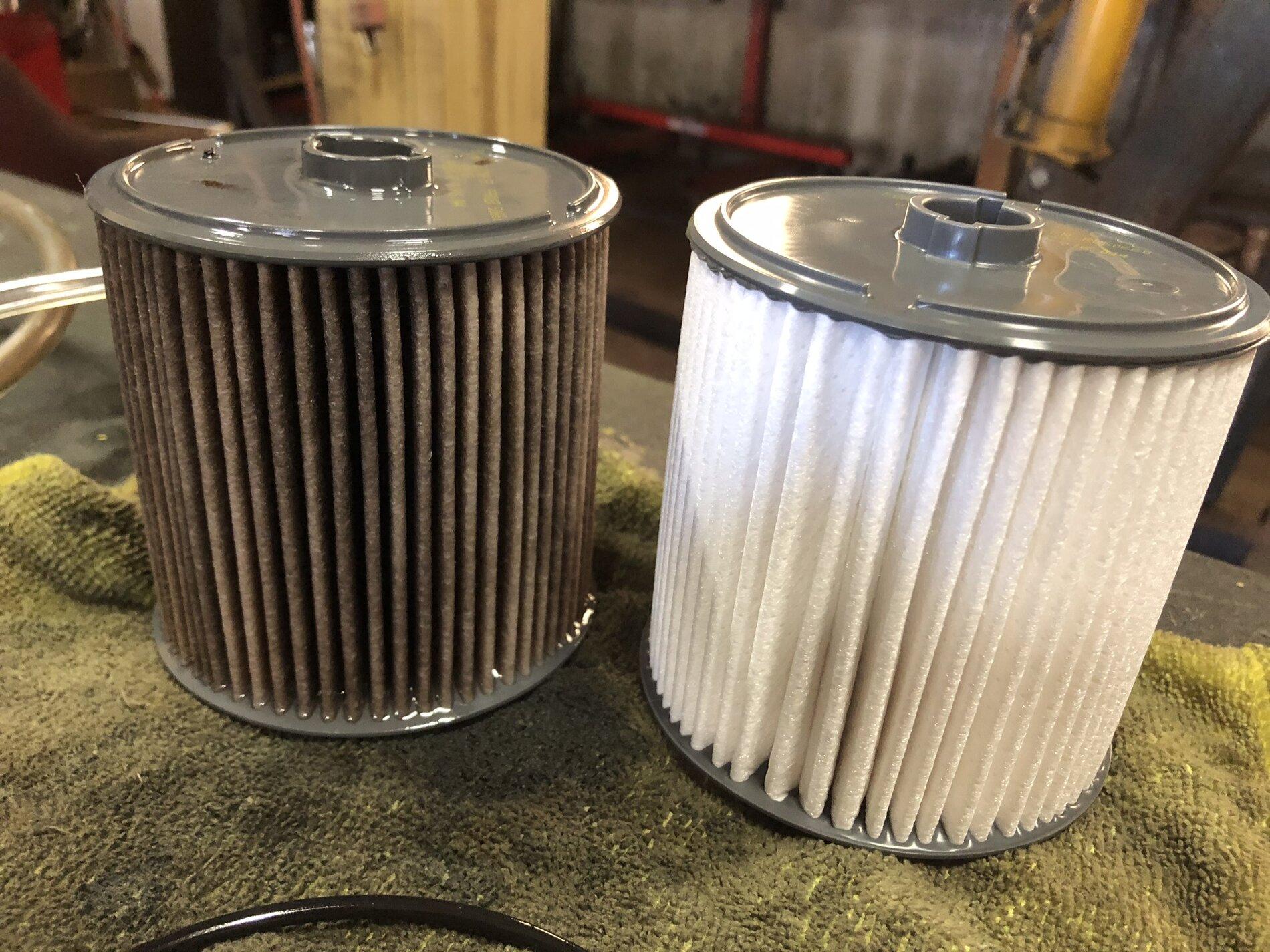

10k filter change. I will usually never hit the mileage, but time out (1 year or 15k). I didn’t really come across any surprises. No huge mess. I let the rear and front drain before removal. Opened the rear drain and opened the housing a couple turns to break the vacuum. Im going to get a longer length of hose for the front so it will hang down by the axle. I did have the usual glitter (visible in first photo) in my frame mounted filter housing, same as OP.
I haven’t changed out a 18 and earlier, so I’m not sure what they used. It does appear they are doing their jobs, you can see the difference between primary/secondary filters.
