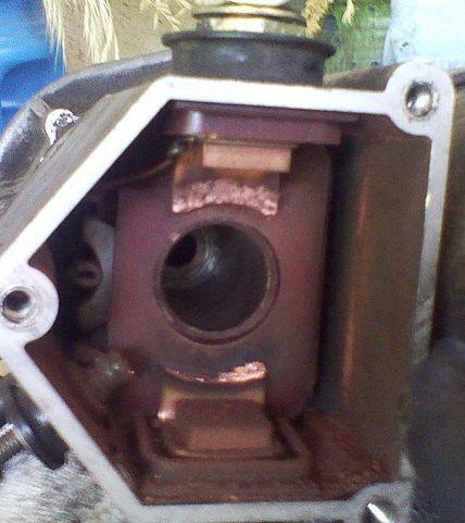

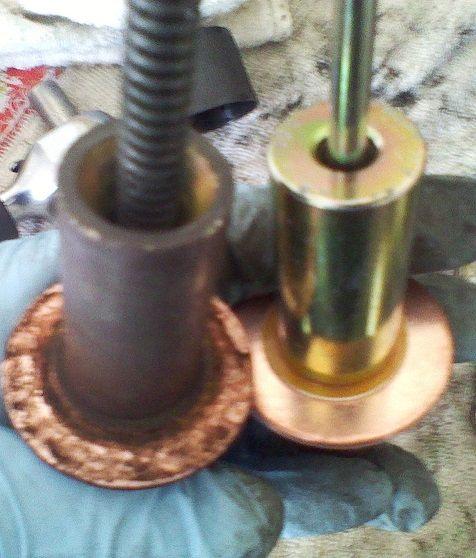

Just installed the kit from Larry B. Looks obvious as to the problem and expect perfection when I reinstall it tomorrow. :)

Yes the contacts could be sticking. A new set of contacts, dis assembly and cleaning is a good idea. Electrical fires from a starter sticking on is not a good thing.

Yes, it is probably the same thing. It happened to a buddy of mine. He did the same fix I did and all is well. Do it before it's too late!
