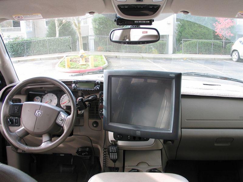

Well, it's been 10 years now and I thought I'd resurrect this thread and give a quick update.
After all these years I have found what I believe to be the weak link in an in-cab PC: the hard drive. I have managed to blow 4 hard drives over the past 10 years, and I believe all the failures were due to thermal cycling in cold weather. Furthermore, older model HDs were more durable than modern ones.
After my most recent HD failure, I decided to rework some things. I bought a late-model ITX-size motherboard (up until now I've been using mid-90s era Pentium motherboard) and plan to buy a solid state HD and see how that holds up to the environment.
All the other electronics have held up very well over the years. I did blow an IDE controller about 5 years ago and had to replace the motherboard.
-Ryan

Ryan, thanks to you and everyone else who contributes a "how to" project. I am often amazed at the ingenuity, problem solving, and unseen uses for these projects.
A question: Why do you suspect thermal cycling over simple vibration shock loading in the demise of your hard drives?
I would expect the solid state drive to be much more reliable in either case.
A mention of wireless streaming between truck and trailer made me realize that wireless was useful for more than just software updates. I like my Garmin Nuvi GPS, but I can see where your system can provide essentially the same capability and display quality. Very cool that 10 years later it requires only minor updating :) .
I have had a PC in my truck for about the past 6 years in different forms, in 2009 I went to a new level and installed a 15" touch screen, I have used the mini-itx boards and have had no issues at all with components failing, I went to a SSD boot drive for speed but still have the same SATA drives from my original install. The setup survived off-roading, sub teen winters and trips to hot California without issues.
I recently removed just about all of it in favor of using my MS Surface Pro as it did everything I needed and I could easily remove it for when I wanted something in the restaurant or for security reasons... I reused the monitor mount and just got an adjustable tablet mount to go on top of it. I have not used a head unit in my truck for that entire time driving the Infinity system directly resulted in much better audio quality.
