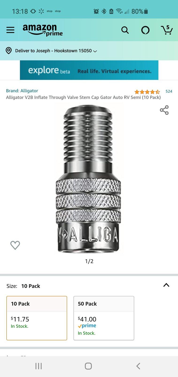

The Double Seal Flow Through Valve Stem Tire Caps looks like a good idea too.

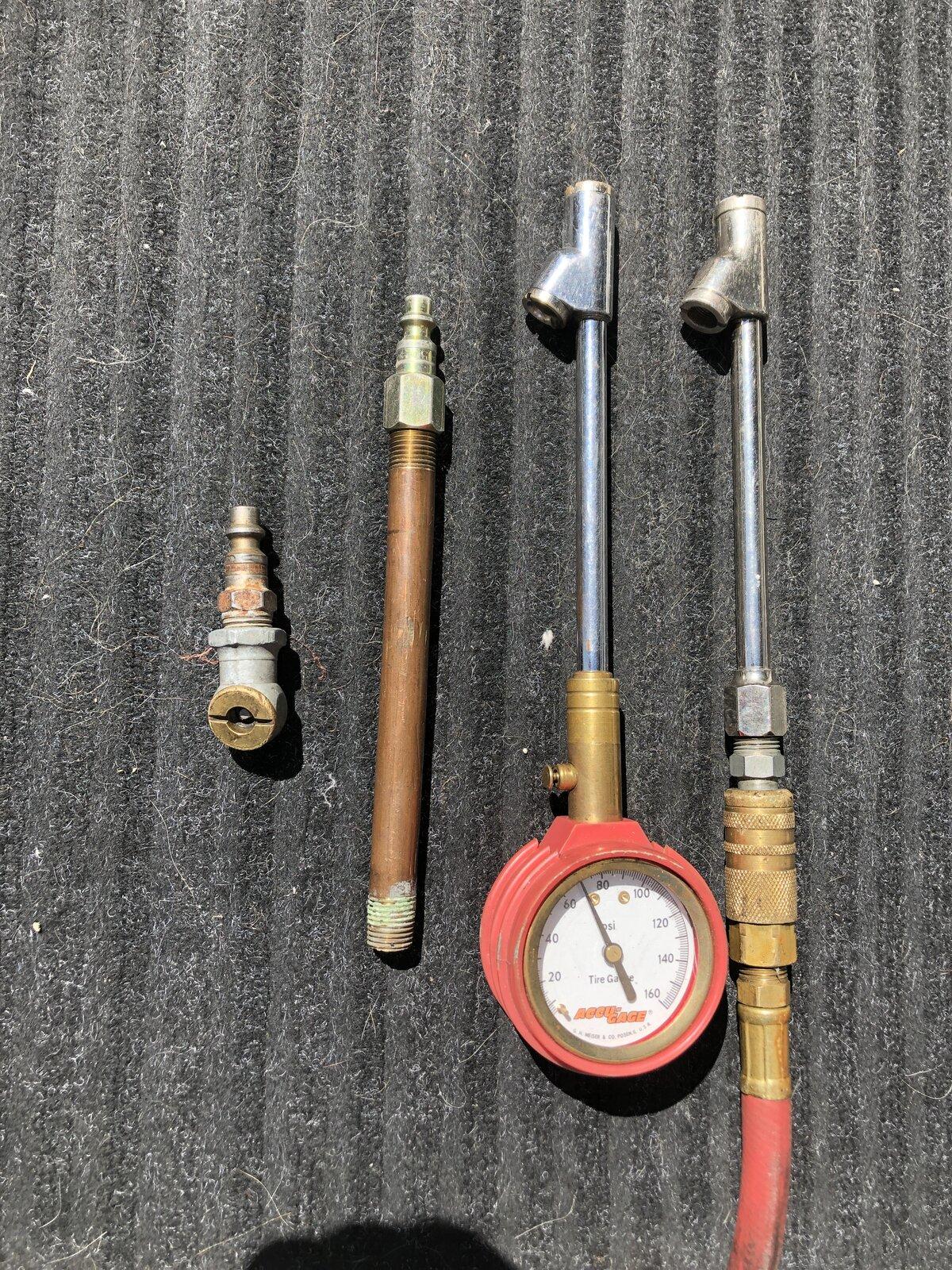

All good ideas, thanks. That tire store won't see me again. They didn't align one side correctly the last time, and dang if they didn't do it exactly the same wrong way this time. This, after I pointed it out to the manager and he apologized. I'll send them an email, also mentioning that the four rear tires were all different pressures, from 71 to 61. Real quality work, yup indeed. I do have the angled pressure gauge and the angled end for the air hose.
