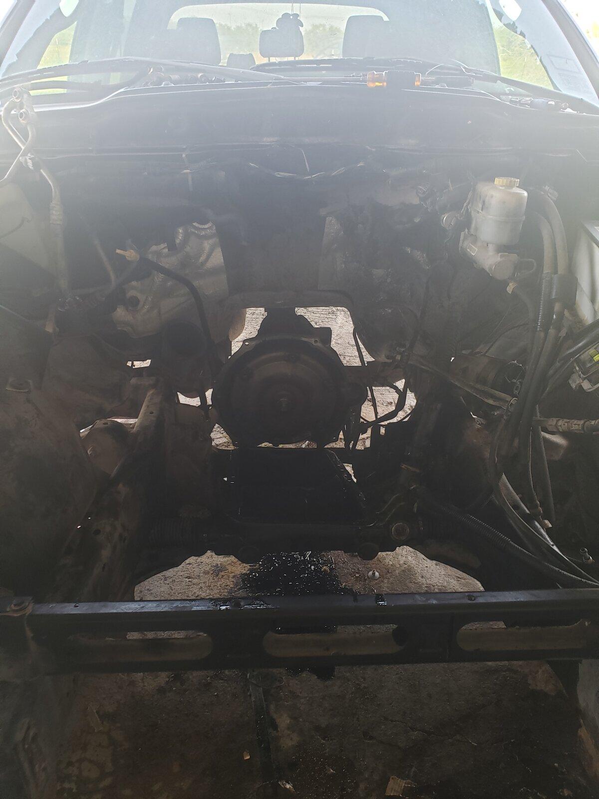

Last issue before it gets yanked. I got the trans unbolted from the bell housing but now I need to remove the torque converter bolts. I have the inspection plate removed but don't have a barring tool. I guess you can spin the harmonic balancer somehow? Tried with 15mm ratchet but the beast is not moving. Any recommendations on how to spin it?
You can also just pull the transmission and do the TC later when it's out.
Disassembling it that way is totally safe - but never try to assemble it so.
For the install you want to have the barring tool at hand. It's dirt cheap.

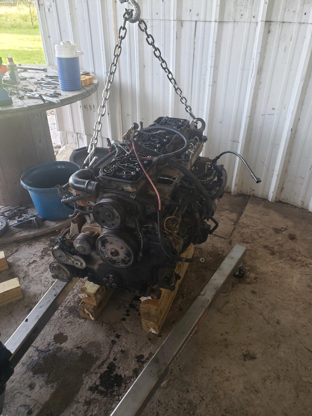

Boom she's out. Had to drop oil pan and remove harmonic balancer still a puzzle to get it out
Would I do that from underneath by the inspection plate cover? I look but didn't really see a spot to rotate it with a screw driver
Probably don't need this now but, I put the driver blade in a flywheel tooth and use the trans bell housing as a fulcrum point to turn the crank a little at a time then take another bite. It does go pretty well.
That's exactly what I did. Had the wife stand up top with a flashlight :)
