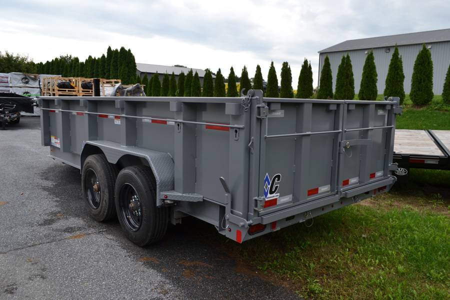

I agree, they make some fine trailers but they are really expensive and like all of them, cheap out in places. I don't care for the Diamond C tail gate. They use 2 hinges, one cam lock and the spreader chain is mounted too high on the door. They all use bailing wire chain. I know that is kind of petty because it is easy to replace it with some alloy chain, but if it is so easy, why don't they get it right.
Note the price of this one:
https://www.truckpaper.com/listings/trailers/for-sale/28535757/2018-diamond-c
Pictures of the tail gate for comparison, top is PJ.

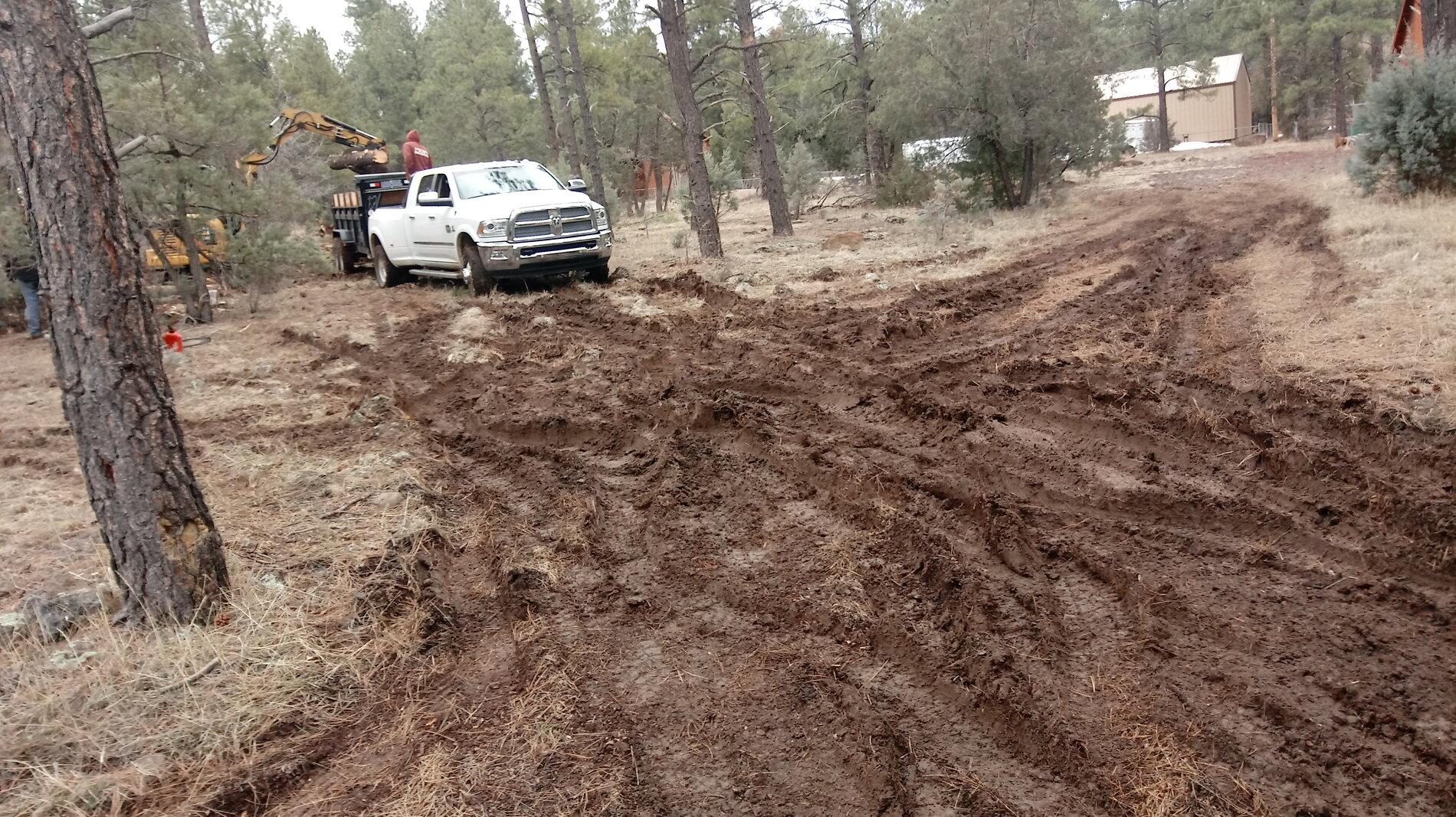

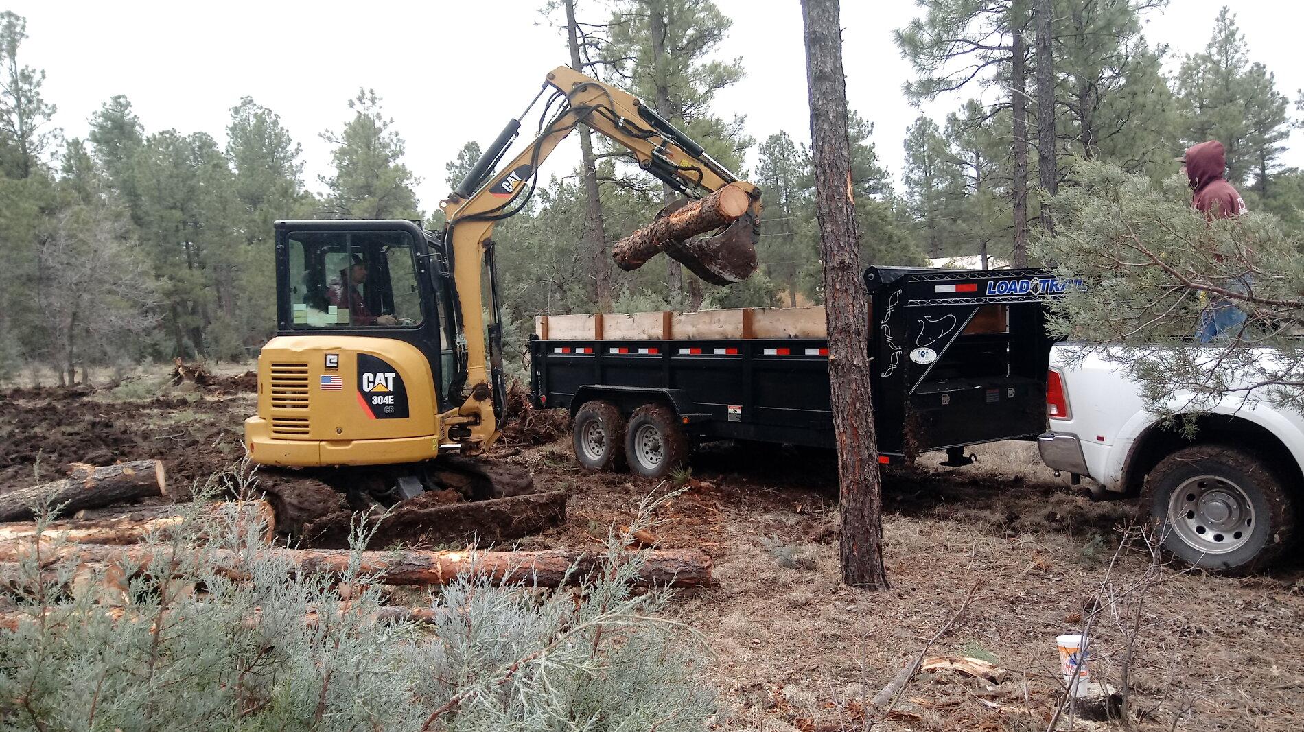

We hauled 2 loads of pine today and one load of chips, first time in ages. Talk about muddy! Took some pictures of Travis's Rams, he is a Ram Man, lol. Three 3500 cab/chassis, (two '12's and a '16) and one '16 Mega Dually pickup.

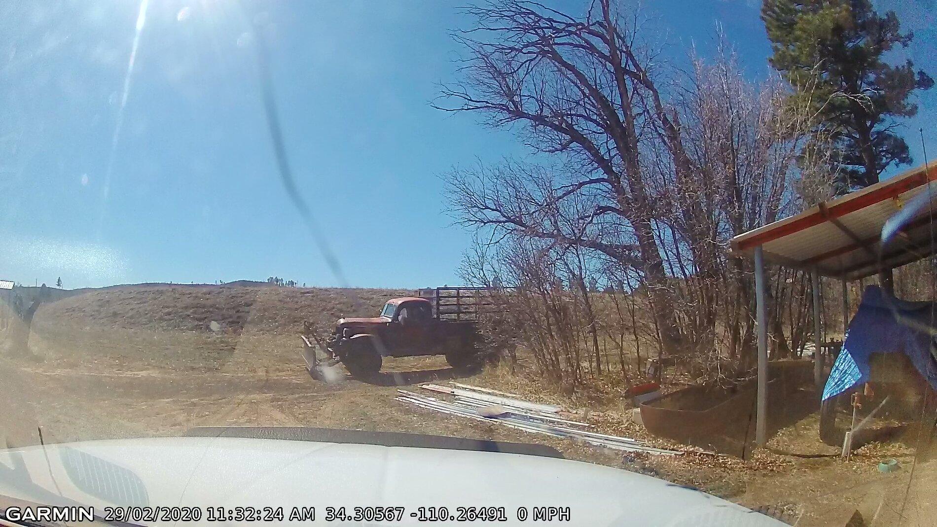

Delivered a load of Cinders today (8 yards) and sunk the left hand side of the trailer up to the axles. Needless to say I was stuck! So the homeowner cranks up his '48 Military style Power Wagon with no brakes and yards me out:D I forgot to take a picture but I might have something on my dash cam.
You’re fortunate to have resourceful customers.
