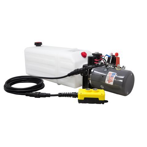

Is the double pump set up faster than the ones with the bypass for the gravity down? I have wondered why more don't have that option as it would save on battery for guys that run multiple loads a day. Plus its faster than the single pump set ups.

Yes, the double pump is twice as fast, 4 gpm v/s 2. I ordered the gravity down option on my PJ ($225) it is worthless, way too slow especially if it is cold. I thought like you, save on batteries but I don't use it. Plus if you use it with a partial load in the bed it will over fill the tank. Goes down faster than it can vacuum the fluid on the other side of the cylinder.

That's really odd. I guess it don't always work in practice like it does on paper. Who'da thunk it :oops:
My only experience on gravity down is with a tilt deck. It dropped pretty quickly, faster than my dump for sure. But I don't remember much about the system.

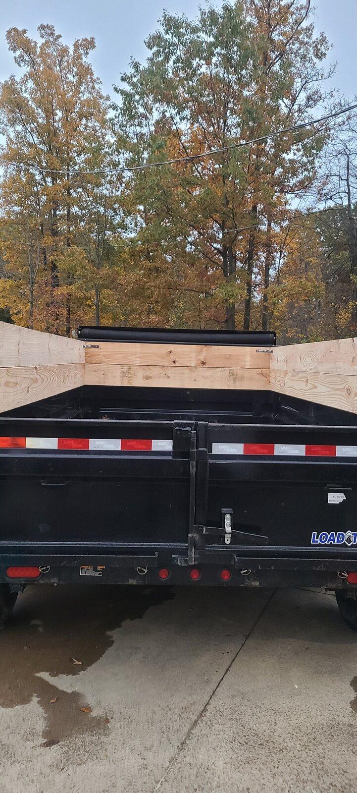

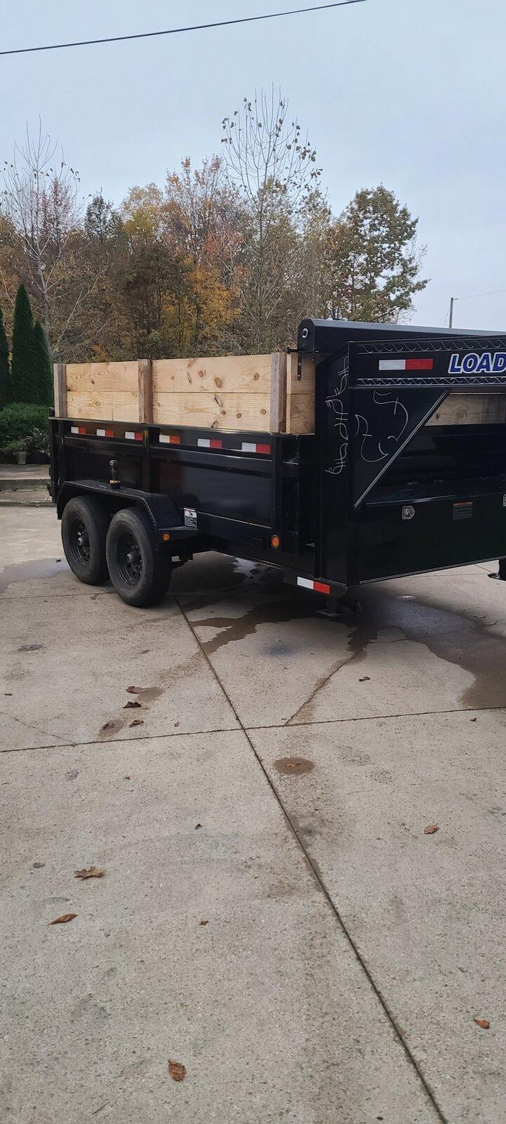

I got my sides together today.

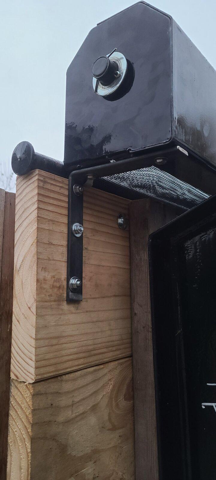

I ended up mounting the tarp back to the top board. I Made some brackets out of 1" x 1/4" flat bar.
Thanks for the suggestions, helpful as always Nick.
Looks good JR! Can you reach the crank? I would be too short, lol. I know you said you wanted the sides easy to remove but I think you will fined it is rare. If you do, you will need to transfer the tarp too.

Yes I can reach The tarp, being tall does have its advantages every now and then :)It was mounted out of necessity for the sawdust and was kinda the quick and dirty way to do it, but it actually works well there and is solid. Mounting it to the GN frame would require some fabrication...not sure that I want to weld to it and booger up that nice powder coat just yet. Remember, stuff rusts here. BAD! :eek:
I wanted to keep them removable because I have been loading a lot of fill from the side with smaller equipment. The sides will no doubt make it more difficult but maybe not enough to worry about. It'll be a little trial and error.

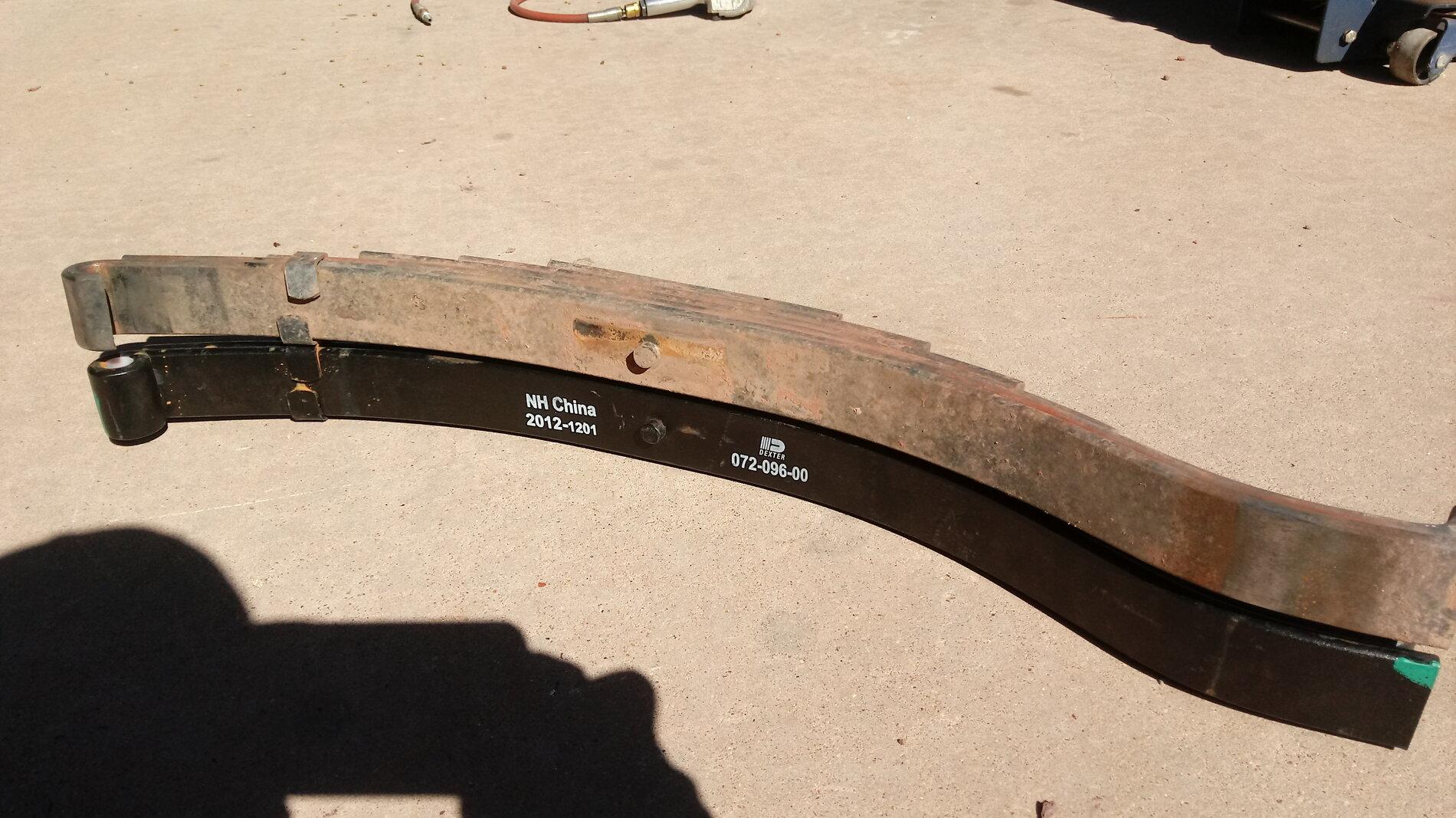

Broke an eyelet on the left rear spring on the Lamar dump. 4k spring and 8k axles. No clue how/why that happened. I went ahead and replaced as a pair. Genuine Dexter, made in China:)
Was the cheap nylon bushing wore out? Bolt seized maybe?
The bushing was gone but the bolt was fine. I think with the spring sliding back and forth, it destroyed the bushing. The other side was fine. I just replaced the bushings and bolts recently. In my opinion, it broke in a low stress area, the front part of the eye takes a bigger hit.
When I first noticed all the slack in the spring/tire...I was like...dang Nick you did it again!! I thought maybe when I replaced the bushings, I missed the eye with the bolt:eek::D
At the risk of repeating myself, I'm super surprised you don't use a wet bolt kit with bronze bushings. Not that it would have prevented that but they hold up so much better than those cheezy nylon inserts. Its how they should come from the factory IMO.
