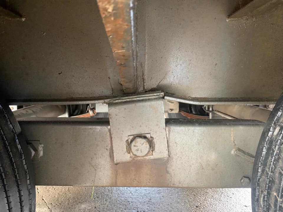

I chucked the bolts in lathe and made own greasable bolts! Way cheaper the buying them and was an excuse to play with the lathe. What a difference! Much quieter when towing, none of the squeaking with suspension flex!
Dexter Wet bolt kits for 7k axles cost $200, thats including greasable equalizers, bronze bushings (very important) and heavy duty shackle links.
You can save a little money and drill and tap your equalizers out if they are not worn out because the junk nylon bushings wore thru and wiped out your eyelet.
At any rate, if I can get into a lathe for less than that I'm in! :D:D

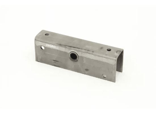

JR, are you talking about this type equalizer? My Lamar has a wet bolt here for the center. My Load trail car trailer is a rubber bushing, no grease.
That's the same one my Kaufman gooseneck uses, wet bolt on the pivot, I replaced them when I did new axles a few months ago.

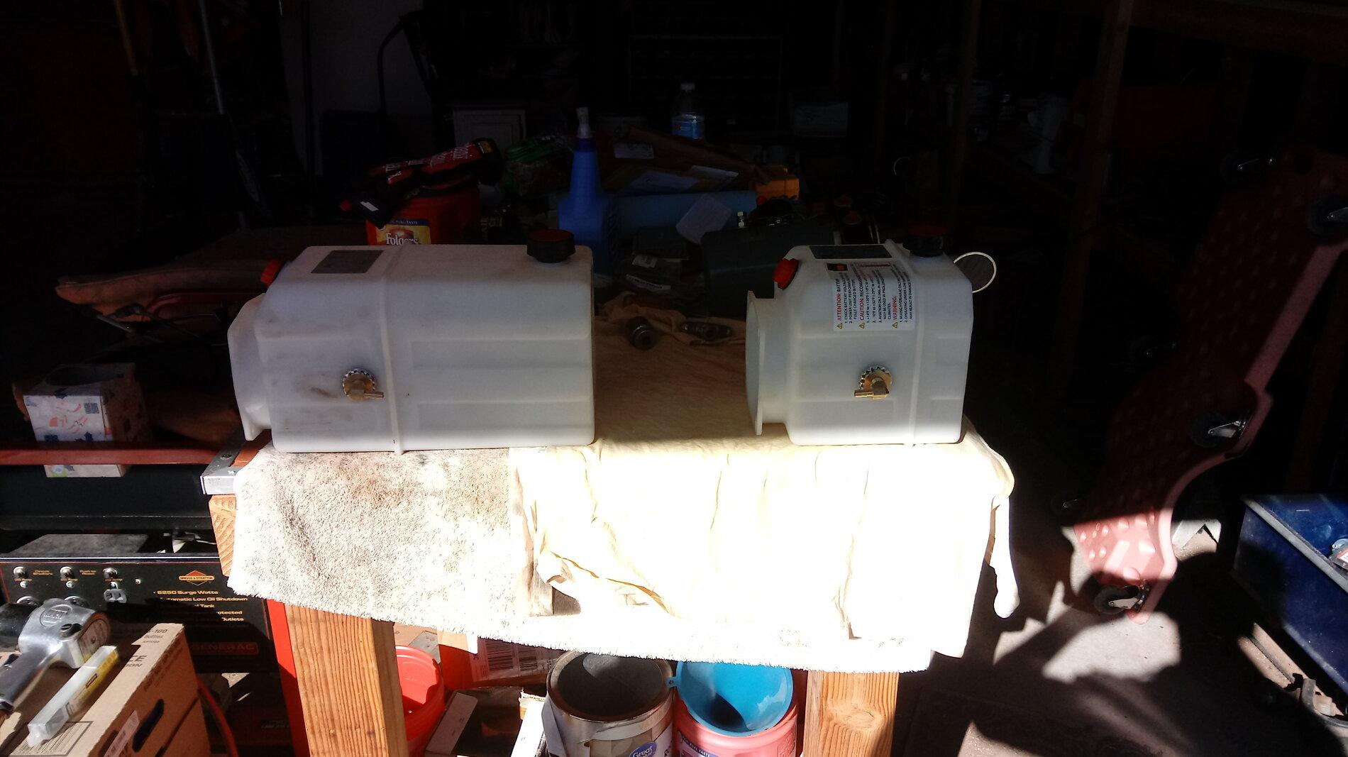

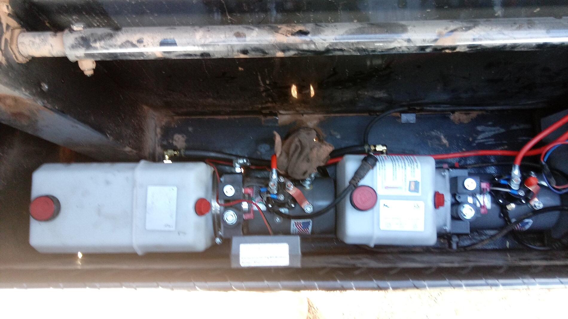

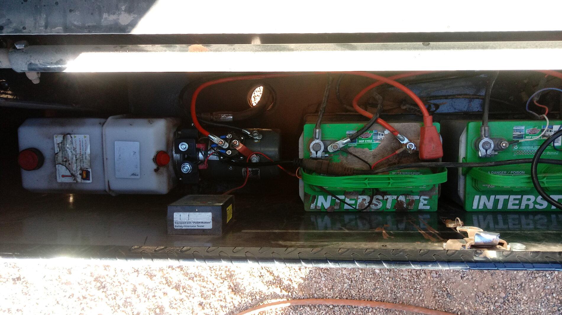

Calling all dump trailer owners/operators. Or just anyone with hydraulic experience.
If you have a dump trailer you know how slow they cycle. The bigger the trailer/hoist the slower they go. I think jhenderson put me on to a double pump system that is offered. I am really thinking about it or just adding a second pump. The double pump is expensive or about $800 more than a second pump. Since two pumps will have two tanks, my concern is, will the oil level stay equal or will one or the other overflow. I think I can adapt a fitting to the tanks and run a hose between them. There is an unused plug on the tanks that I think is 1" straight thread. Is there a 1" o-ring boss fitting? I think they are straight thread. What do you guys think?
http://www.fayettedistribution.com/KTI-Dual-Pump-Hydraulic-Pump-w-Remote-p/14494a.htm
Almost done with the conversion, still lack one o-ring boss #6 straight and both tee's. Sunday is not a good day to find parts, I did get all 4 hoses made, that was good.

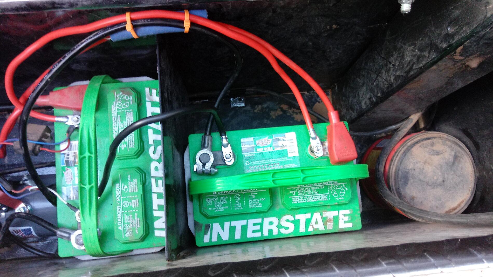

I moved one battery out of the large section of the tool box and turned the existing one, for clearance to add the second pump. I wired one battery per pump and jumped the batteries together. I am going to run both controllers for independent use of each pump or both.
I will be all in for about $600 v/s $1200 for the double pump, plus what they don't furnish for the install.

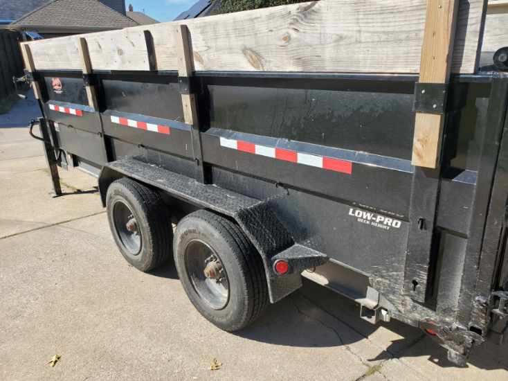

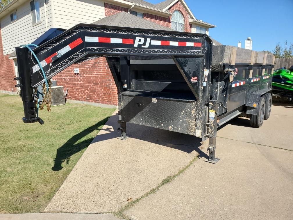

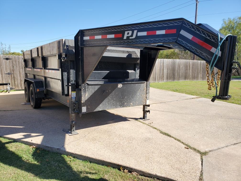

Update on my Sons totaled Dump Trailer. Insurance paid him 8k and he kept it. Had it repaired for around 2k and advertising it for $15,900 with several interested. He paid $12,500 in May of last year so he will do well on this deal.
Can anyone recommend a "GOOD" Motor Vehicle Accident Attorney in the DFW, TX area???
Issues with his truck, they drilled the holes for the pucks and gooseneck off center. So the bed is no good.
Edit, he just told me he sold it for 15k.
Not sure but the riser was replaced and my son confirmed it's installed correctly and plumb. It's his phone as I have questioned other pics that sure didn't look correct.

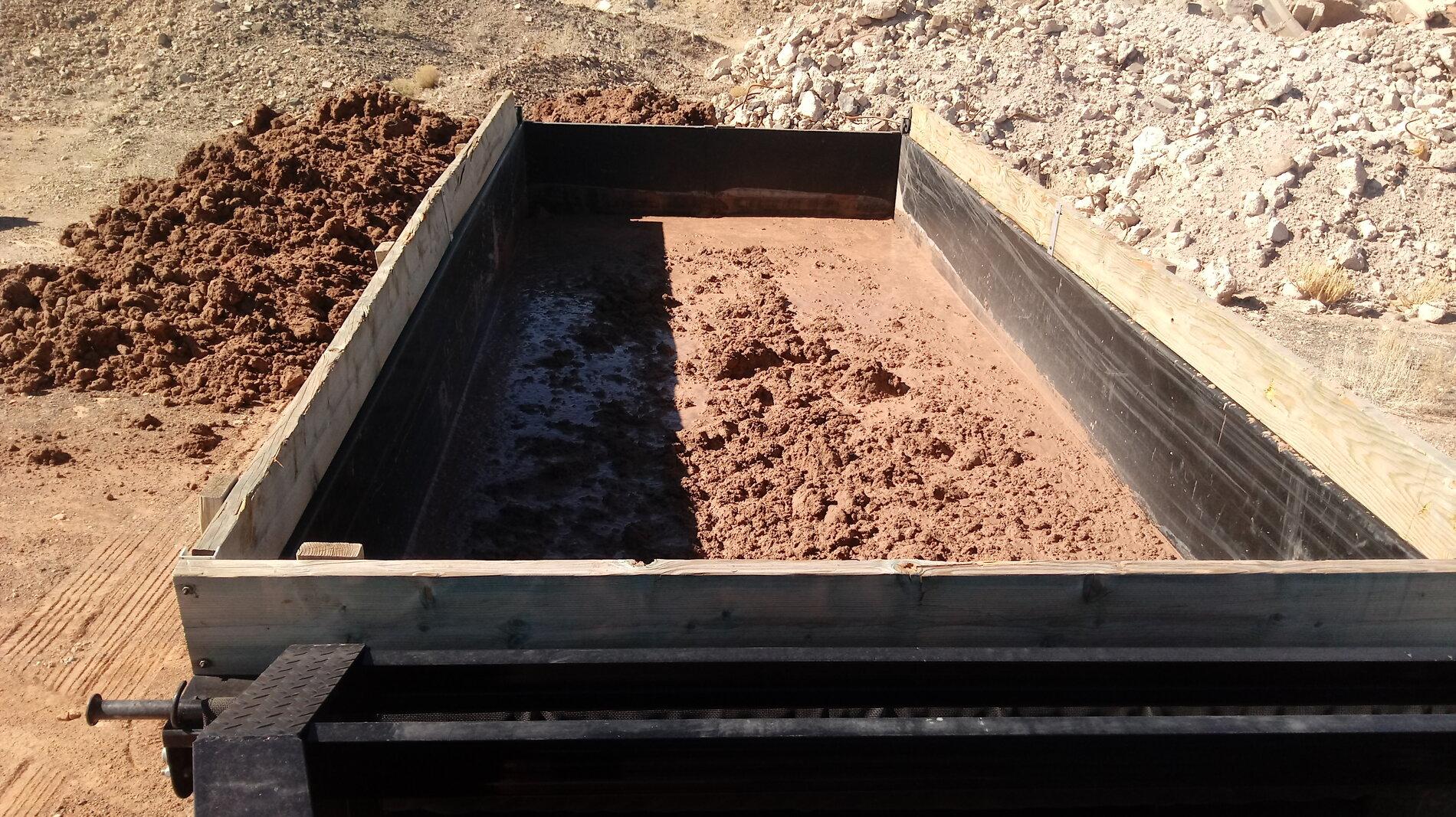

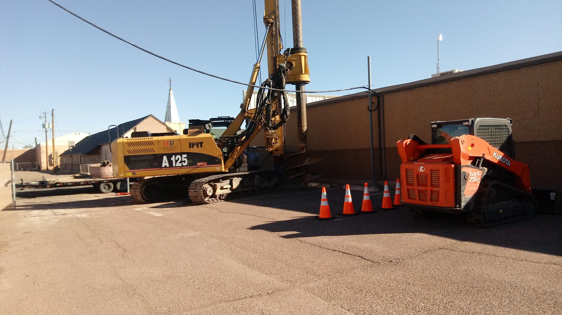

Whelp, that lasted quick. Started with a 5' bit on the way down to 22'. At 17' the hole caved in, mostly quick sand I guess. So now the hole is 10' wide x 8' deep....sluffed off, clear under the building. First two loads were mud, second two were liquid mud, heavyyy!
OK, I've looked twice and still lost. Sometimes It doesn't take much :D
What in the world are you digging that big of a hole for right up next to the building? Which trailer is that in the bottom pic?
How did the hydraulics handle the weight?
