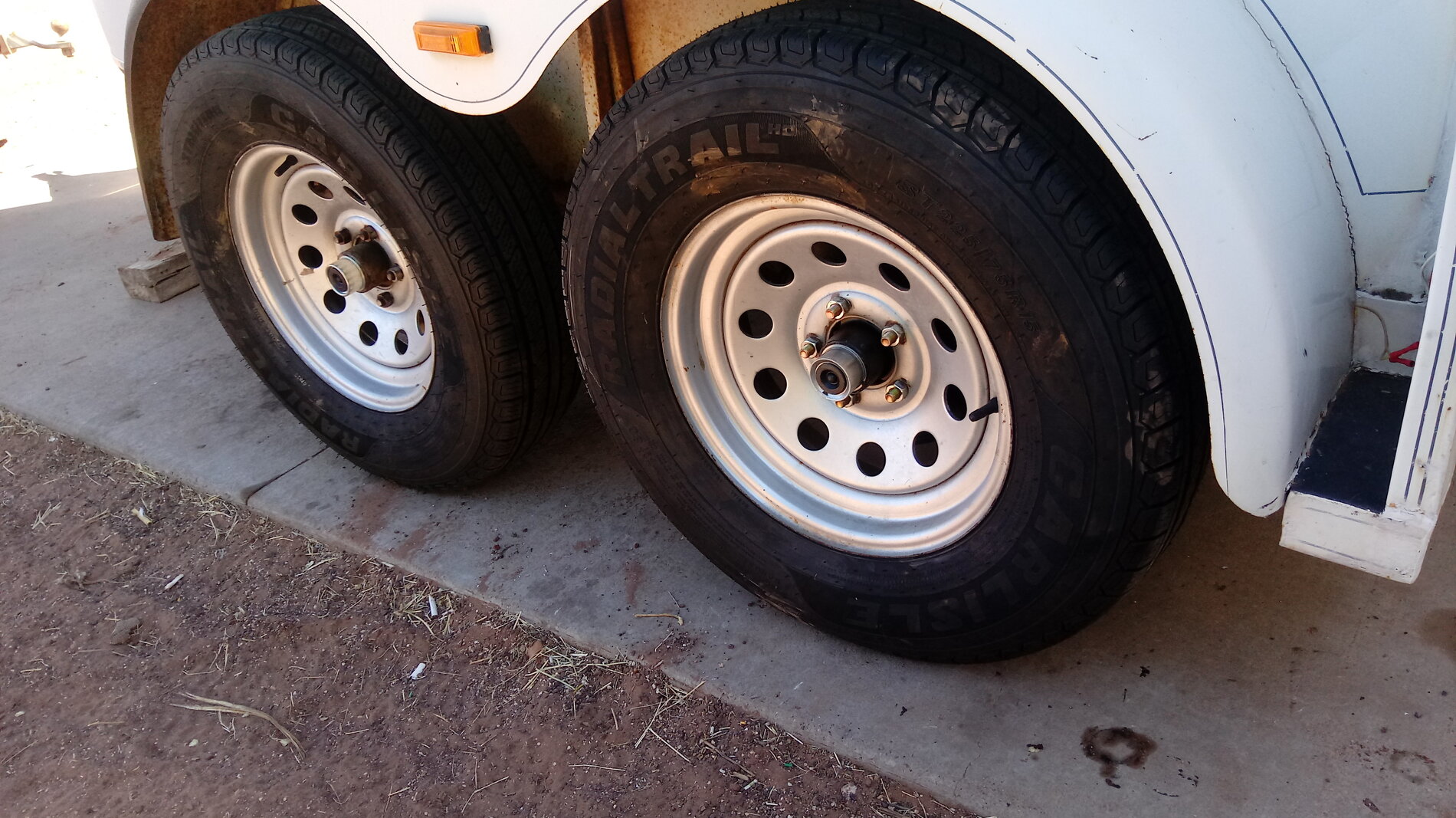

Now that this is my primary trailer, I have been shopping for 5k springs. Mostly I am trying to get more loaded bed height, the new larger tires helped me by 1/2". The best price I could find is $500 for a full set. So, I disassembled my spares and added the third leaf in the pack to my rear springs and the 4th leaf to my front, should give me about 4.5k spring. It only helped my lift by 1/4" empty, hopping for maybe 1/2" loaded.
The plastic bushing in the new springs were junk, plumb worn out already, the nylon ones that I installed were fine but I replaced them again anyway.

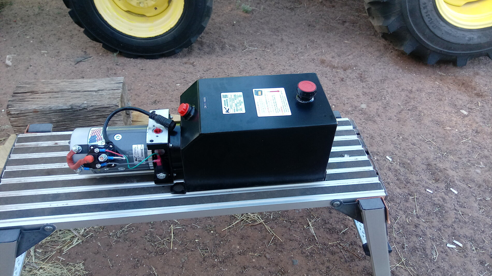

Also talking with Diamond C trailers for one of their high flow pumps. They are designed for the telescopic cylinders, so only power up and gravity down but I think they will be fine on my scissors. They worked with KTI pumps in the design, so they have an exclusive on this pump. About a 50% increase in cycle time over the standard pumps.

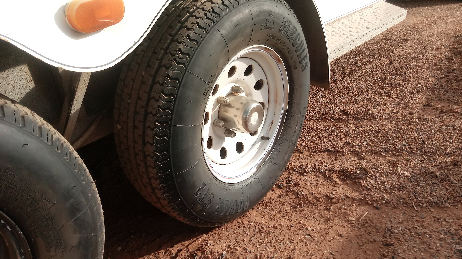

Got the buy of a lifetime. '99 Logan two horse slant load trailer, very little use. Been parked for 7 years. Tires were good but old, so we installed a new set. Hercules 225/75x15 10 ply, ($612 out the door) Dexter 3500 lbs. torsion, two axle brakes and 6 hole wheels. Marker lights are faded so I will replace all of them. Powder coat peeled off two of the wheels, kinda looks bad but...

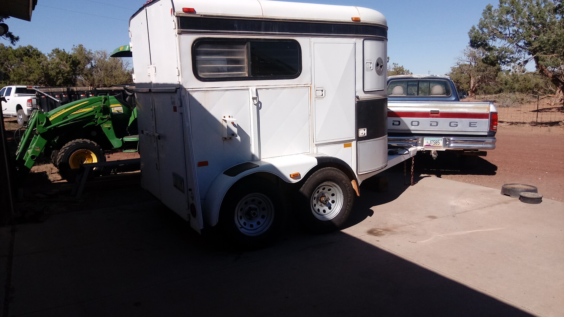

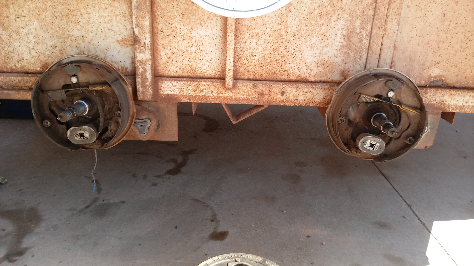

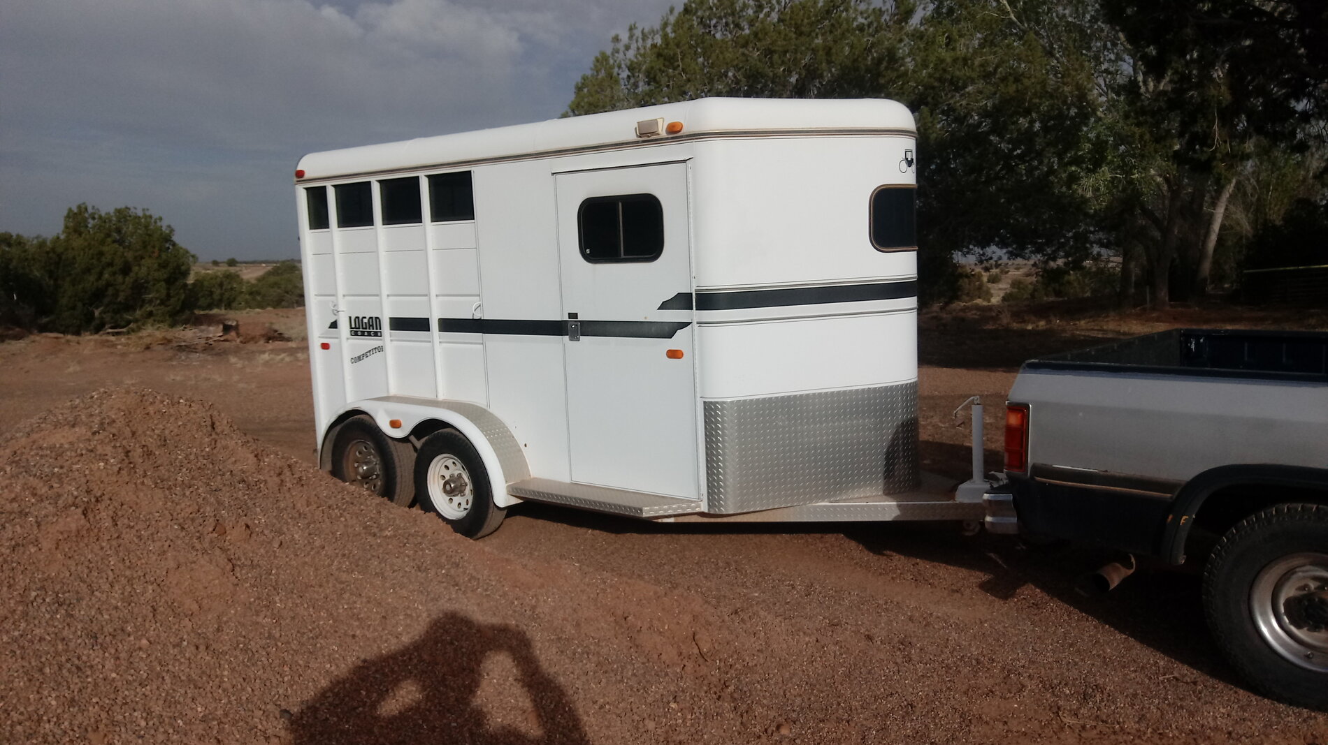

Bought another one that needed rebuilt, plain Jane two horse straight load, CM. Seems to be a good old trailer, '95 with Al-Ko 3500lb torsion axles, (4) wheel brakes. All new wiring, some lights, new hub and tires, it is ready to go. Note how well the brakes look for a 28 year old trailer, the dry state of Arizona.
Finished the install yesterday. Nice! Not quite twice as fast (up) but almost. The gravity down is still slow but since there is no battery drain, I will just deal with it. Not sure what the flow is but I think in the 3-3.5 gpm range, standard pumps are 2. The motor on a standard pump is 1.6 kw, this one is 2.2. I was a little worried about programing the wireless remote but it was easy. It is way more handy, than using the corded remote.
So with the horse trailer being a 1995 were the torsion axles any good? If a trailer sits too long the rubber rods in the suspension will harden and the axle will sag leaving you with no suspension. They need to drop a few inches when you jack them up. I have replaced torsion axles on 5 different Airstream travel trailers.
That I am unsure of. I do know that Dexter warrantees them for 10 years v/s spring axles at 5 years. Lippert is 11 and 6.
How do you check them? The tire clearance seem about right with the fenders.

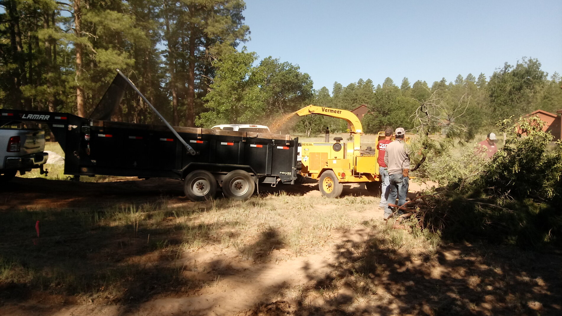

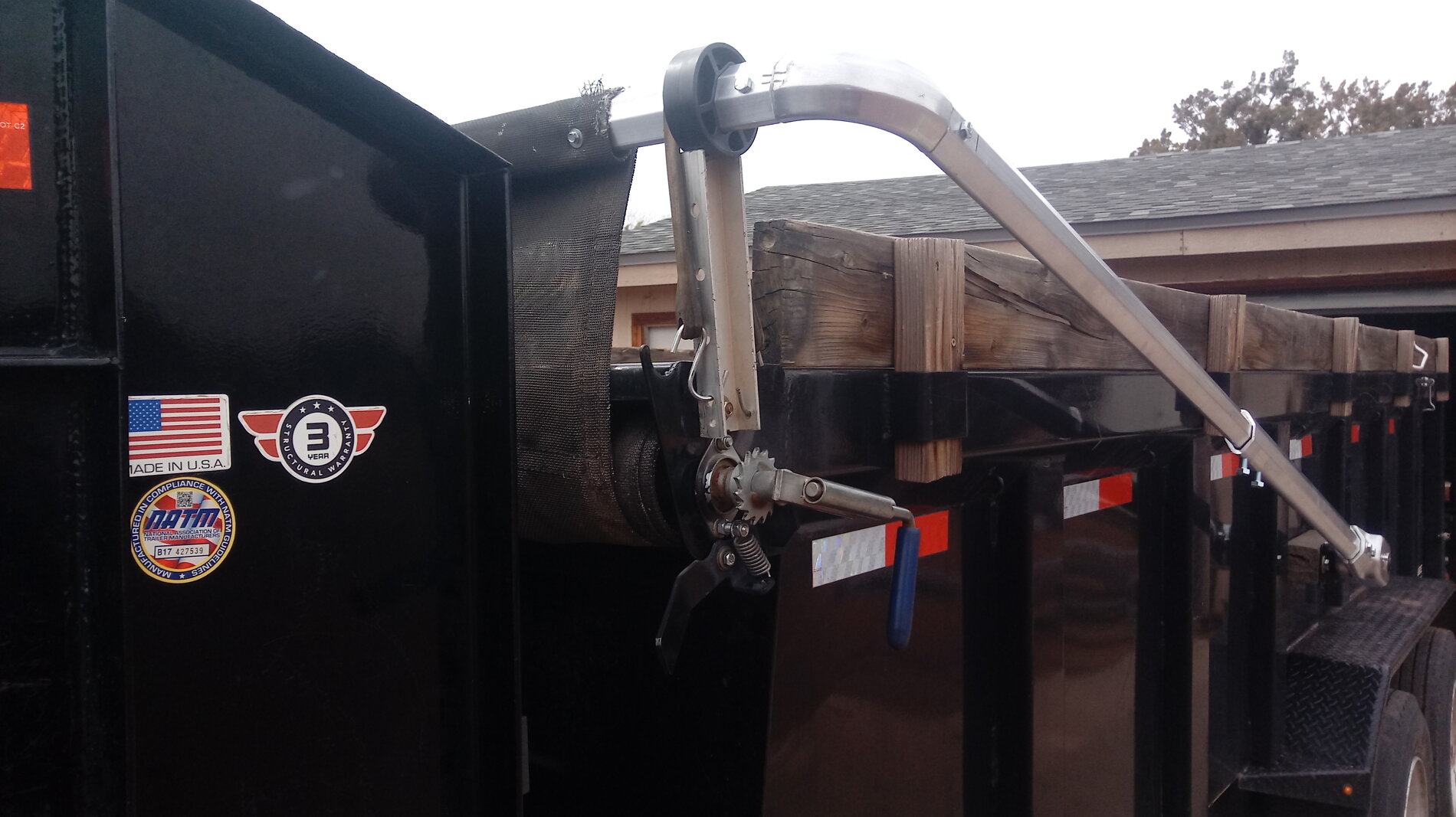

Sure do like this long arm tarp kit. I can deploy it a couple of feet and protect the back of my truck cab. The commercial chippers can throw the big chunks 50' There are times when there is no room to get beside the trailer and they have to shoot it up the rear. I have a small dent above the rear window from the sucker.
It does look like I am going to have to fold out the tow mirrors, the motor is creating a blind spot with them folded in. Even on 7' wide dump trailers I always keep them folded in, due to delivery location obstacles and narrow roads.

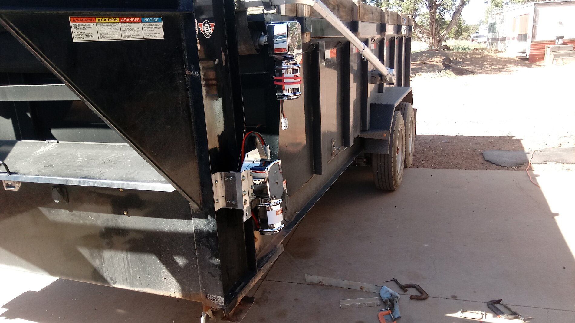

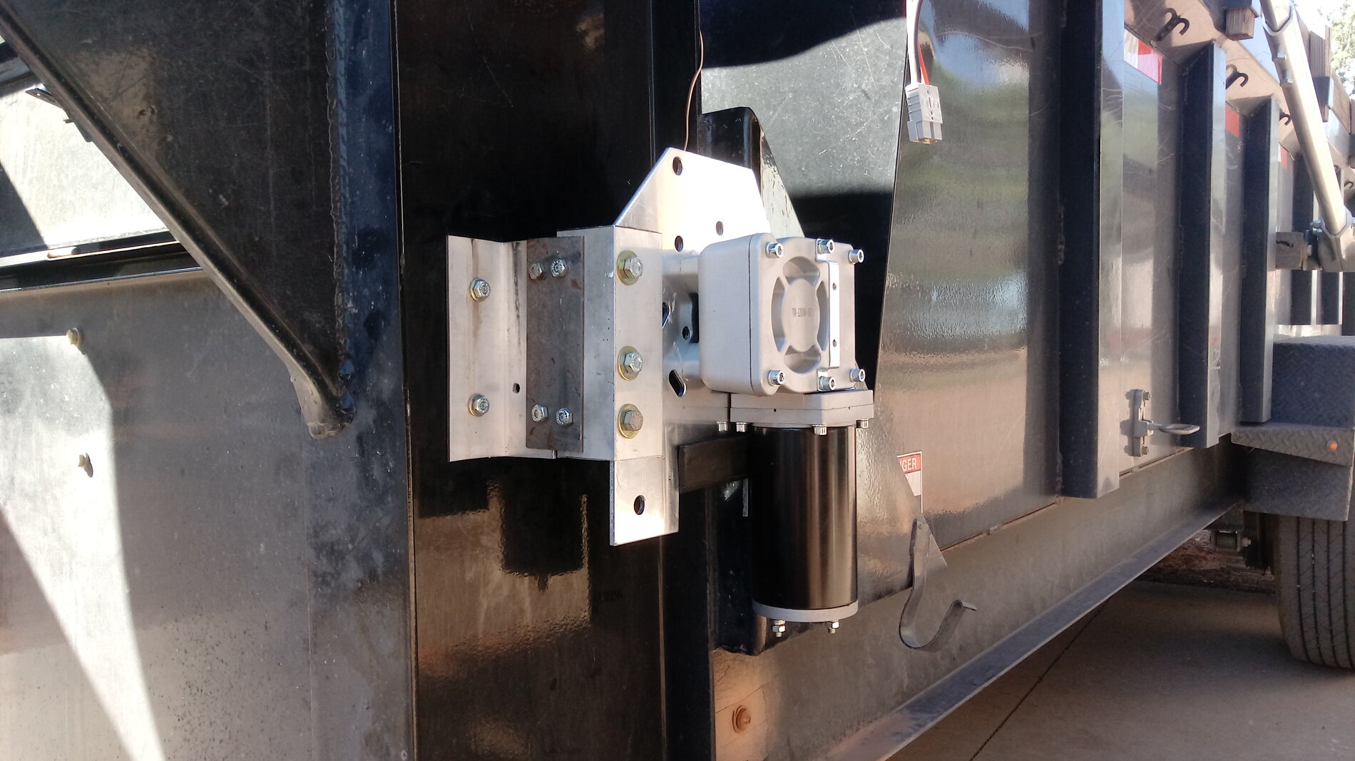

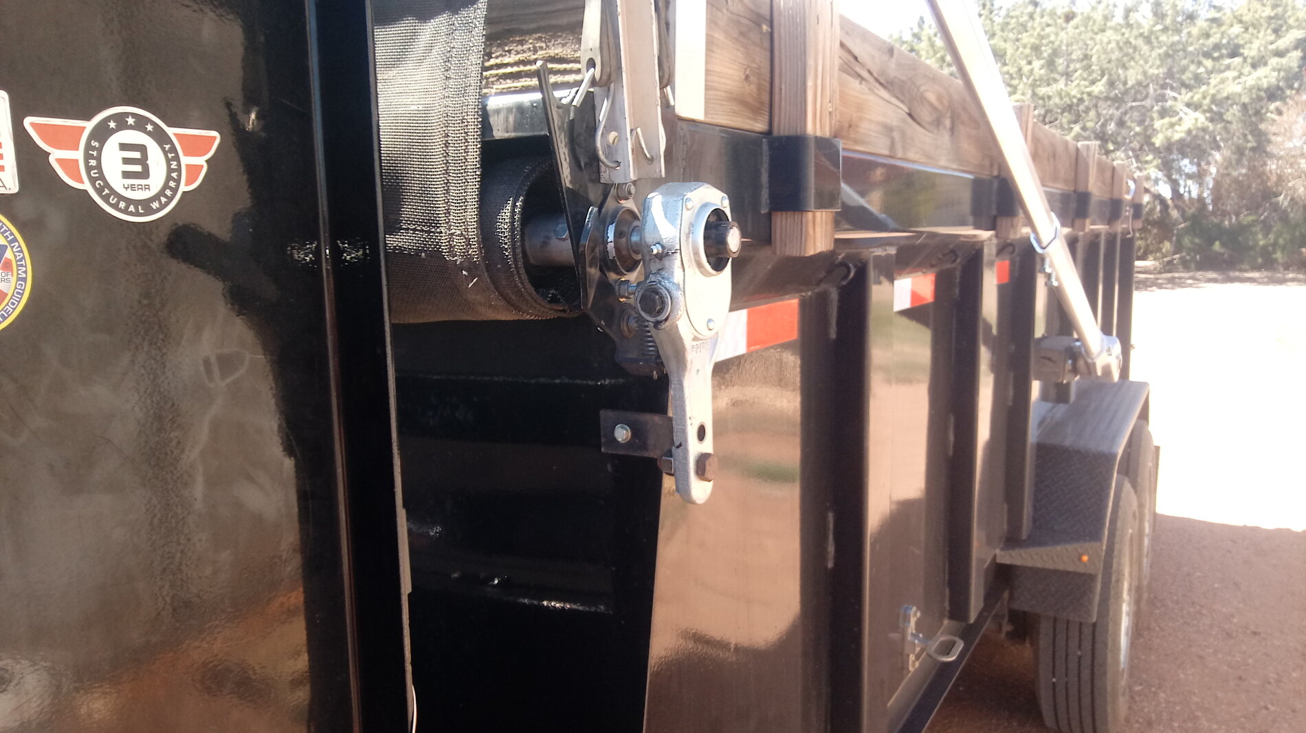

Installed another tarp motor, jacks this time. Nice not having to struggle to hold the drill and it is twice as fast. It won't lift a load, but for sure, it will work empty. Used the same power panel/switch, just used another cable quick connect.
Video's of the jacks going up and down, about 40 seconds each and the tarp deployed and returned.
The jacks are using a 1200 watt motor, 60:1 gearbox at 68 rpm.
Tarp is using a 900 watt motor, 60:1 gearbox at 60 rpm.

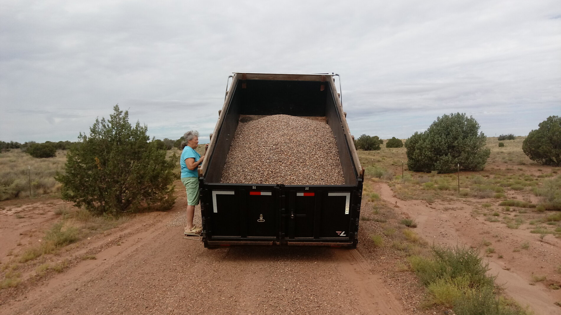

Hauled two loads of rock for my street yesterday. It is monsoon season so the gentle swale we have crossing the road was getting a little sticky. Covered it up with two loads, side by side with about a two foot overlap in the center.
Asked for 6 ton and got 6.32 and 6.02, good operator. Trailer is staged and ready to trip the gate. My helper runs the bed up/down with a wireless remote and trips the gate when I start moving.

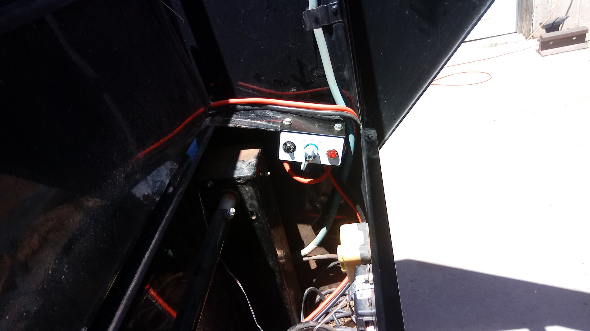

Did you add the electric trip on the gate? I just dumped my 1st load in my new trailer.. I was going to ask you about a solar float charger recommendation, I think I'd prefer it to a cord all the time.
