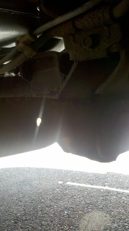

Doing the brakes on pass side I notice this.... WTH and how did I do that? If you don't see it the whole control arm is bent in from the bottom at the front attachment point.
I've seen this deal with the rotors with other veh as well. It looks like a quick song on a record, right? Narrow pad contact? IMHO, I think rust gets in the cooling fins between the surface halfs, and jacks them or bulges them out. I think it's the rotor specifically.
