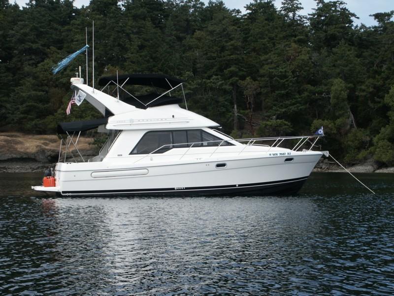

2500 hours and need an overhaul? When we sold the 33 Bayliner after 19 years the two little Cummins had a little over that in hours and were "getting" broken in. Only thing I every did was water pump on one of them, raw water pumps regularly, start relays, and not much else.
I was checking the engine hour-meters wow I guess wrong there 4654 hours been using oil somewhat spoke with dealer said your hour meters aren't working in some time hmm. I schedule for dropping off there in next couple of days :(
Snoking, was that a blue water vessel, or Lake? 19 years is great but how many hours?

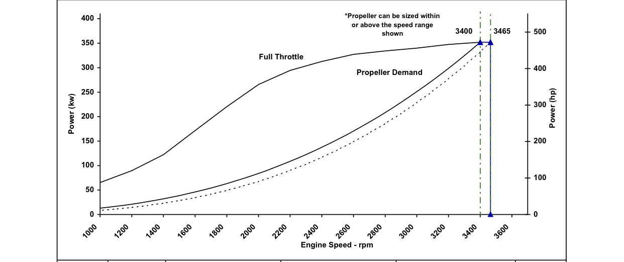

True, but prop demand curves aren’t linear.
It’s rare for a marine motor to be at 100% load at less than rated rpms, unlike in a vehicle. Even then it’s not sustained unless the prop is pitched wrong.
Cummins rates their marine engines at max load for something like 5 hours out of 24 hour period. They can be operated at 85 percent continuous. My 4tb were rated to 2800 RPM and I ran them at max cruise of 2550 RPMs and about once a year ran them up to see that they would still turn 2800, which was usually just after have the bottom cleaned and fresh bottom paint. That said, they spent more hours at 1550-1600 which was 8 knots at 3 GPH combined for both running. With diesel furnace and higher cruising they averaged around 4 gal per hour over the 19 years of ownership.
