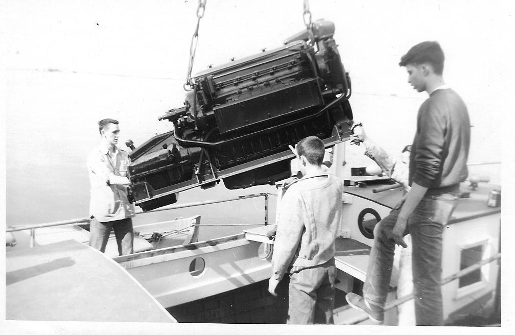

Nice thing about old 71 series Gray Marine/Detroit diesels(and the other cylinder displacement sizes) was the ability to rebuild them with out removal from the boat. That is me at 16-17 years old back to camera putting a Navy surplus 6-71 in our Sea Scout Ship 1960-61. We later burn down to pistons with 90 injectors and governor in battle mod racing the local USCG 40'er. We removed the head and then removed all those mounting rail bolts except one on each side at the back of the twin disc transmission and jacked up the front of the engine, then dropped the pan and put in two new cylinder liners and pistons. And replaced the 90 injectors with high lift 70's. The two cycle GM/Detroits were a marvel of engineering, with symmetrical blocks and many other parts. 2,3,4,6,8 etc cylinder counts used many of the same components.

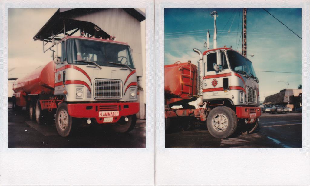

Then had a couple negative things going! They were fuel hungry, dirty on emissions and could run away on crack case oil. The picture of the Chevy Titan 90 class 8 tractor I drove in the mid late 70's had a 8V71 350HP Detroit with a 13 speed Road Ranger. It average only 4.5 MPG at half full/half empty usage. Empty the combo weighed in at light 25K.(trailer 10K, tractor 15K) Trailer was aluminum and along with the tractors frame and cab.
