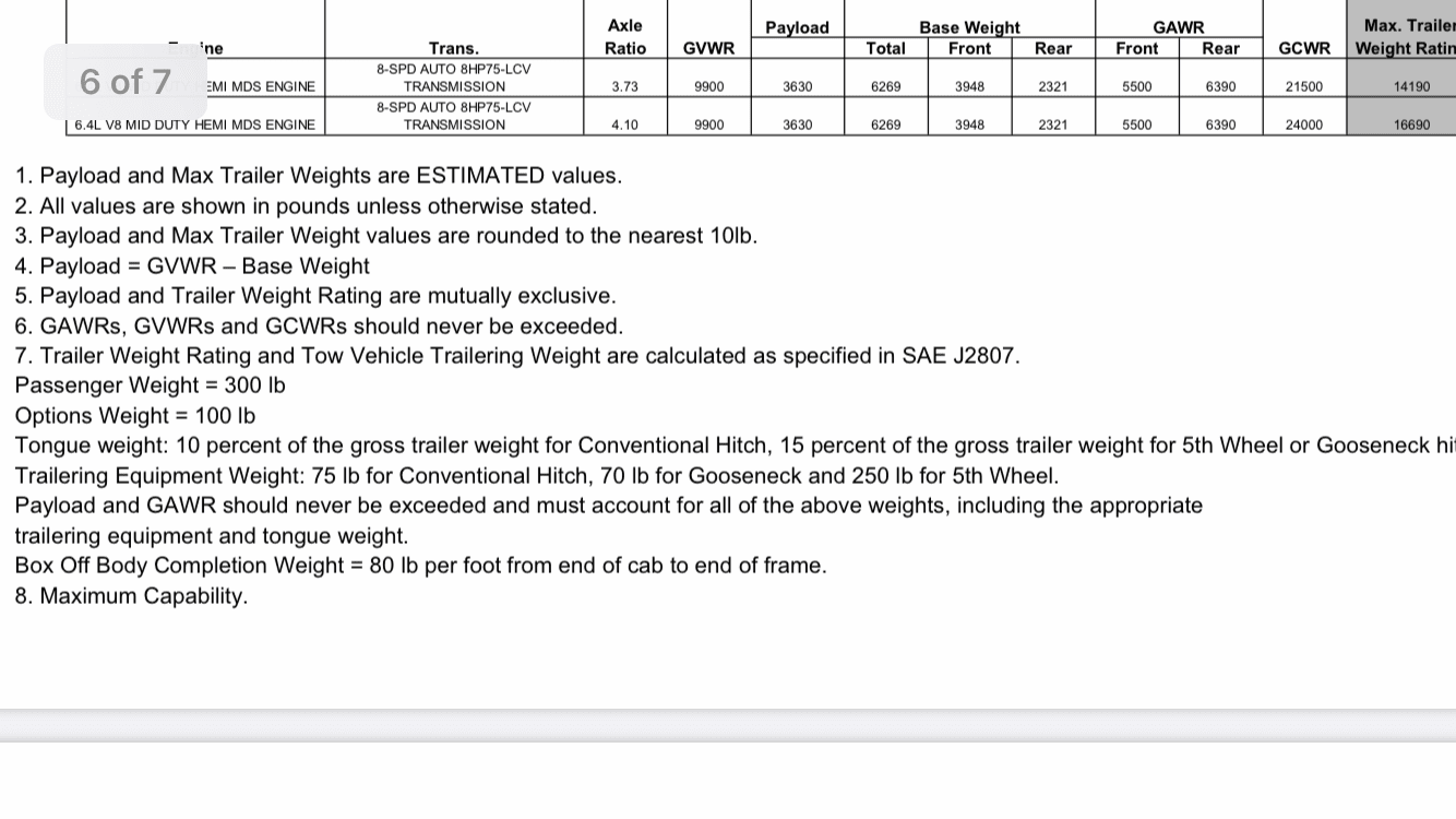

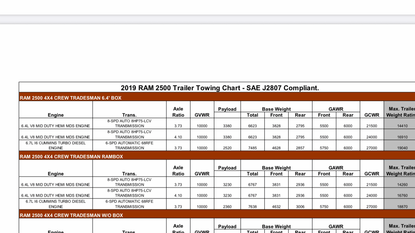

It sounds like I have to. How does ram say the tow rating is 19k+ but doesn’t specify how that’s accomplished?
It does specify, that's where the 1800/17000 rating comes from with anything higher being 5th wheel/GN.
This is out of the 2019 Towing guide on the Ram website. The same guide that lists the max tongue weight at 1800 lbs.
Fifth-wheel Hitch Requirement Chrysler Group LLC requires that for warranty coverage, vehicles towing trailers with a weight rating of 17,000 pounds or more must be equipped with a fifth-wheel, gooseneck or pintle hitch.
