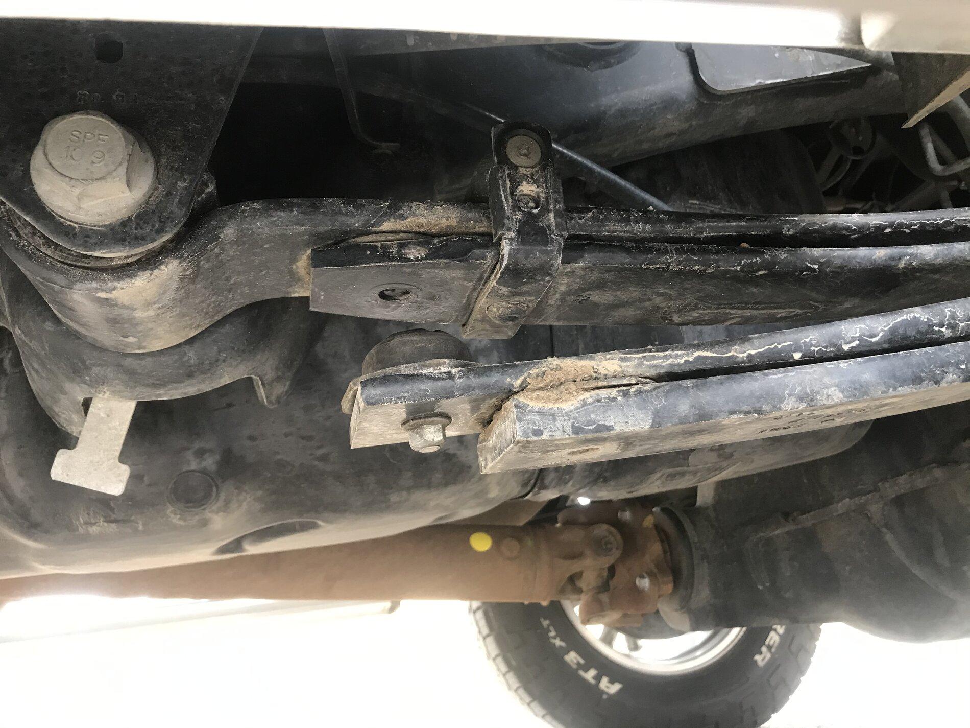

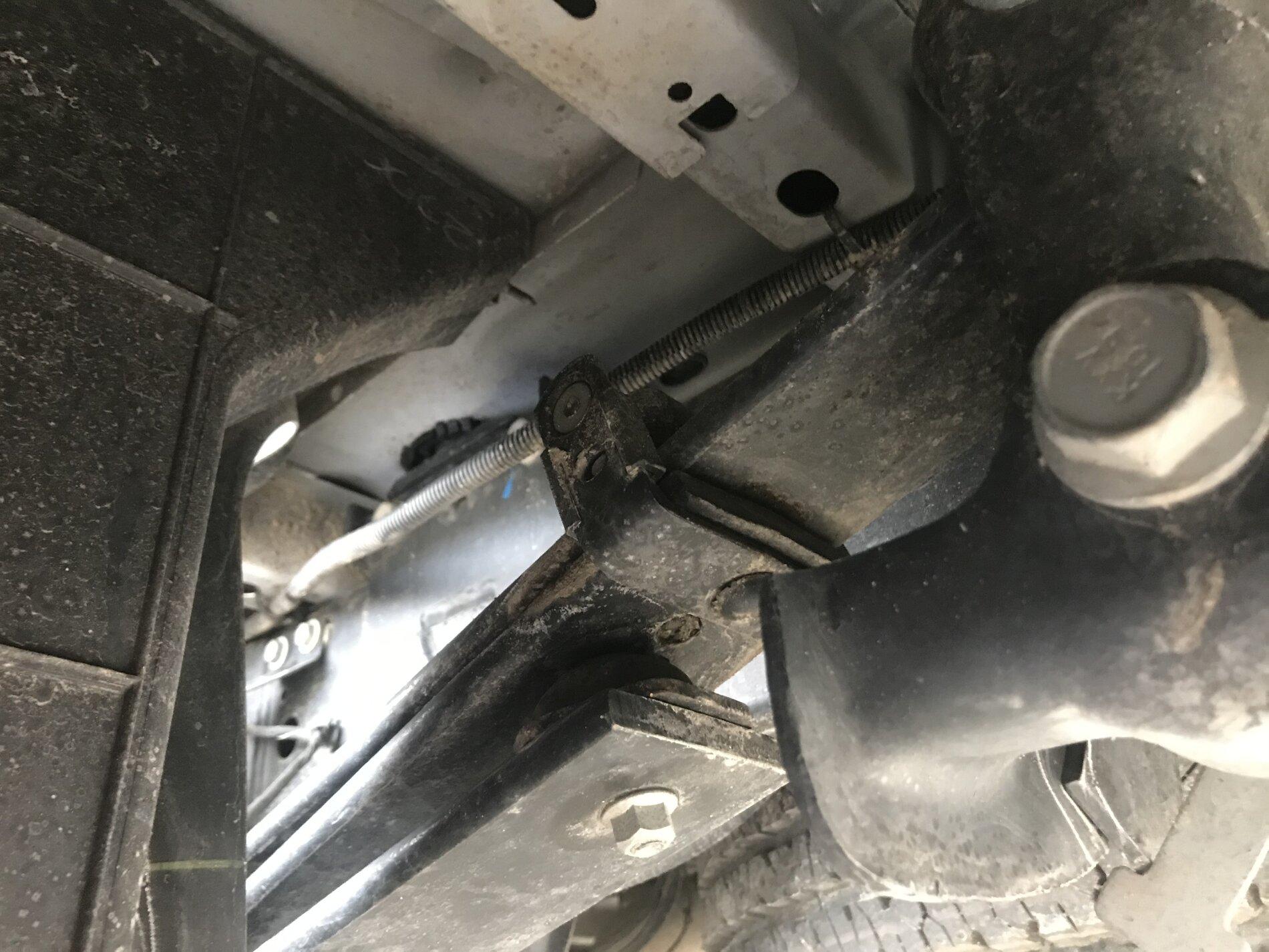

I wouldn’t call it a half spring setup, but rather a softer main leaf setup. That goes away in ALT mode. The overloads are HUGE on the 3500 auto-level, and I’m no more worried about losing an OE bag than an aftermarket bag. In 22 years of using airbags I’ve never had a failure, and only one schrader valve that needed replaced. A sudden air bag pressure loss and the associated body roll would be equally stressful with either suspension.
My truck won’t go into ALT unless I have 500+ lbs of payload. That’s because at minimum bag pressure the truck can’t lower itself below normal height. The springs aren’t that soft, just softer than the standard springs and provide better movement for normal driving. They are much flatter too, which helps with empty driving.
I would be a little more nervous with the 2500 systems as it only rises on air.

It’s hard to get a good photo with the bed installed, but here you can see that all the springs are nearly full length and the mass of the overloads that are use in ALT mode. These overloads provide a safety margin as well as an increase in roll stability.
Photos don’t really do it justice. It’s a very impressive rear suspension.
